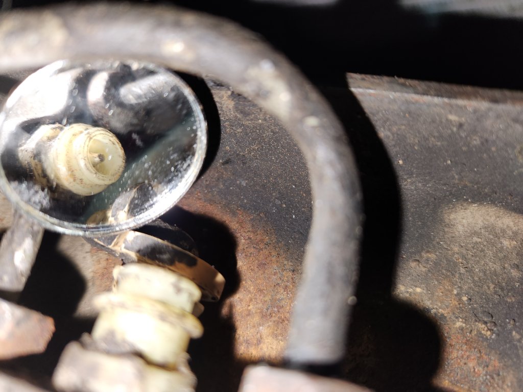

I was out there today having a look around the valve:
Now, i know that normal operating mode a pin sits inside the valve floating above the part of the plunger (piston) that is tapered so its not making any contact. Circuit open, no dummy light.
Now should you lose fluid front or rear, depending, the larger diameter of piston makes contact with the pin, pushing it up to the switch, closing the circuit and triggers the light.
I thought, maybe its stuck up, so with a pick i tried pushing it down but she's stiff, feels like im making contact with something... I took a picture of the pin, (bear with me folks its in the stock position under the rad support, so it a pics through a telescopic mirror that I angled to see)...
But when i was researching this after coming inside before posting here, the pins in the images on the google machine looked just like mine here.

Can any of you speak to the position of my the pin on the prop valve. Is it high, as in triggered, or normal position?

Yeah just stuck my phone with light on down under there. The male end of spade connector has left the chat.
Who knows when probably since before I was the owner lol. I think i can live without it. Never used the parking brake once. Like insaid when I took apart the dash n tried identifying what everything is i just saw this wire and assumed it was a ground. Whoops.
Prop valve is all reconnected. No more light. Crisis averted.
