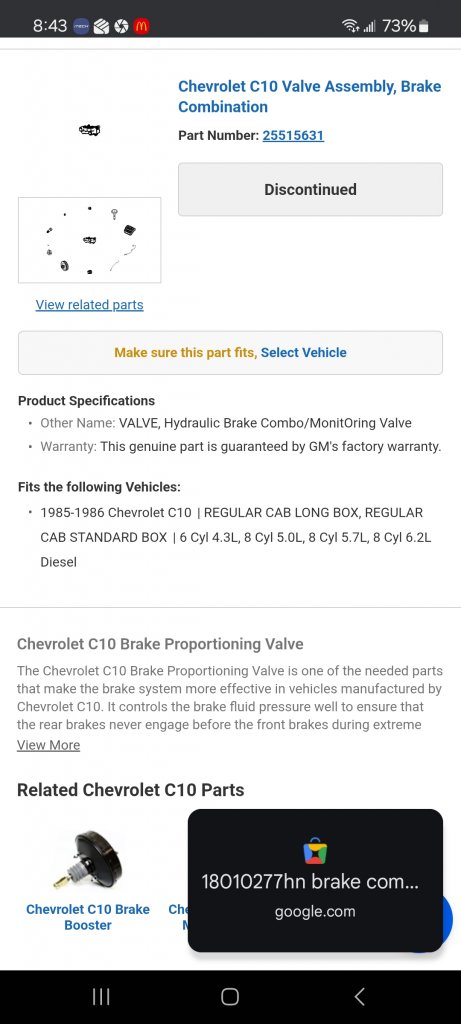

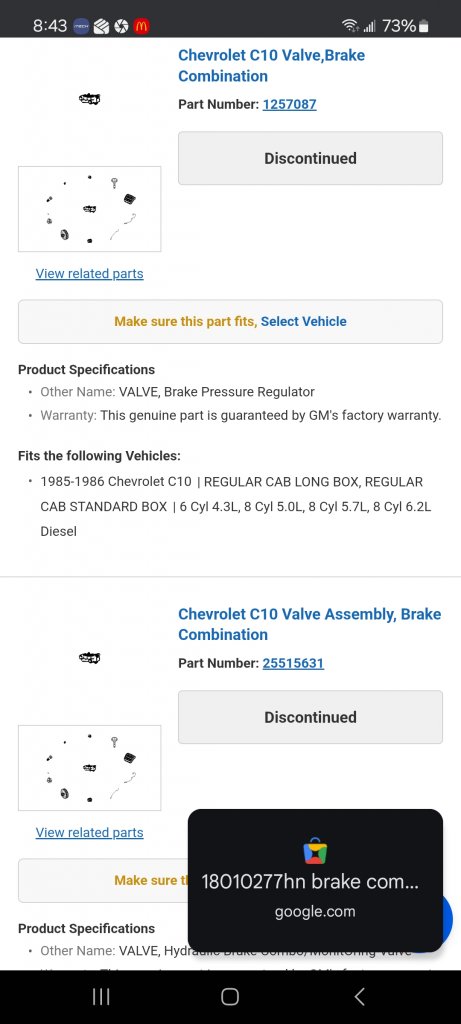

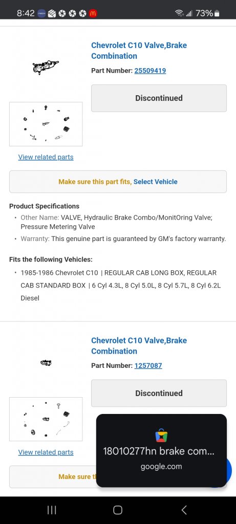

So, breakbooster/master cylinder, then Wilwood adjustable proporportioning block, then same combination valve (has standoff and shuttle), then 10lb residual pressure valve in-line somewhere in-line for rear?
Do I potentially need to change the type of combination valve (PV2 generic, although I specified year, front disc and size 13" of drums)
