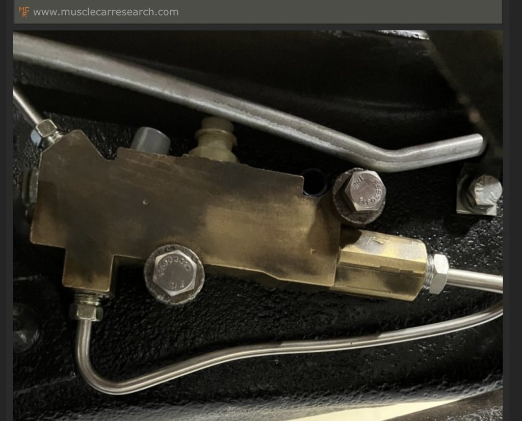

The rear brake line has a larger thread than the two front brake connections on my valve. Not sure about the exact size.
The adjustable manual valves can work great, we always put one on the rear brake line on circle track cars that I could reach down and give it more or less rear brake.. depending on what was needed.

That's good info to know. I'm going to have to replace mine as it's residing on that brace underneath the core support and it's cruddy as hell, about the only part of the truck besides the battery tray. I was looking at Willwood prop valves, so I guess I need one of those too.
Thanks for the pic Bill, that's the one I see everywhere online, but I read they may not be the most reliable.
