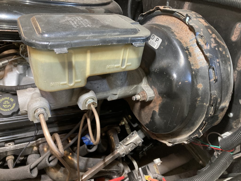

That is it. Exactly the same as the image I posted in comment#34.
I didn't click the google link because it's not your truck, and showing a general pic of a similar MC and not your actual MC or your front discs or your rear drums doesn't tell us anything but what is on someone else's truck. And judging by that pic you just shared, the small line is on the wrong reservoir, as the big reservoir is for the fronts. When we ask for photos of your setup, that's what we need to see. If you're not near your truck, simply say so. If you don't have a camera, say so. If your truck is wanted by the Feds or is in the witness protection program and can't be seen in photos, say so. We're trying to help. We're not getting anywhere with just words from you.
You didn't post that pic on #34 you posted a link to picture on Amazon This is the first pic you've put up,period.There have numerous requests for pics. Pics of the rear shoes assembled,pics of the backs of the calipers,showing bleeder orientation etc. Sorry posting pics is such a problem,and getting an attitude about the ONLY pic you've bothered to post,doesn't really make people want to help you. Take it to a shop,pay someone that knows what they are doing to fix it. I guarantee you I could fix it,without a forumn and zero parts installed that didn't come factory.

It’s unfortunate you’re providing very complete, coherent and fairly knowledgeable input to try to solve your issue and there are a couple select folks responding in some weird accusatory and somewhat off topic or off base manor. Oh well, that’s the internet….
From the info you provided, there is nothing obvious or glaring I’ve seen to cause this.
Couple things I noticed, the MC pic you provided has the front reservoir in front and I think you said you plumbed the front line to the rear position on the MC.
Could also be why I think you mentioned the fronts don’t seem very aggressive. Worth pinching off the rear brake hose or disconnecting and plugging the rear line imo to see if the front brakes are doing real work. (Back to are the lines switched at the MC. With all new hard lines, may have an anomalie or the wrong hard line that only hooks to the wrong port.)

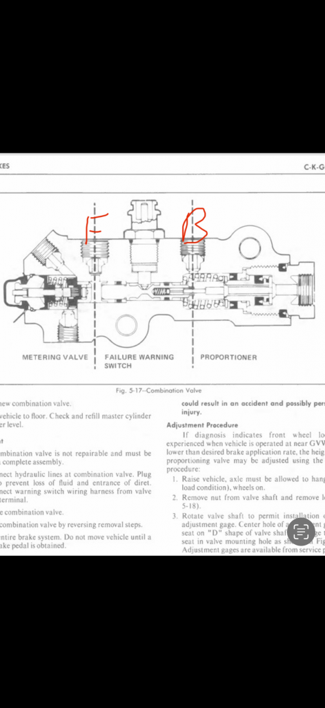

If you are still not sure if you have the front and rear in the right spot, trace them from the MC to the Portioning Valve. If they are correct, I’d say change the PV.
10,167
19,654
I have the rear port of the master, the small line, feeding the front brakes, and the front port of the master feeding the rear brakes. Is that right or do I have it backwards?
Yes you do have it backwards.

Having the lines reversed would explain the difference in volume and pressure that could make those rears lockup and fronts not do much
But id like to point out, that, his answers have been good and complete, but the issue was found only AFTER he posted a photo. Which he wouldnt do. If this fixes his issue, hes probably fine all elsewhere plus the things I mentioned about the filter for the booster
If hes got problems after, he should show us the more components but im glad we finally got to see. at least the MC is right too
