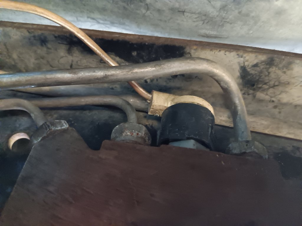

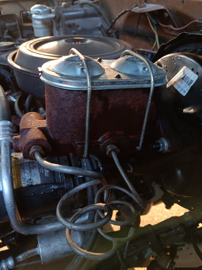

If you are still not sure if you have the front and rear in the right spot, trace them from the MC to the Portioning Valve. If they are correct, I’d say change the PV.
OK - I believe this picture is correct. Now, I would have ASSUMED the rears get a smaller line versus the fronts. That is not the way my 1980 half ton is plumbed and you can not reverse the fittings on the master cylinder- different sizes. I tried and found out. :anitoof:
So - is my stuff mis-plumbed from the General? Assuming the rear chamber is the rear brakes - both appear to be the same displacement. :think:
Color me lost.
Color me lost.
@Goldie Driver; when you have eliminated all the possible, what remains no matter how improbable, must be the truth. So if you traced them from the PV back to the MC, then what you found has to be the truth. I can’t really tell from your pictures how they trace back, but those lines don’t look factory and that master cylinder looks like it belongs on a B17, so; is that the correct master cylinder? Did the PO mangle those lines into place to make them work on the wrong MC?? Hard to tell without more info.
Actually, I was doing a little research on my work computer earlier today so can't link it but found a video of a 78 with the same set up and a you tube video showing that the forward ports on older cars often power the rear brakes.
So , I believe it is factory. Doesn't explain why my issue is the opposite of the POs but it is what it is !

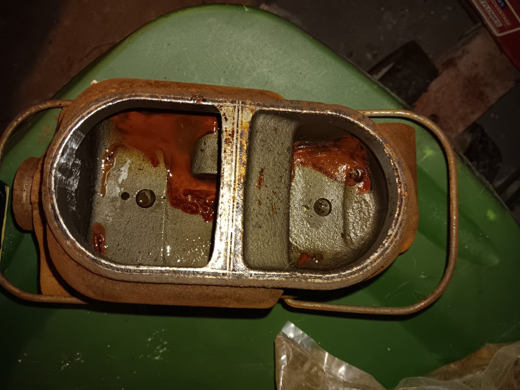

This is for a van, but i cant find your master in the lists in the service manual
Should be obvious looking in the master which is the front and rear, front uses more space. if your fluid isnt clear you can stick your finger in the nasty to feel the iron casting for which one is bigger
Well, here is my old one I saved in a plastic bag in the garage. So much for protection from the Houston humidity...
:eek:
However, it does show the front chamber is smaller. The front is to the right.
I never knew.
:eek:
I never knew.
So I guess just make sure the combination valve, the front circuit is hooked to the rear chamber
Yup.
Large line up front and connected to the right of the spool valve switch.
