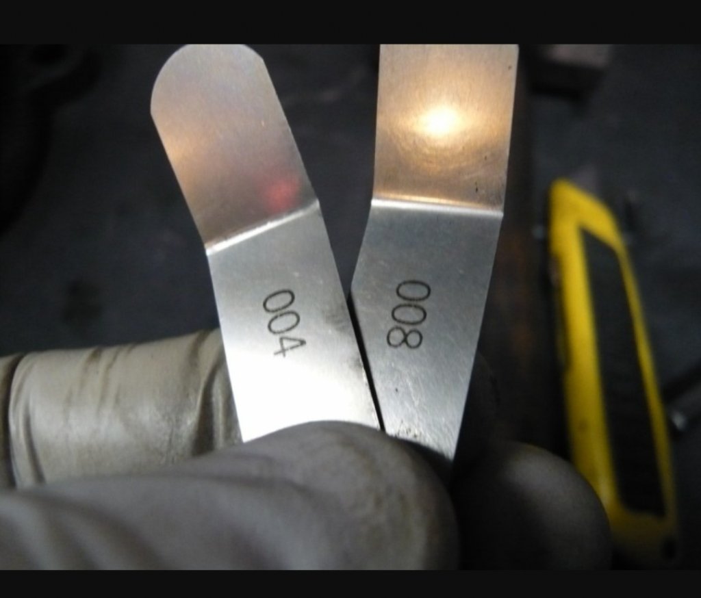

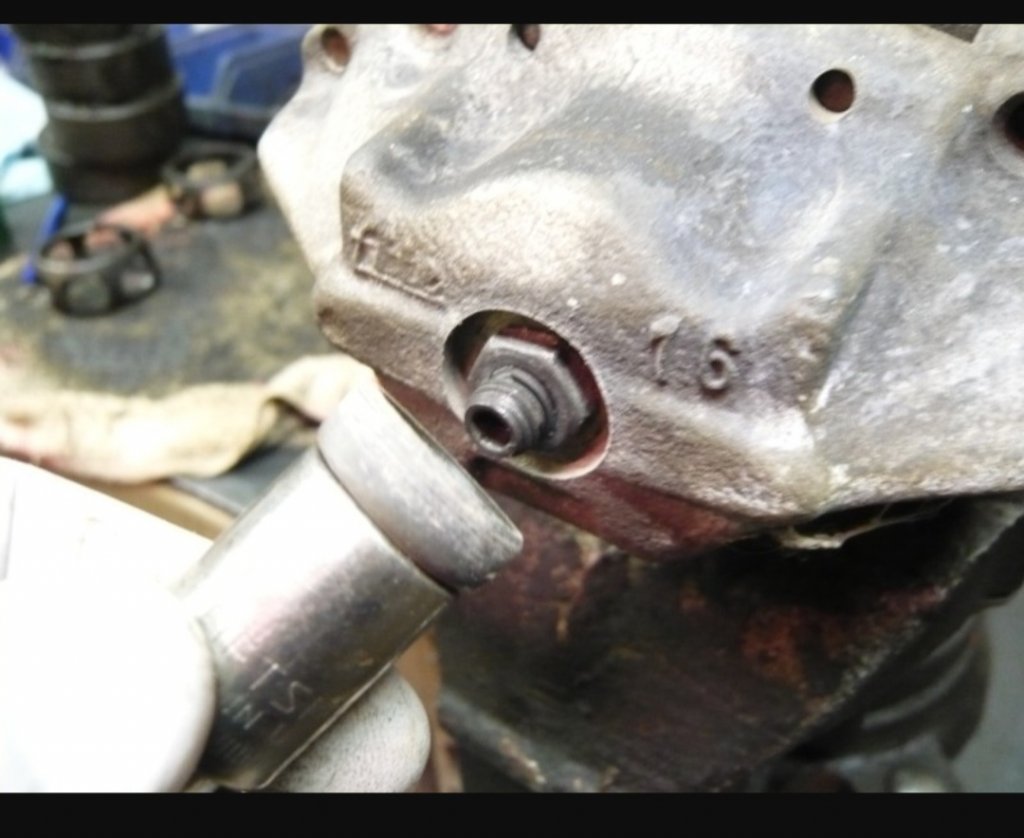

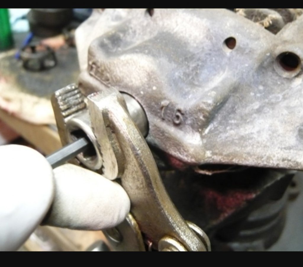

This was a common problem with 914 rear calipers,people didn't realize you had to physically set the depth of the piston with a set screw,or the rear brakes worked like crap. So on initial setup you'd set the calipers to. 004 clearance,I'm wondering if the cadillac calipers are adjusted similarly,thats why they say to pull the arms and mess with that bolt.. The ebrake lever is below that adjuster in red. The original setting was .008 revised to .004 but no matter if you didn't set it the rear brakes were crap.
