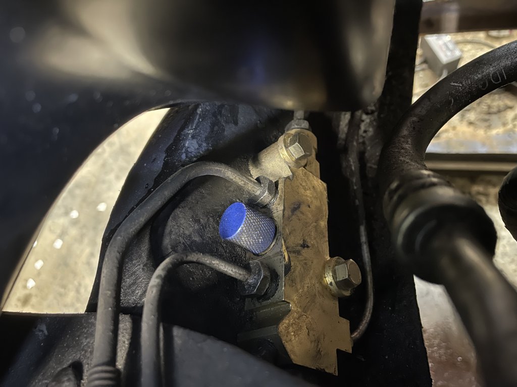

We replaced mine as it was stuck in the "brake save mode" - leaking rear brake cylinders, so I only had front brakes. The other thing to get at the same time is the brake proportioning valve tool to keep it from going into save mode. (Small knurled knob that has a post that threads into the valve). Mine was easier to get at, as I had the inner fenders out then. (81 C20)
