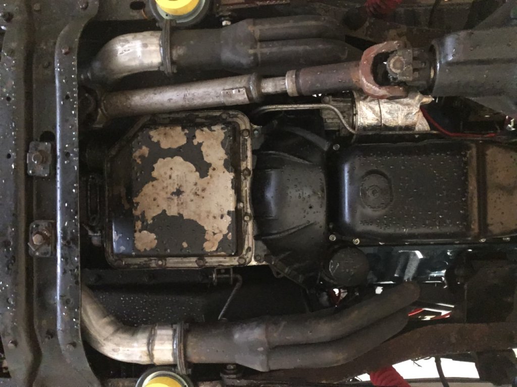

Mine were Patriot #8048 headers on an 82 C10 with a mild 355, meaning Ramjet cam and Vortec heads. The biggest problem was I had to re-route the fuel and brake lines on the passenger side to clear the #2 tube, which required removing the side motor mount. I also had to piece together some mandrel-bent sections of pipe to go up and over (and down and under) the asymmetrical trans cross member.
And that was a fairly easy installation compared to some I've done and read about. At least there was no frame interference, and spark plugs were all accessible, some with only a box end wrench, though. After all the work (and money), I didn't notice any seat-of-the-pants difference over cast iron manifolds with the same 2-1/4" exhaust pipes and DynoMax Super Turbo mufflers.
One more thing: When I rewired the engine, I had to remove the passenger side header to access the starter terminals. So, yes, it's always something!

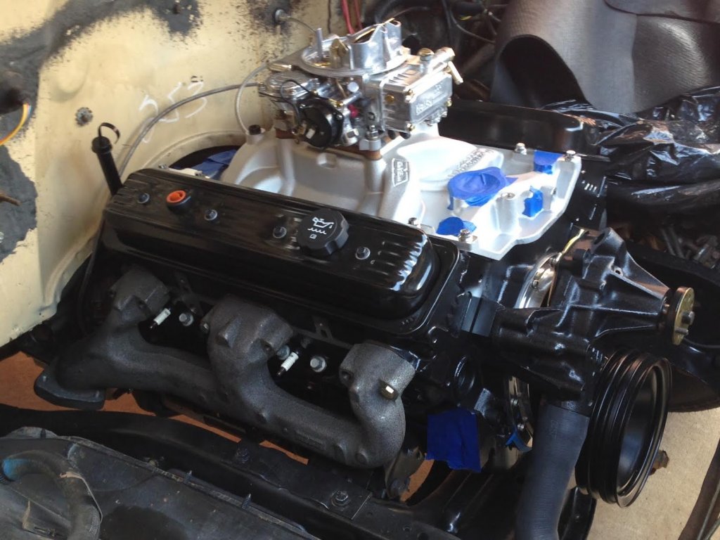

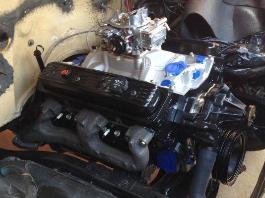

On my mild 355, these manifolds worked just as well as headers, according to my butt dyno. I forget the P/Ns, but I port-matched them to the raised ports on the Vortec heads. I did that with the Patriot headers, too.

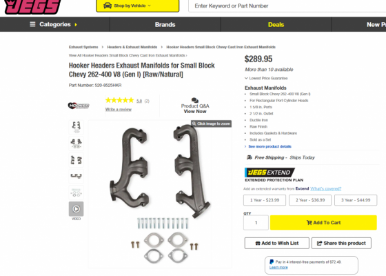

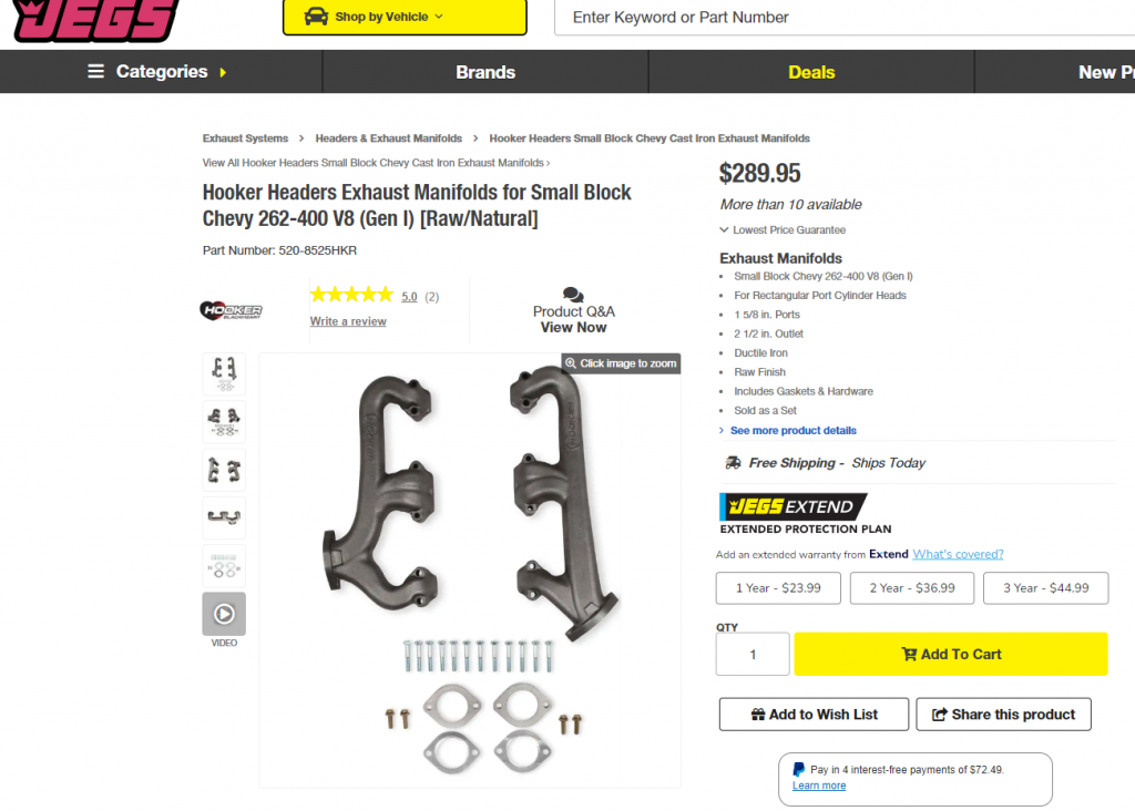

This a race truck? Headers suck big bald baboon balls! Avoid the headache and run good, modern manifolds. Hooker has em. You can thank me later.

What about replacing the exhaust manifold to get rid of the emission tubes? Any suggestions there? Also have a bone stock 350
Hooker is making cast iron manifolds that look pretty good and are supposed to flow a lot better than the stock ones.
I haven't tried any yet but that is what I am leaning toward on my next engine swap.

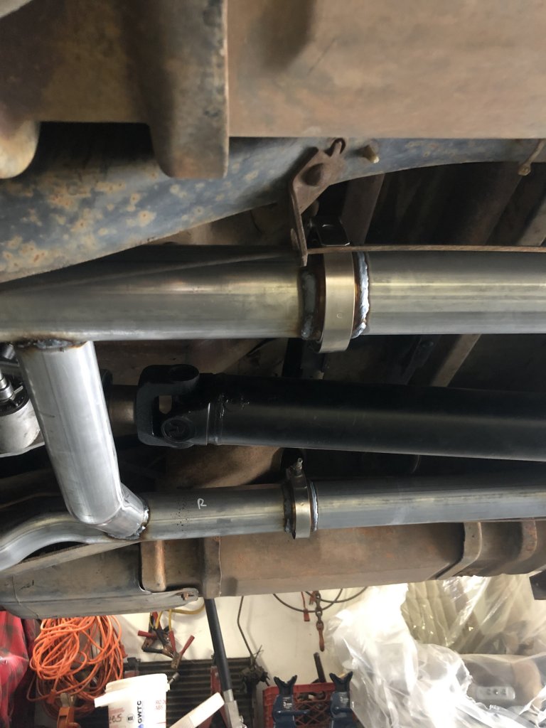

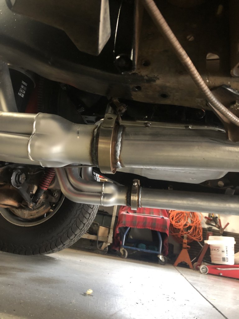

Headers are a nice upgrade, but do buy ones with a 3/8 thick mount flange. I have them on my 82 C20 454, I ordered for direct fitment on my truck & they slide right in from underside with no issues. I also ordered better flange gaskets that I’ve had zero leaks from, also had muffler shop install v-band clamps on my collectors with zero leaks!
