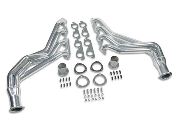

Just ordered a set of Flowtech long tube for a 62 C-10 truck ..
They are not made to fit the 62 truck, made for later models (67-up)
The Oem crossmember has been removed, a four speed is going in ..
Which will require a new crossmember mounted further back in the frame ..
Tejas SteelWorks
Hoping the headers will be a Plug & Play deal ??

Big block long tube headers for a 68-74 Nova are the best fitting when it comes to square bodies, they point straight back vs most headers for a square that point weirdly on the driver side and makes making up an exhaust system a bit of a pain. They sit higher up in the frame rails and still clear the transmission including clutch linkage and won't drag on a lowered truck.

I have used, and currently use Hedman 69110 headers on my '78 K-10 BBC. These are for manual or automatic transmission equipped trucks.
