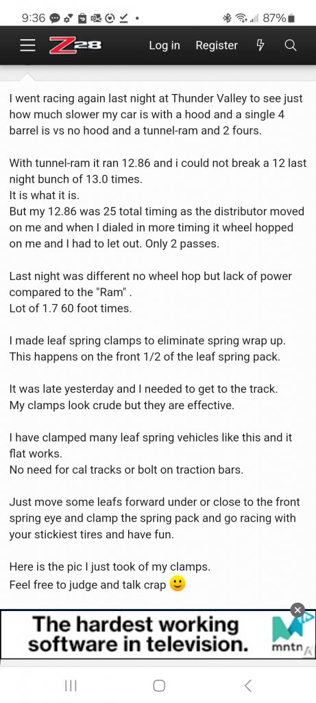

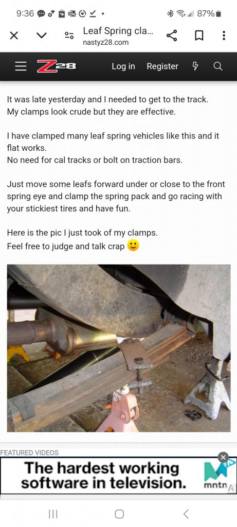

Try curing your wheel hop by clamping the front 1/2 of the spring pack. Also you can clamp a 1/2 leaf on the top . Front 1/2 of the spring is where wheel hop starts try to bind up the front 1/2 so it can't get S shaped on launch . I ran across this little tid bit. Learning about rear suspension instant center on a GM G body, going with explorer rearend.( Its an internet thing, you can be researching best gas chainsaw and you end up on a page for solar powered sawzalls),but it stuck in my mind, and now you can use it. Did my best to get you an example.
