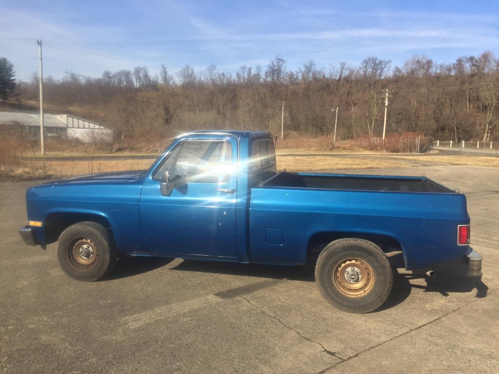

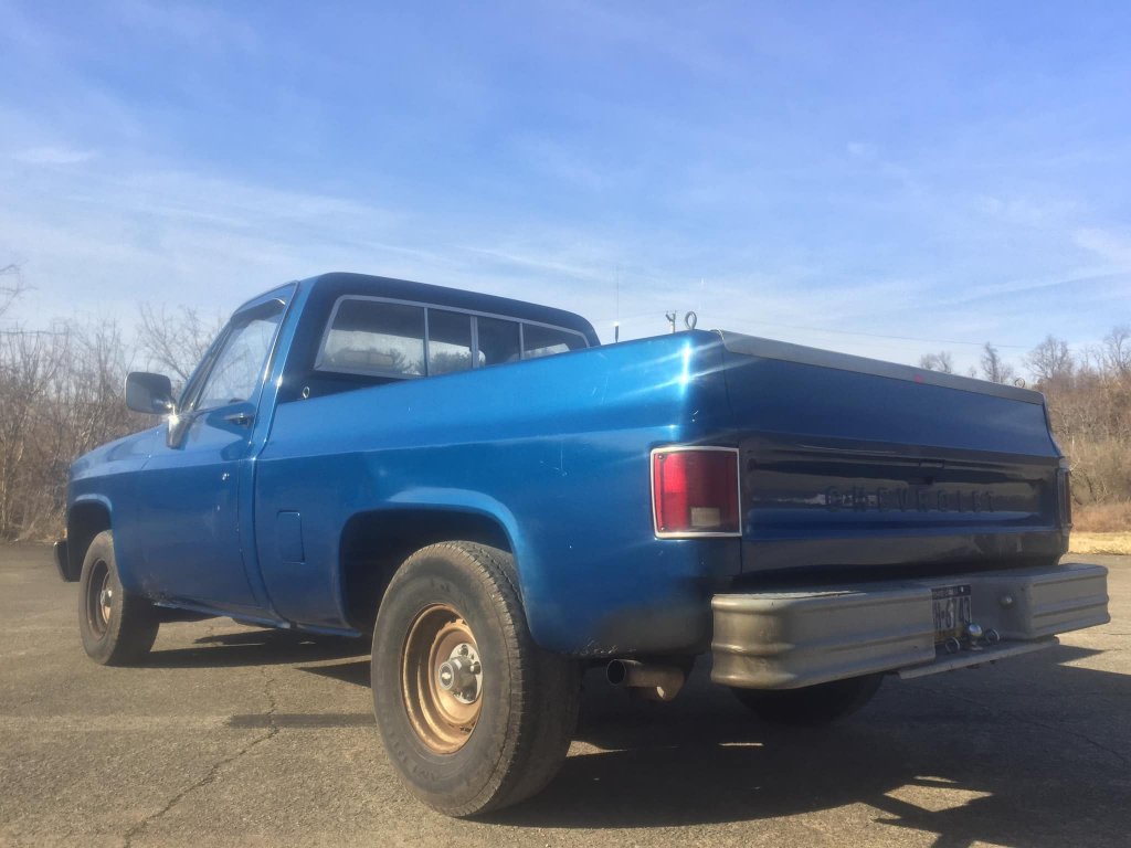

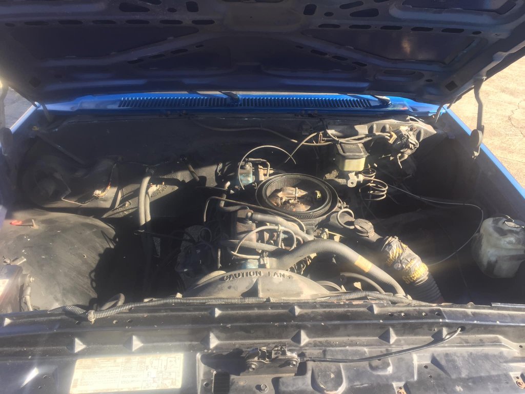

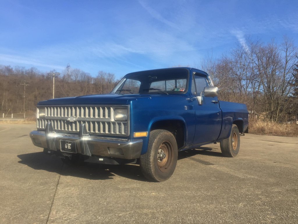

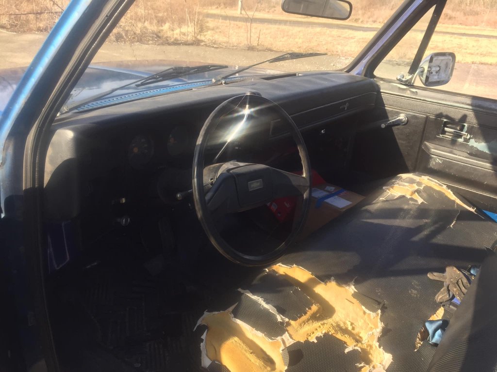

well thats when i first picked it up 8 years ago. inline 6 automatic truck, pretty much base model work truck. absolutely hate the 81 grill and plan to change that. i got all the parts to convert the truck to manual as if it was that way from the factory from a friend who was stripping like 77 dump truck for parts. it has the proper steering column for a manual that i rebuilt. OEM original pedal box and pedals for a manual that i modified the clutch pedal to be used with a hydraulic master from an 87 C10. i located the proper spot in the firewall on a truck in the junkyard to install the master in the OEM correct location.
im a german car guy hence the user name so i plan to use some stuff from the german car world. one thing i plan on putting in the truck is these blue recaro seats that came out of a limited edition VW jetta in 1989. also got a center console from a K15 blazer that im going to try to retrofit in between the seats.

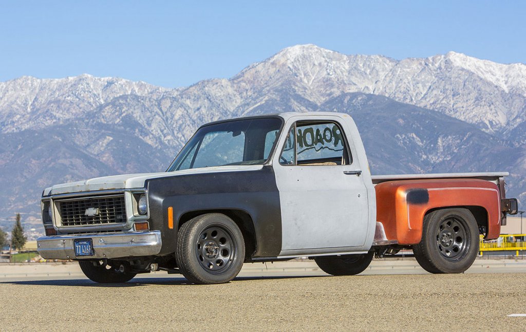

Part of my inspiration is roadkill's muscle truck. yes i want to swap the front end to a 70's front end. if my truck runs anything like freiburger's truck does i'll be happy with it. i know his truck had an LS6 in it but thats a 5.7, mines bigger hence 6.0L power lol.
