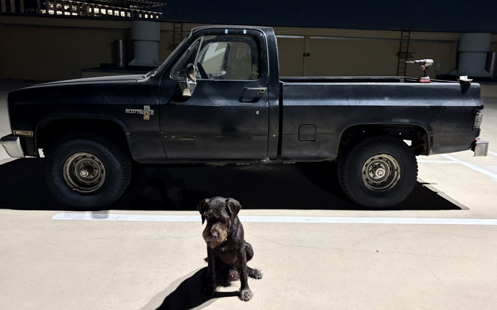

I here is a photo of the truck and my dawg

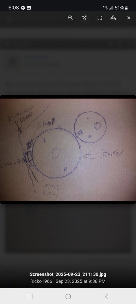

200% agree with shorty.

I used a newer smaller starter from a vortec motor and added a ford solenoid on the fender by the battery. It fixed my issues with the starter and headers. A heat shield wouldn't be a bad idea either but I had issues fitting anything between the starter and headers.
