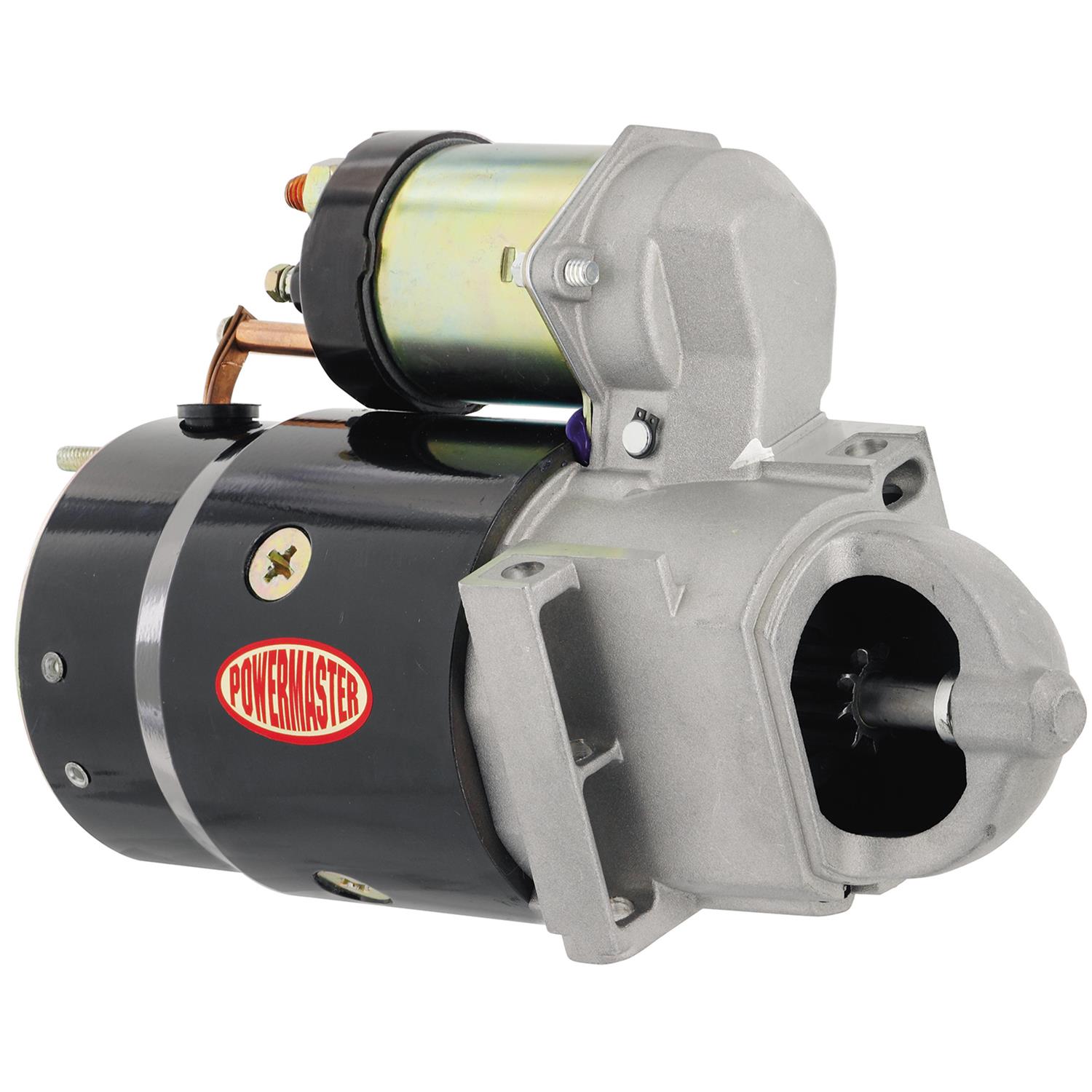

I'm running an 02 roller block and a 168 tooth flexplate with this Power Master starter and I haven't noticed anything odd so dimensionally the ends must be the same just the body changed.
