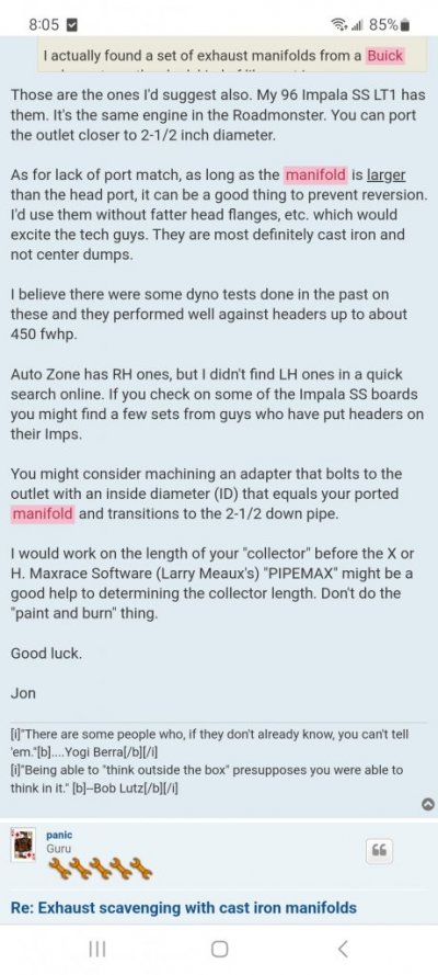

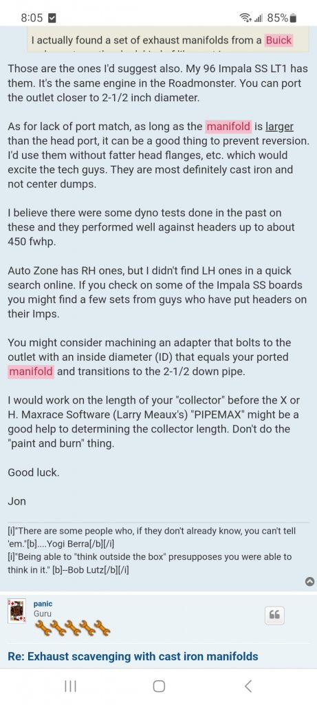

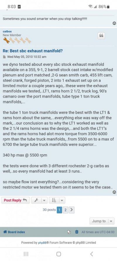

The 2.5 inch rams horns are similar to headers in lower horsepower stuff. Unfortunately those are Corvette and straight flange instead of angled,like you need on a truck.And those aren't 2 inch. I would be really interested to see if lt1 roadmaster/Impala manifolds would work on a Square. Hey @Catbox is this first screenshot you?
That is not a post by me.

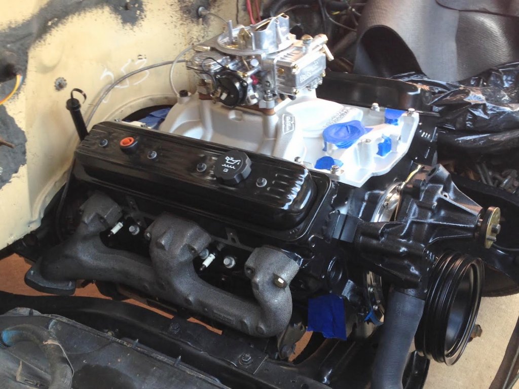

I tried a pair of aftermarket 2.5" rams horns that dumped straight down. I couldn't see any way to make them clear the drivers side motor mount. However I did see a photo where somebody did it using a very tight pipe bend and some grinding on the manifold flange and/or the motor mount clam shell. The 2" rams horns are smaller in that area, so might work w/o using a very tight bend. But I doubt they flow any better than these that I mentioned earlier. https://www.gmsquarebody.com/attachments/1698077759431-jpeg.325061/
I just now remembered these were listed for 96-up trucks with Vortec heads. Those engines had 255 net horsepower, which would probably equate to at least 300 gross hp at the flywheel, which is how engines were rated until the early 1970s. Stands to reason they would have been somewhat improved over the square body 350 manifolds.
