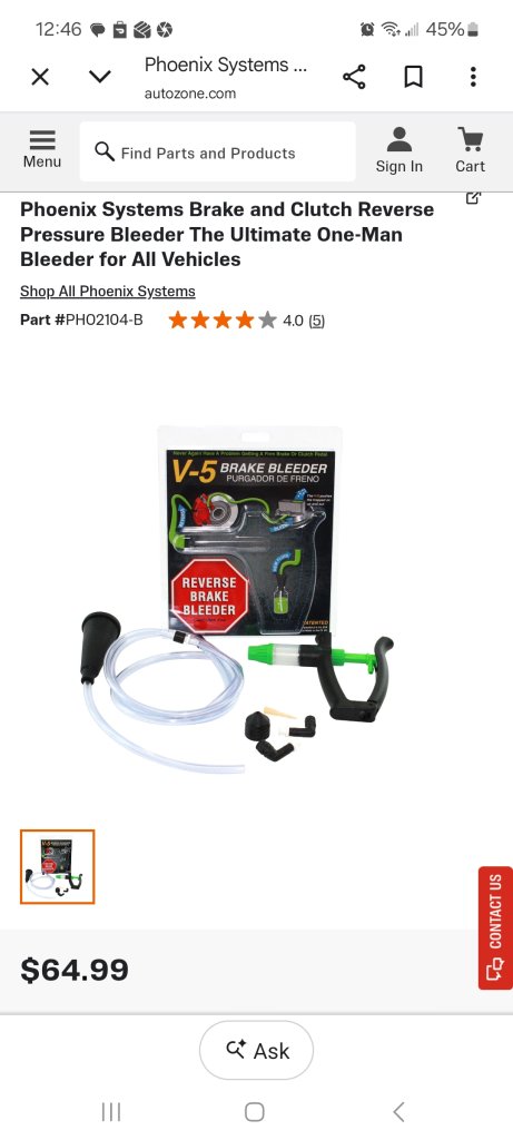

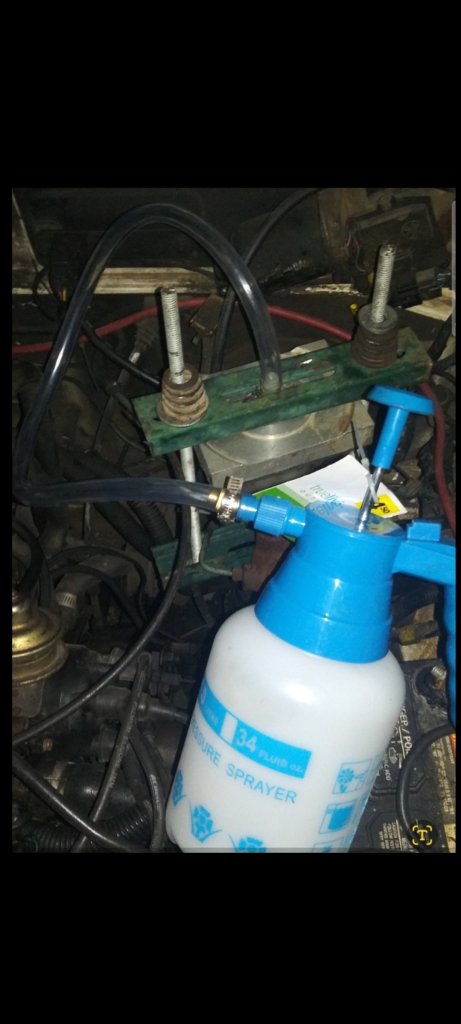

I have a Snap On one I bought 40? years ago made a more modern one a few years ago cheap. I've also bleed clutch slaves 1 man by attaching a vaccum hose to the bleeder nipple and hooking it to the intake manifold. Start the truck, let it idle, crack the bleeder. When the idle changes its getting fluid. Tighten the bleeder and move on. Have often thought of buying a spool of nylon tubing , put short rubber couplers on each end and having the world's most bad ass vacuum bleeder. I prefer 2 man to pressure bleeder, if I have I helper available. One time deal I'd 2 man them. Build a cheap one man bleeder copying a performance tool one man bleeder, or vacuum bleed them. I'll post a link to a homemade 1 man and tell you how to improve it, if you decide to build it.
