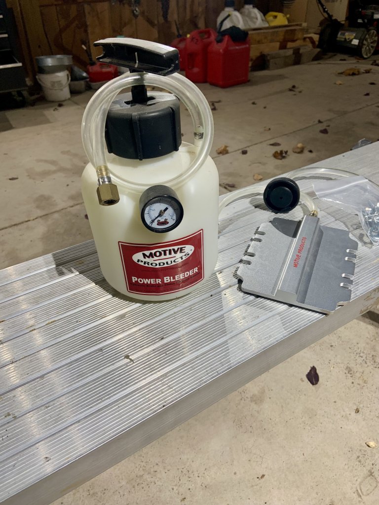

I used the Motive power bleeder on my BMW and it worked really well. I had to get the version with a cap that screwed onto the BMW brake reservoir, but other than that it was very simple. Just add brake fluid to the container and pressurize it, and then crack the bleeder at each wheel.
Motive has a universal version of the brake reservoir cap adapter that should work with my 1975 GM master cylinder.
