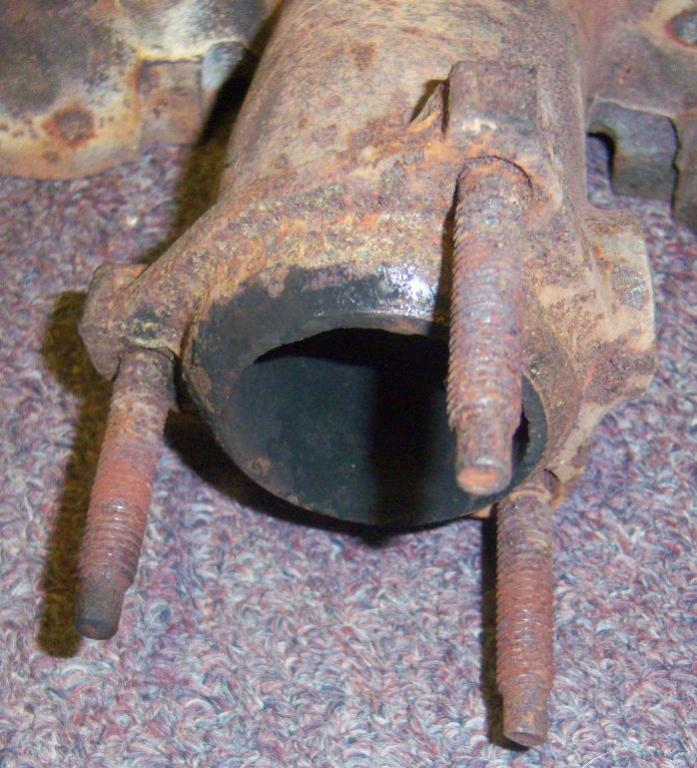

One of three exhaust studs holding on the collecter broke on the left side, It sheared off in the threads. Any suggestions on what I could possibly do now?

Yea the three that stick out of the bottom, It broke off inside the hole. Probibly no way to get it out without a drill huh....

Hate when that happens. Unless your very careful, and lucky, you're likely going to end up drilling it out and tapping if for a new stud. I've been here twice in my life and had to drill and tap both times.

If the stud hole looks like it will pass all the way through the manifold flange, I have drilled them all the way through and just used a high-grade 1/4" or 3/8" bolt (one about 4-6" long). Kinda a pain in the ass to get tight but not as bad as trying to tap it out in place, or taking it off to tap it out.

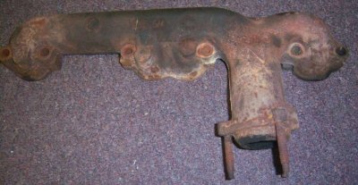

It will bolt on the head, but proably dump in a differant location which means exhaust shop work. You ever get to OKC, or know anyone who comes this way? I have some 305 exhaust manifolds you can have. I do believe the studs are still in good shape. They are off a truck I bought with a couple rods thru the block and pan. I sold the heads and kept all the good parts for those who need them.
47,210
9,482
OH hell, I got you confused with the guys from Easten OK. Sorry. But, if shipping is reasonable for you, take a pic of yours, I'll take a pic of mine, we'll compare the 2 and I'll ship one too you if shipping is reasonable enough for you to cover.
47,210
9,482

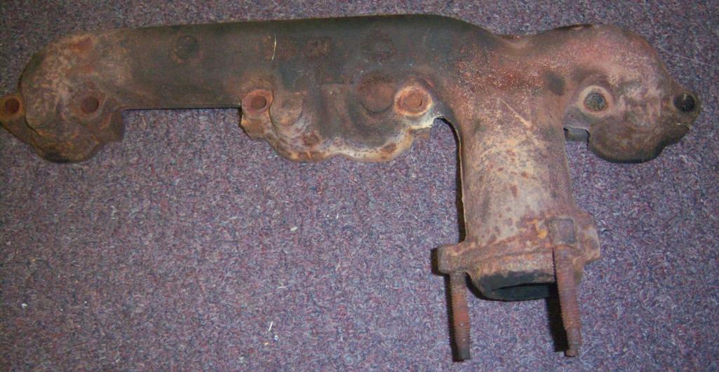

I went out to the shed, and I do still have the driver side. I assume that is what you meant when you said left side. I also have the passenger side too. I brough it in for pics. This is it. The threads look good but rusty of course. I can run a die over the threads to clean them up and make sure its all good before shipping if you want. No cracks, appears to be fully functional. I'd be sure to use brass nuts when putting this back together. That helps tremendously when you don't want to break threads if you weren't aware. The brass is much softer, and will just strip out and come loose rather than seize to the stud then you break the stud. It should be the law in the auto world and for new cars too, to always use brass nuts on exhaust, egr and smog tubes.

This manifold is off an 81 with 305,Auto trans and AC, so I'd think if anything would be differant, it would probably be that your 85 might have AIR (Air Injection Reactor) aka Smog Pump holes tapped in it, and this one does not although the bosses are there, just were never tapped. You should be able to tell pretty quick by the pics if its the one or not. Also might check the condition of your passenger side too. I have both, and being UPS, I doubt its that much more to send the second one if shipped in the same box. I know it won't be double the cost, maybe $10 more or so.
