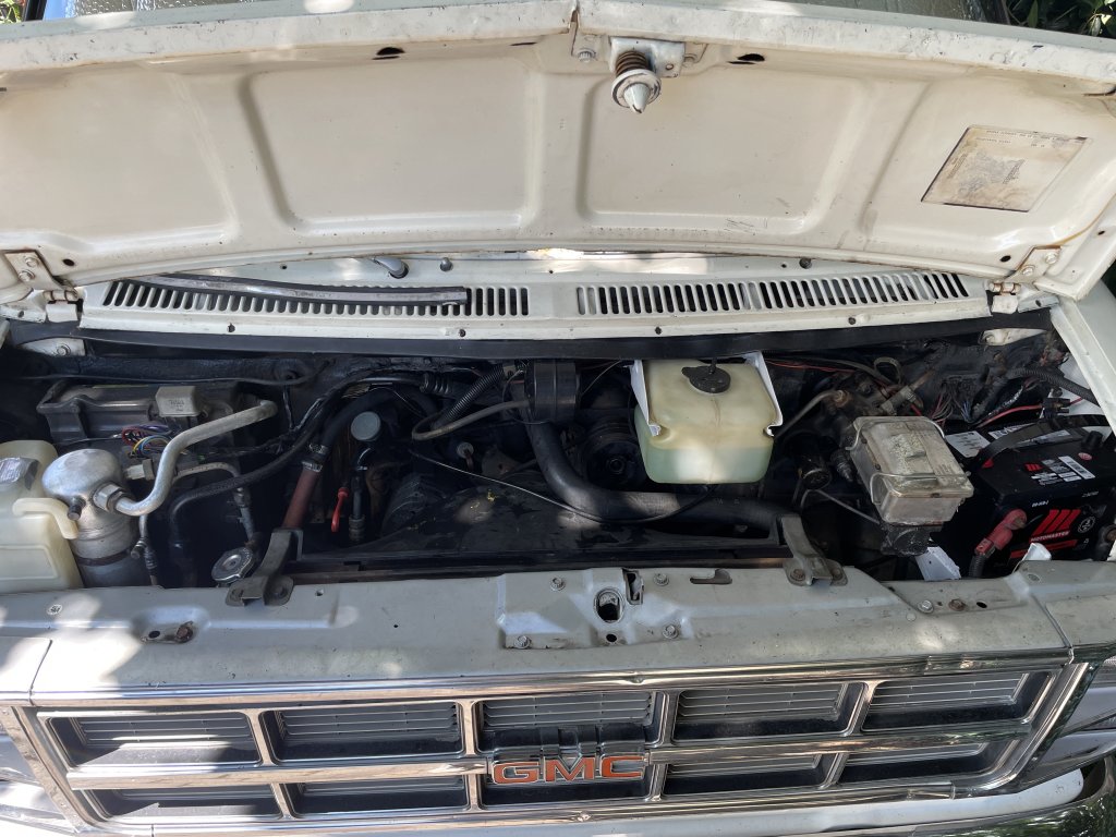

It's been a while for me but I can't see the entire front end coming out to change the alt.
I’ll attach some photos of the engine bay when I get home. The engine is pushed back pretty far. I’d say only about 10% of the engine is accessible from the outside.

I've never worked on a van or motor home, so it was a shot in the dark. Still don't see the front end needing to come off. Yes, it opens things up, but it doesn't seem necessary. I know the engineers have stupid designs sometimes.
Let's see some pics of the engine bay

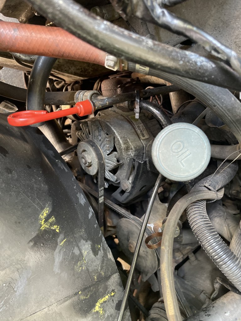

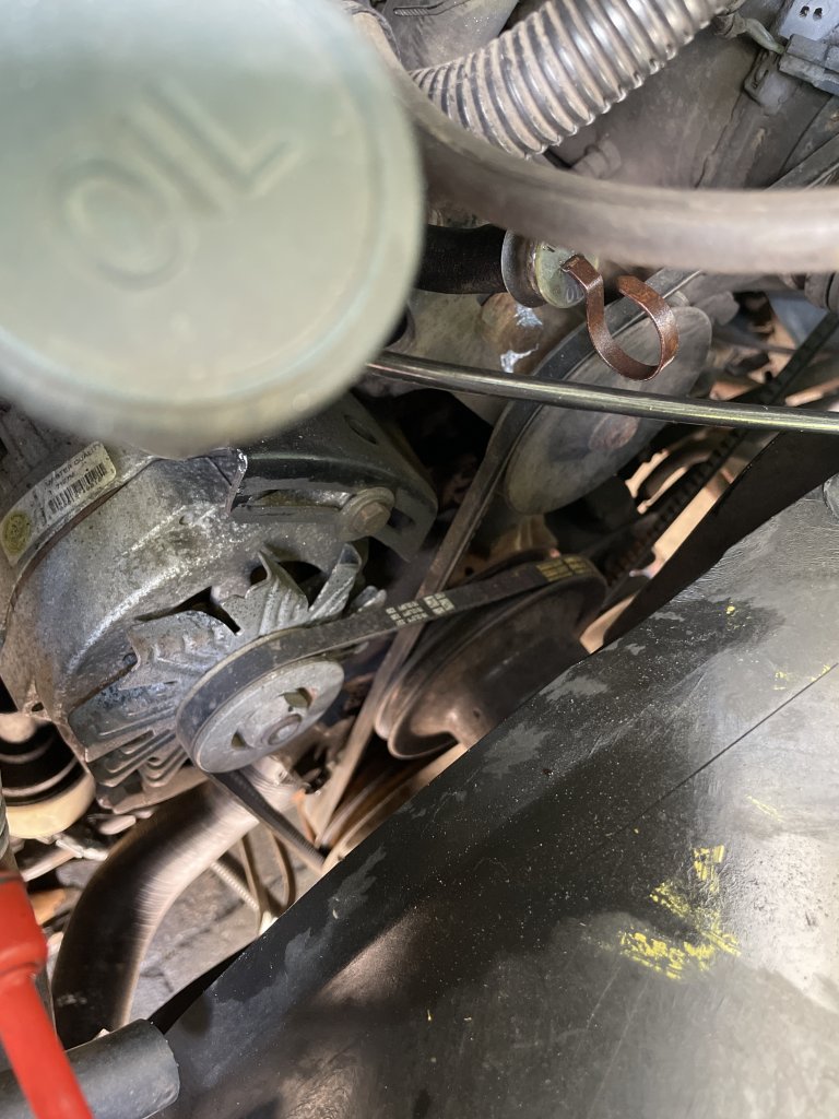

Here’s a look at the front of the engine bay
