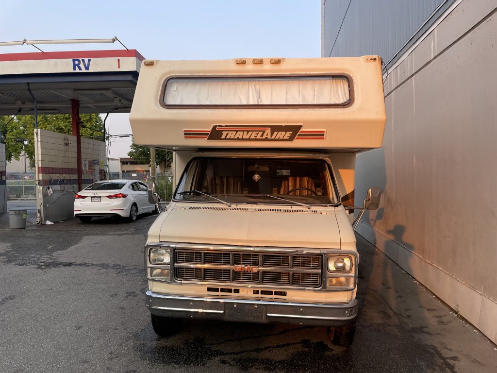

Hi everyone!
Exciting news! Firstly I wanted to thank everyone for their tips/ help. As for the vehicle: Once about 7.5L of fluid was added the transmission went back into gear. As for the power issue the findings were: break light switch wasn’t attached to the bracket and was keeping the lights on. Alternator was replaced just to make sure, now power issues have almost been sorted.
First drive was to the car wash and felt. Transmission is smoother than my current daily driver. Up a steep hill flooring it gave me about 40 kms/hr (max). The was went pretty great, but the previous owner beat up the paint/ window seals pretty good. (There’s silicone, and rust spots everywhere.)
There’s still so much TLC this GMC needs, and deserves. But I will be doing more updating as they come.
8 months ago I started this project, and if you want to watch the process I documented the process since the beginning and you can watch it here:
I’ve attached some photos of the truck after the car wash below.
Again thank you all for the tips.. glad I didn’t have to take the front end off lol!

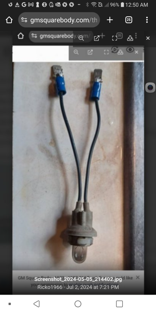

Take a blown blade-type fuse and solder a 194 (dash light) to the terminals.
With the battery hooked up, and ignition OFF, pull each fuse one-by one and replace it
with your new tester.
If the bulb glows; even slightly, you've found the circuit that is causing you parasitic draw.
If it doesn't glow, you're good. Move to the next fuse.
Like this, this has been my go to for years. But first step clean all battery terminals and battery cable connections,charge the battery and load test it. Crude load test would be fully charged battery , turn on all the lights radio and heater motor ,
with a volt meter attached to battery see if battery voltage drops below 10 volts in 10 seconds. If it passes pull the negative battery cable clip a test light to the negative battery post,hook the other end to the disconnected cable if the light is on disconnect the alternator wires. Is the light out? Replace the alternator. If the light didn't go out start pulling fuses with the test light still attached until you find the fuse that puts out the light.Reattch your battery cable. Now just like snoots said put the 194 bulb in place of the fuse and disconnect everything on that fuse circuit one at a time, the one that turns the light off is your problem.
