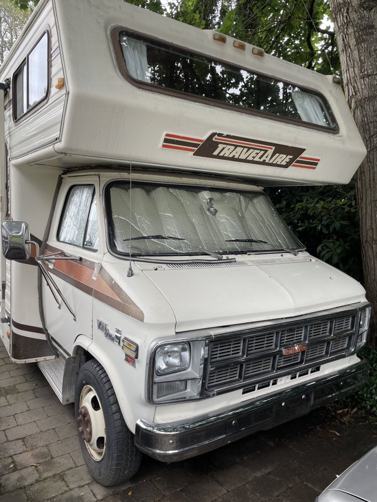

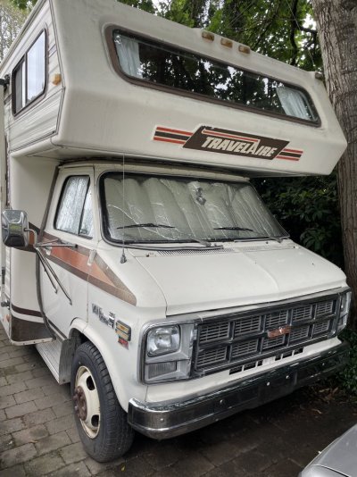

Also added a pic of the exterior. Going to do some touch up painting/ rust repair later in the summer.
