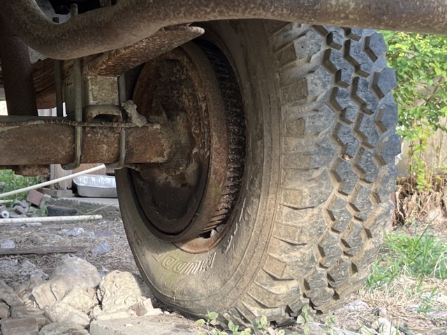

This is all I have on my phone. lol I took it when I was trying to get info on springs/ brakes. Does 8 springs mean the camper package? lol
I’m not sure if it was whoever installed the lift block, but they inverted square U bolts when doing a flip kit. I’d look really good at that whole situation back there.
I wouldn't even have known. Thanks for letting me know.
