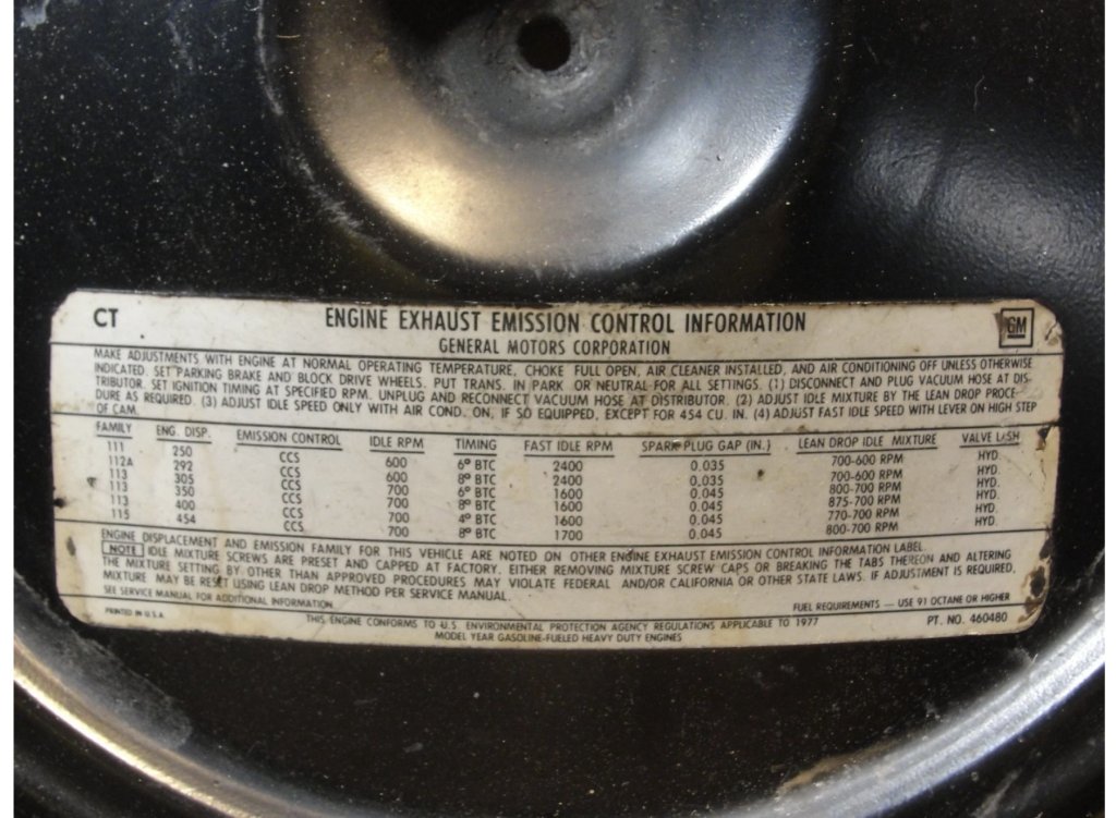

After a little digging around today, I ended up finding these two emission solutions stickers, one for a 76 and one for a 77.

Wow. Your research has been more fruitful than mine has. I think that is the first HD 1976 HD emissions label I've seen. I put the image of the 1976 label into ChatGPT and am using it to generate new artwork so I can have custom labels made. I need to get the actual dimensions of the label to get the size right. Once I have that, I'll see if I can have one made in the right material. That'll be a nice touch to top off the engine compartment.
I also just learned my truck was manufactured at the Fremont, CA facility, so that is neat.

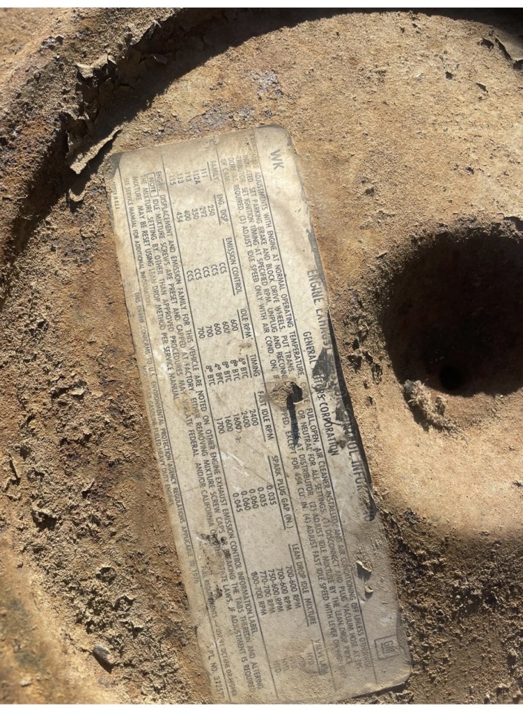

Mine came out of Fremont too, three years later but spec'd CA emissions. It's a big block camper special but it's label is on the radiator cover. Somewhere I have a picture of it and can go get dimensions off it if you think it will help you.
That would be great if you could take a pic.

It's not picture quality, it really is that ratty looking. Good thing I'm out of the emissions area.

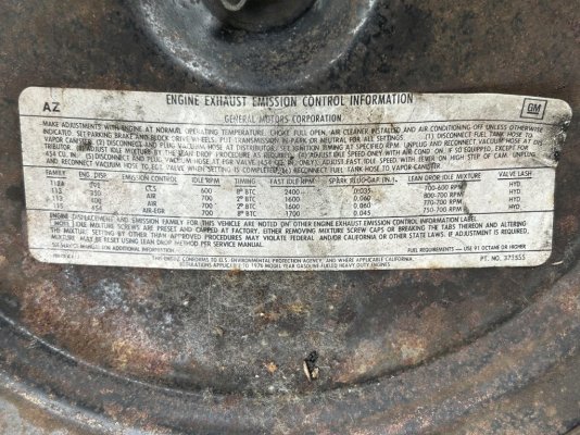

Thanks for that. I think I have found one that will work. It is the "AZ" code. It seems to check all the boxes:
* 1976
* Heavy Duty
* California Compliant
* Includes the 400 engine (Family #113)
* Indicates "AIR" for Emission Control, which is consistent with CA/HD emissions.
I've sent emails to Jim Osborne Reproductions and ECS Automotive Concepts to see if I can get a reproduction made. Hopefully at least one of them can do it.
