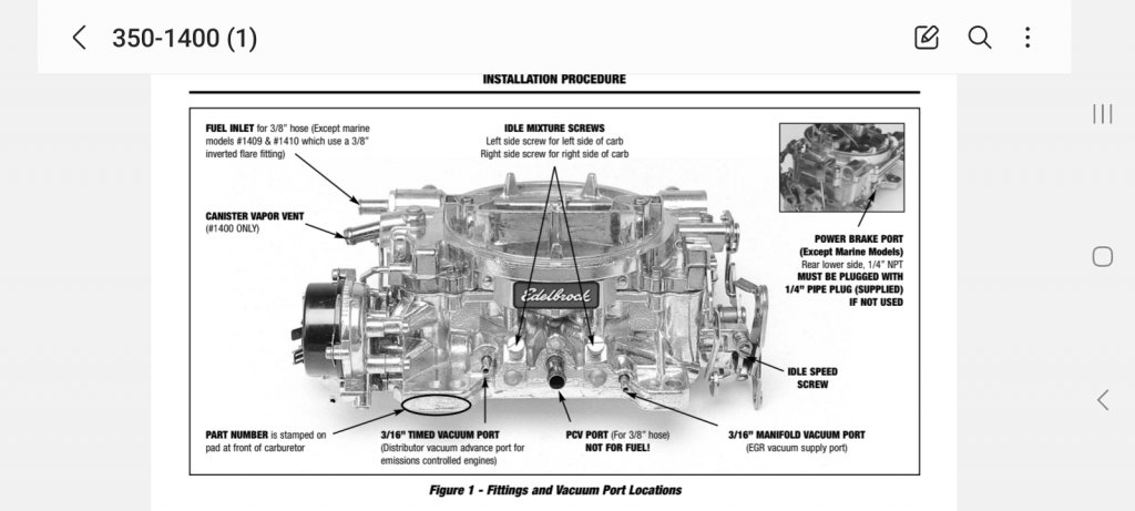

Edelbrock 1400 bottom right port,according to jegs.
