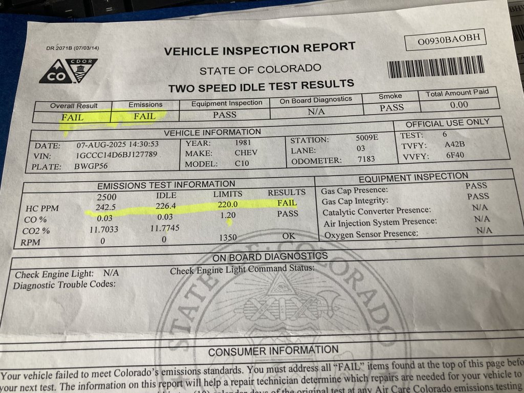

Too high Hydrocarbon on emission tests-Help

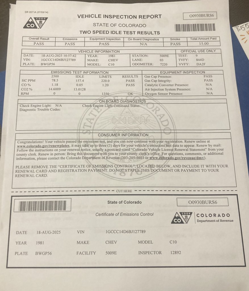

I dialed in another 10 deg of advance, and it runs better than ever.
