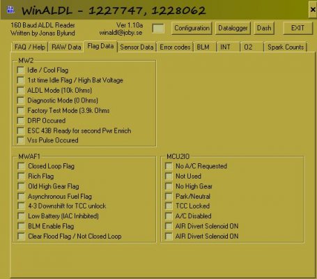

there is a sender for your gauge and a sender for the TBI computer. Without the data log, it is a guess.
Another overlooked idle issue is gear selection. There is a primitive plastic tab at the base of the steering column. when you shift into gear. it slides a switch to tell the computer. It adds ~25 IAC (maybe 25RPM i forget) to compensate for convertor drag. If it is broke, the engine might think it is in gear and always adding RPM.

Do you have to check boxes to get the flag data? I was going to connect with winaldl to start, then maybe move to tunerpro.

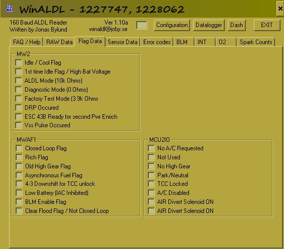

When the data is live, the box will check itself if the flag is active.
Example, once the o2 sensor warms and gets a reading, the closed loop flag should check indicating you are in closed loop. If you are not getting into closed loop the ECM is running off a preprogrammed fueling and timing table. You need closed loop for the computer to make any changes. Many TBI issues come from not getting into a closed loop. You 100% need a heated o2 sensor. without it, the sender will constantly go open loop and default to bassline program.
If you need help, reply, or PM me your phone number. Once you get the TBI jargon, it is amazingly simple and bullet proof
the gear selector will check uncheck as you go from park to drive

Tunerpro RT can also show you the flags as well as the data stream, as long as you have the right ADS or ADX file. On mine I can see when the gear select goes from PARK-NEUTRAL to DRIVE (I don't think it knows which gear you are in, just that you are in a gear). It also shows when I'm in open or closed loop - but there is a second IDLE CLOSED LOOP thing which I am not sure what that is.
I am pretty convinced my PROM is written with a 950-1000 target idle. The IAC will always open and close to set that speed no matter what is going on. I don't like how hard that is on the transmission though.
