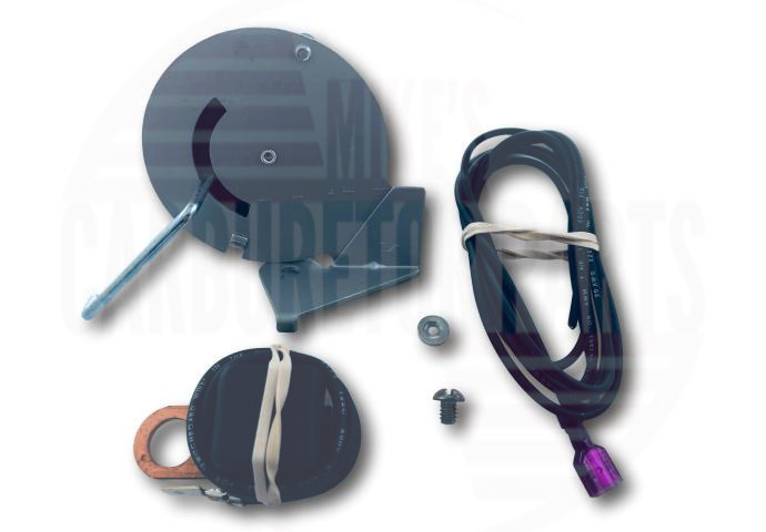

Choke: Since the Qjet 4MV carb has a divorced choke (and I don't have the choke) I am going to try one of these out;
