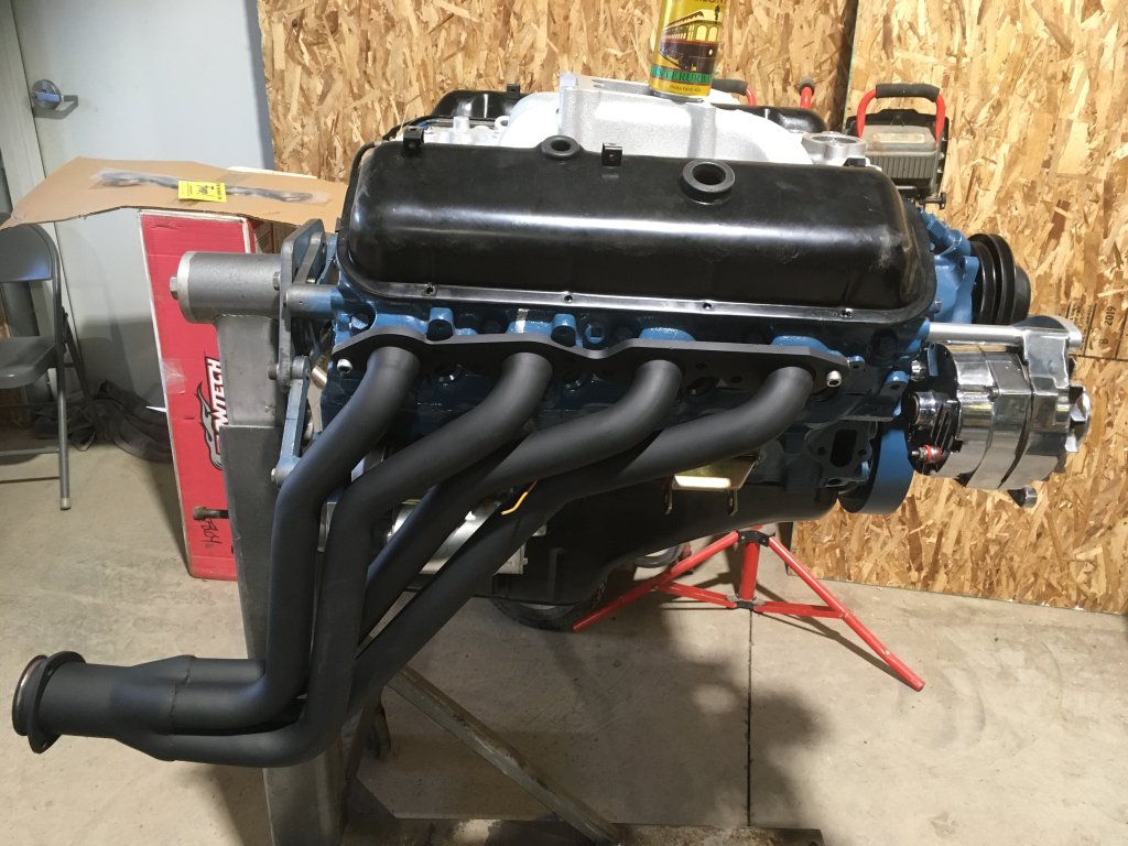

Hey Brian, Welcome to the best forum for squares. I have messed with the 502 in a friends 71 Moute Carlo. loved that engine. IF....you get the block, I would STILL check the bottom tolerances, crank end play, use some plactigauge (.001-.003) the green one, to reaffirm that the mains and rods have the proper clearances. If you want to run the flat tappit cam, keep each lifter on the original lobe, and CHECK EACH ONE!!! and scoring, bad bad bad. Get every part the dude has, everything is expensive to buy new. The bottom end is four bolt, crank is forged has a wide forging line VS the narrow line on a cast crank. Cast cranks are still very strong, I used one in mt 489 build Here: https://www.gmsquarebody.com/threads/bbc-489-build.45389/
Pay attention to the small stuff, deburring, holes clean, tolerances. I am a machinist, and finished my career working on engines. That doesn't make me any better than anyoun else building an engine, except I know what to look for. Sounds like you are no stranger to BBC, however you mentioned a 750 Holly... had on on my 454, great, but may be limited on the 502. Chevelle headers will work on your setup, but the original cast exhaust arn't terrable. I always run headers....just my preference, and you can use them to your advantage to move the RPM around, add torque, (read smaller tubes, and long tubes.) You will need a stout trans, not sure which one you have. We all appreciate you being here, and some really smart guys have chimed in, were here to assist!

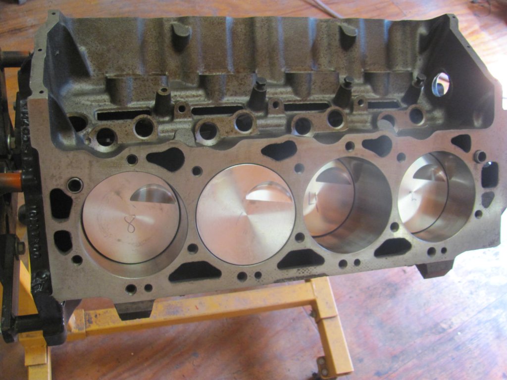

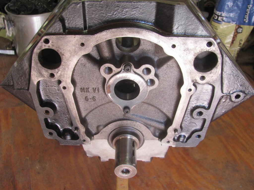

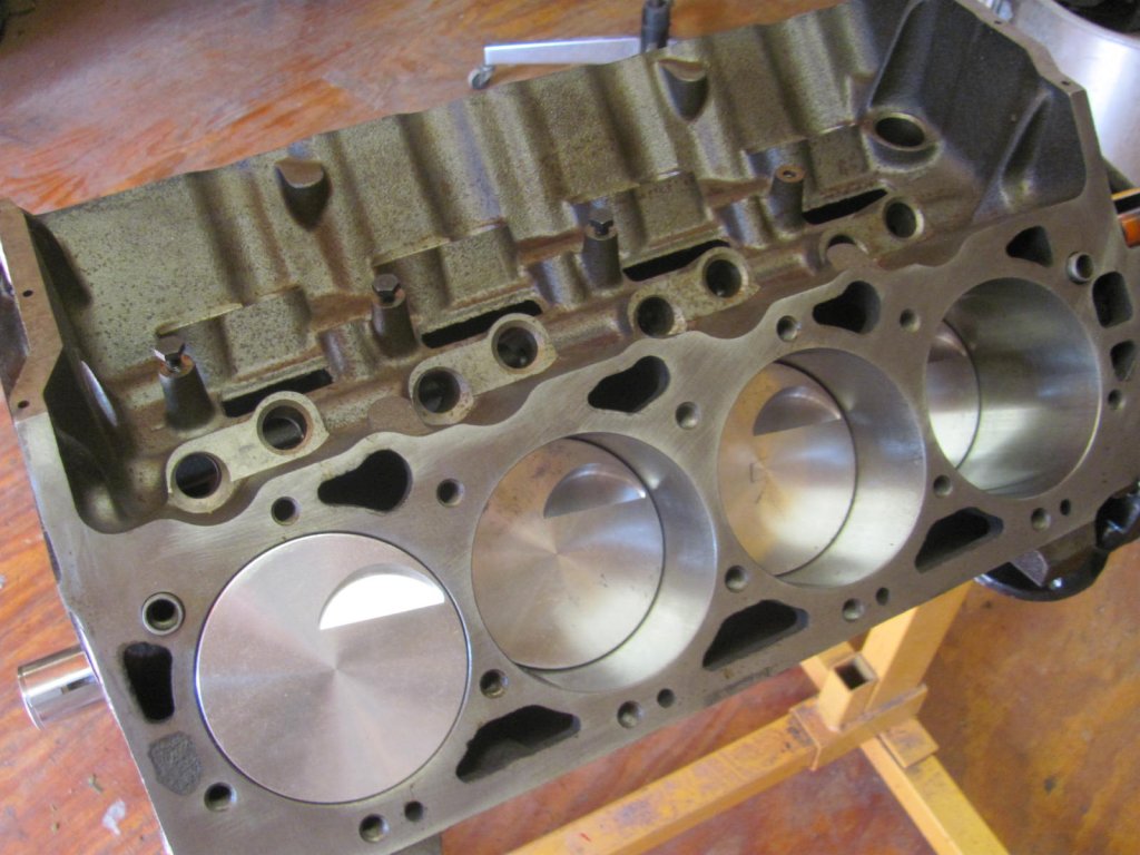

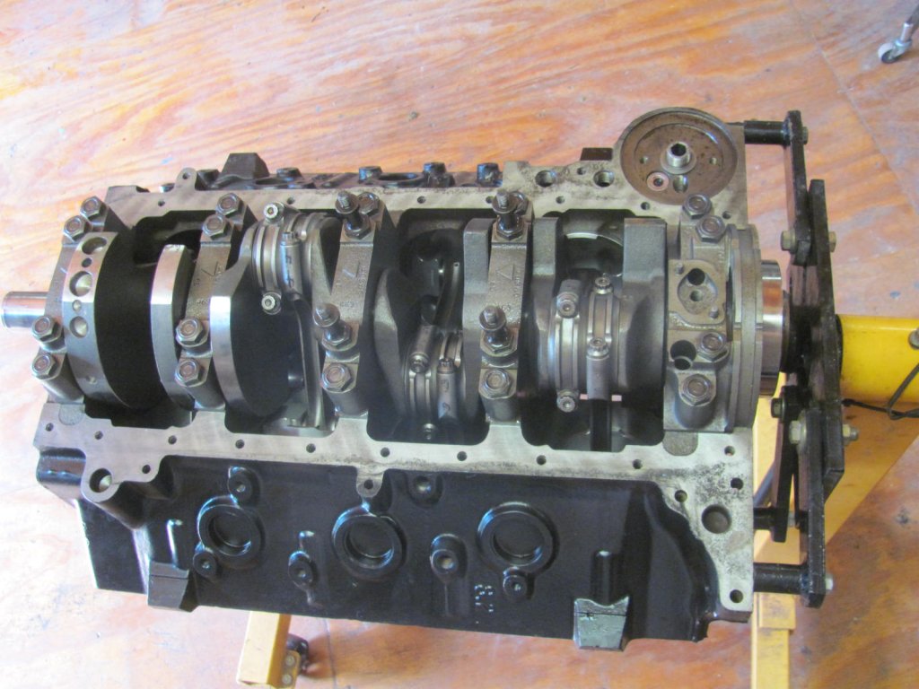

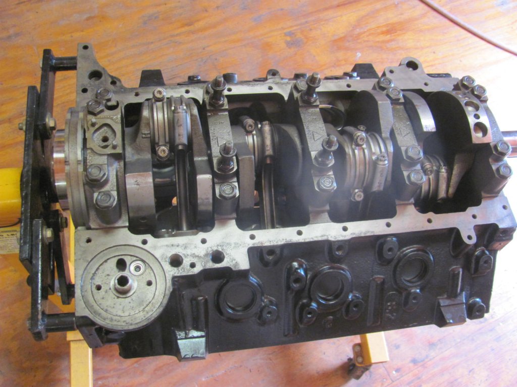

photos of the "mystery motor" I was so ignorant about

Craig Nedrow
NADAR UNDER THE RADAR
Sep 1, 2018
1,684
4,228
Washington State
Craig
1973 (have two), 1985
K10, K20, C20
350, 454, 6.2 Detroit
Looks clean, lucky dog.

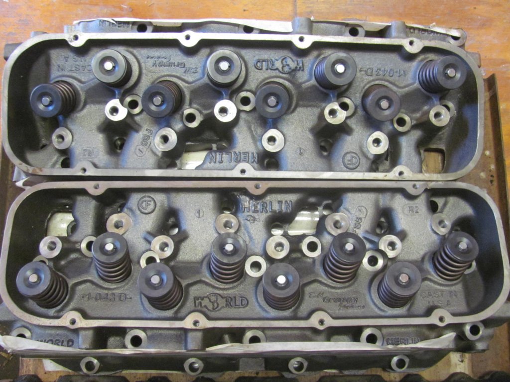

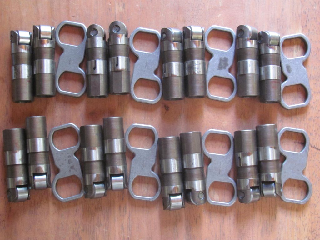

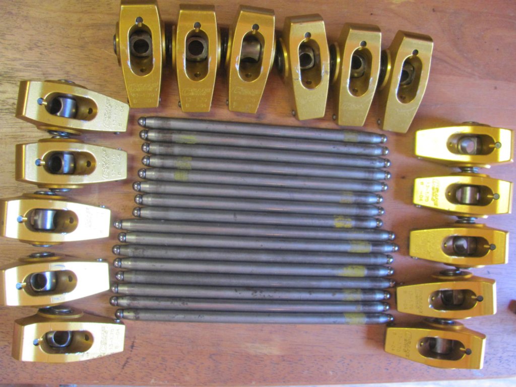

But wait, there's more. When I went to pick up the block, the owner said "you might want these too" and rolled out some brand new Merlin oval port heads. then he added "Springs are for roller cam". He also found some used valve train parts, like roller rockers and roller lifters. "Buy the heads and I will toss in the extra parts" he offers, and I tell him I only brought enough cash for the block. "You can owe me" he adds, "I know where your mother-in-law lives" - he's in her neighborhood. So it looks like I will run a roller cam if I can find a good one.

nvrenuf
2,600
4,045
Mobile, Al.
1991
That could be a great score BUT make sure those aren’t too much head for what you’re doing.
Dang, you got away with a STEAL. Those world products merlin heads are a great cylinder head, especially for a street motor. I'd probably just throw a comp extreme energy roller cam in there and send it. The XR276HR-13 or XR270HR-13 is probably a good choice for a somewhat mild 502 for your square. You could also try calling a place like Delta Camshaft and see if they have a Gen VI stepped nose cam laying around they could grind for you specifically to your specifications.
