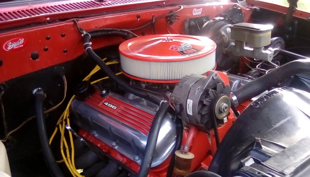

You will love that big 500, my 496 makes loads of torque.
