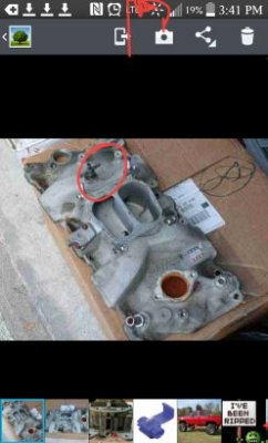

Ok are the pcv and break booster currently connected to the big port on top or bottom?
The pcv is on top on the front. Booster is on the bottom on the front.

Is this incorrect?

Yes cap the top port and run pcv to the bottom, booster to the back

The only one on the back is on the very top by the back. It's too small. The booster line just falls off it.
My booster is on the back, connected to a 3/8" piece of stainless tubing that is bolted to the bottom plate of the carb. It's a large port I know that, and it's not connected to the manifold, there is another port back there too but it has a 3-legged tee, and my cruise is hooked to it as well as the line to the trans and something else.

Starting to sound like a vacuum leak. Make sure the 4 carb mounting bolts are very snug
Ok do you have a T fitting on the intake between the carb and distributor?

Yes. The big port is and overflow vent and is usually connected to the charcoal canister.

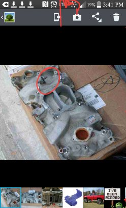

This is the T fitting I'm speaking of. This is another location for the booster to go. It's where I have mine connected.

There is a T in the back of the intake. 1 side runs into the firewall. The other side is cut off

Run the booster to the T :)

Well it was sucking air between the gasket and the intake. Took the thick gasket off and put my thin one on that came with the adapter. Idles much better now, but lost all my pep. It is gutless now.
