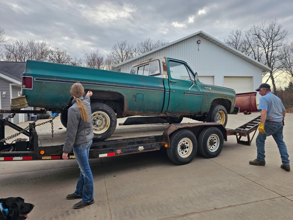

Hi forums! I'm new, wanted to get some advice on an issue i'm having.
Recently acquired my grandpa's old plow truck. We're up in the heart of the salt country, so it's obviously completely shot in the body department. But other than that, the truck has only 57k original miles, and is mostly complete except for a tailgate and some bits and pieces.
Anyway, I just got it running and driving. (Not fully roadworthy yet), and i'm having an issue with my engine performance. Anywhere else in the throttle besides barely tapping, it begins to bog pretty badly. If i just keep my foot barely pressing, it will run really well and accelerate slightly. But as soon as i push it any more, it begins to bog down and won't accelerate until i floor it to kick it down a gear. I've changed the fuel filter in the quadrajet, and put a new fuel line from the fuel pump to the carb. (Old one rusted off trying to remove it to flush old gas through.) Anyway, it idles about perfectly, and the accelerator pump is visibly working. Any ideas on what it may be? Right now my thoughts are either the fuel sock is completely covered in rust and varnish, or maybe my secondaries are somehow not getting fuel. But advice is much appreciated. Looking forward to reviving her to her former glory over the next few years. Thanks, Tyler
