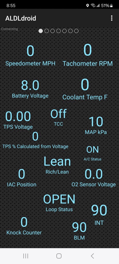

not knocking using a DMM, but if you can find a 1320 electronics or red river devil Bluetooth scanner and have a Droid phone with ALDLDroid, it gives you a lot more info than just the trouble codes and is very user friendly. here is my home screen on that app, but it shows even more data. and you can log data and export to an excel file.
I am sitting on the couch. so that's all just default app info displayed. before somebody tells me I have a lot of problems :)

no doubt! no way I could use tuner pro or the more complicated software without a steep learning curve. I think ALDLDroid is about as user friendly as you can get for a non-mechanic like me. but even with ALDLDroid, you still need a vacuum gauge, timing light, DMM, and other tools in the toolbox.
