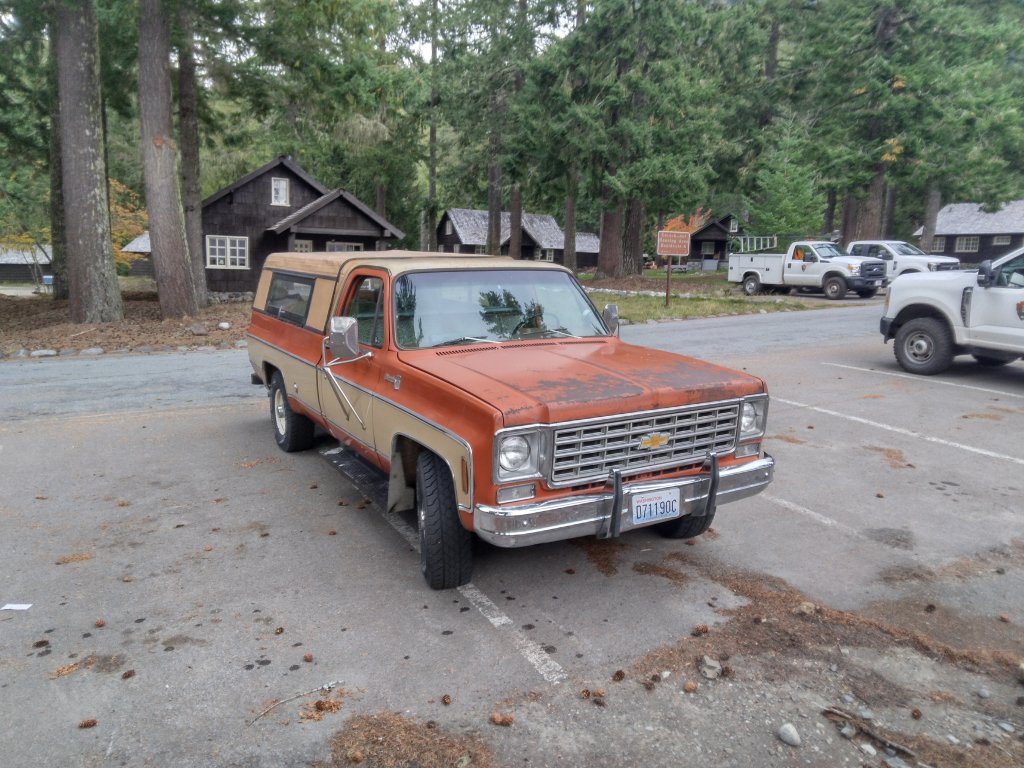

Hey Y'all!
I've got this awesome C20 (4 bolt 350, Edelbrock 4 barrel carb, Accel HEI, th350 tranny)
I picked her up in Washington State and drove all the way back home to the Orlando area with almost 0 issues the whole drive! My alternator went out and I replaced my drive belt, aside from that I got her an oil change, new oil and fuel filters, and she drove like a dream from coast to coast.
