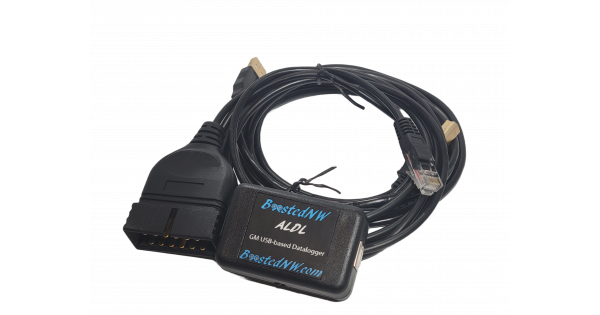

The "problem" isn't that its difficult - its that no one makes the tool new anymore and its hit or miss buying a used one as to whether or not it comes with the right adaptors and decoders. I've been trying for almost 2 years to find a tool that can give me the live data...apparently the only way to do it now is to get a special cable, a Windows 10 laptop and a person who knows how to get them to play nice with each other. Without the ability to read the live data, troubleshooting the TBI system does fall back to using a multimeter, vacuum pump and hope.
That ALDLDroid app might be easier to make work but buying the 1320 bluetooth thing doesn't seem to be possible anymore. It seems like the cable and laptop is the only option at this point.
there is also these guys, although it says backorder at the moment...
and these guys for running a laptop...
or here
