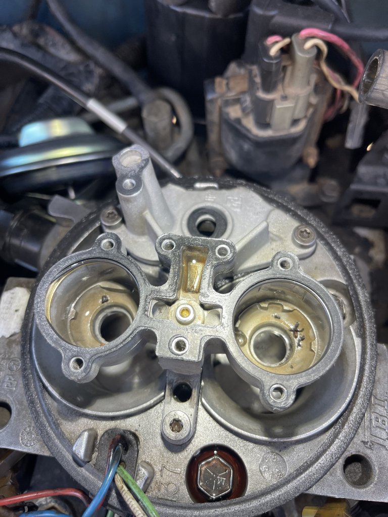

Found some trash in the injectors bowls. Getting new gm injectors and gasket. Hope that might help some. Had 2 vacuum lines backwards from smog pump to tbi and egr solenoid to front of tbi. Hoping that helps too.

I had asked way earlier but never heard back regarding the spray pattern of the injectors, i suppose they couldve been your problem
Crazy enough spray pattern looked perfect. Might have been thin but looked ok. New injectors made truck run like a new. Have put around 150 miles on it and am loving it.
