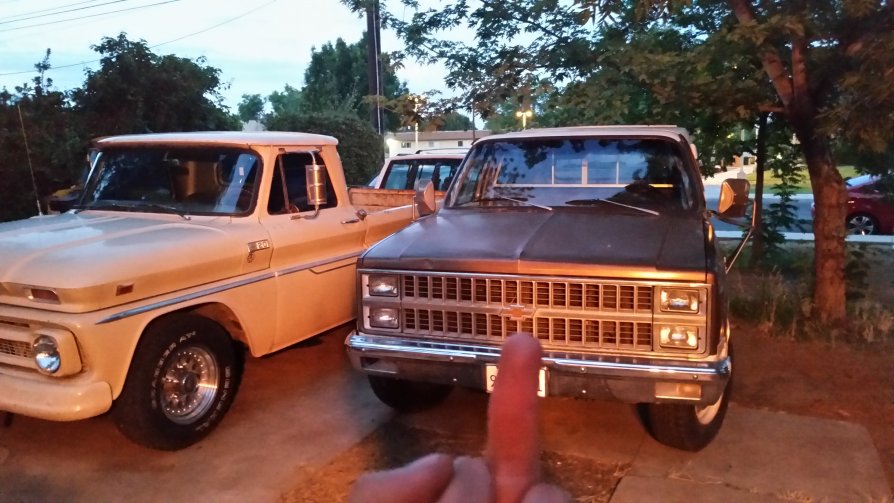

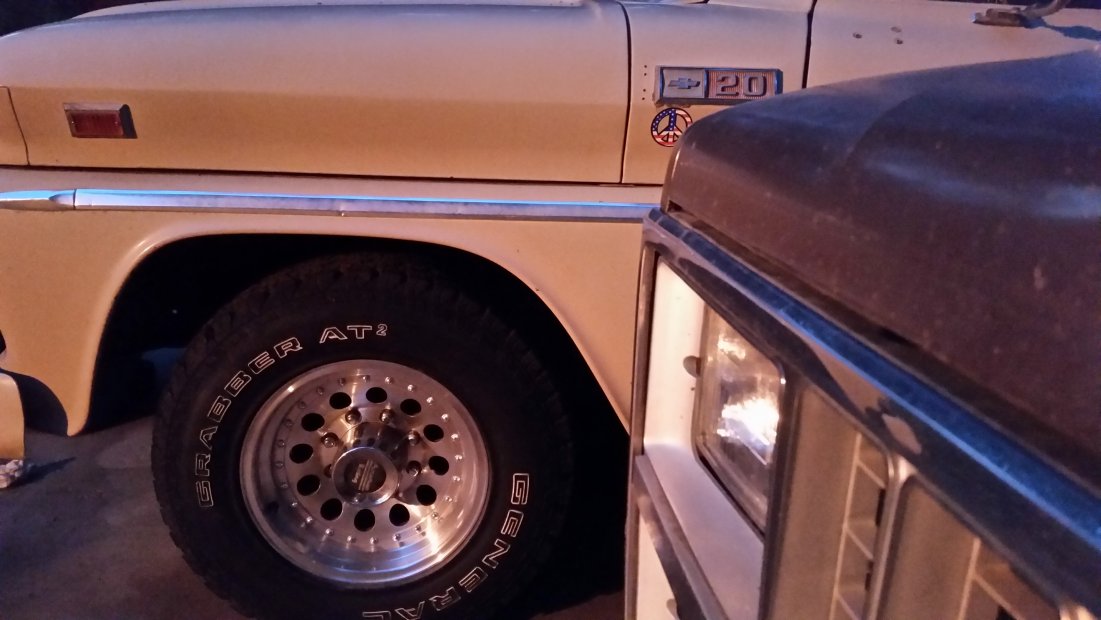

Here are some photos I took the other night when I was feeling buzzed :drunk: and artistic. Big brother and little brother hanging out in the driveway...and me trying the finger thing to cover up the license plate :rofl: :happy175:

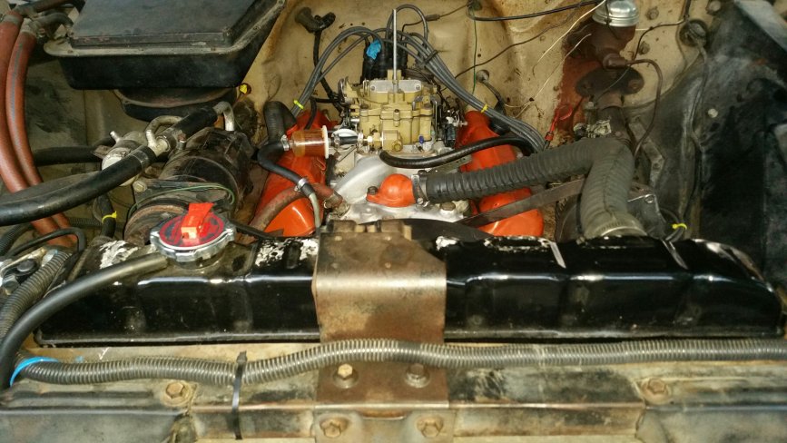

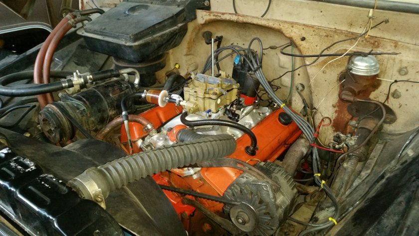

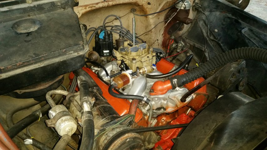

A simple carb swap turned out to be a semi-big project. I didn't know that the Carter AFB was a square bore, so the intake needed to be swapped too. I had an Edelbrock 2101 out back so I cleaned it up and slapped it on. Now the temp sending unit interferes with the coolant neck and needs to be relocated to the head. But that actually helps get better readings, so it's not a bad thing. However, the new sending unit I bought came with a plastic piece for the connection but no connector. And every dang auto parts store said they don't have them. Even went to radio shack and some other specialty stores. COME ON PEOPLE! I know they make these things because here is proof in my hand!! Finally after 3 hours of driving around in 106* heat and no AC I went to a different NAPA, and they had what I needed so I bought 2. Now I need to lengthen the wire and rout it to sending unit so it won't hit the ram horns.
To me the engine just looks better with a quadrajet sitting atop the intake. Just looks right. After firing it up last night, minus the sending unit being relocated, it fired right up, fast idle was a tad high, and I finally got the fast idle to kick down to idle. Then I saw gas pooling on the intake. CRAP!! Added more pvc paste to the fittings and tightened them a little more, and that fixed the leak. But then the engine wouldn't settle down when I started it again. I suspect the intakes gaskets didn't seat properly. I will check that out tonight after I relocate the sending unit. In any case there is a massive vacuum leak. Another oddity, the factory air cleaner housing I bought that is supposed to fit a 68 truck, the bottom of the air cleaner housing hits the throttle arm of the carburetor. So I may need to find a different housing. If I do I need to find one with the air intake on the driver's side so I can run the air intake hose to that side instead of under the battery tray. There isn't any room under there. I need to get creative for the air intake hose and how it draws air in from the front of the engine bay. I may go with something like I see on my Subaru, a long thin opening that the hose attaches to. I just know I want the air coming from outside the engine bay.

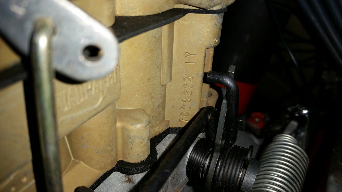

Here are some pics of the new carb and intake on the motor.

foamypirate
3,302
468
Central TX
Jake (Mr. Wilson)
El Camino, baby!
5.3L/4L60E
Good work there, sir. It's always the "simple" projects that turn out to be a PITA, isn't it?

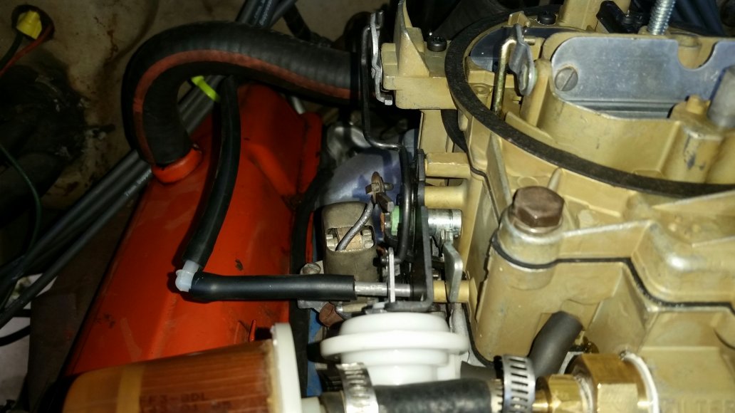

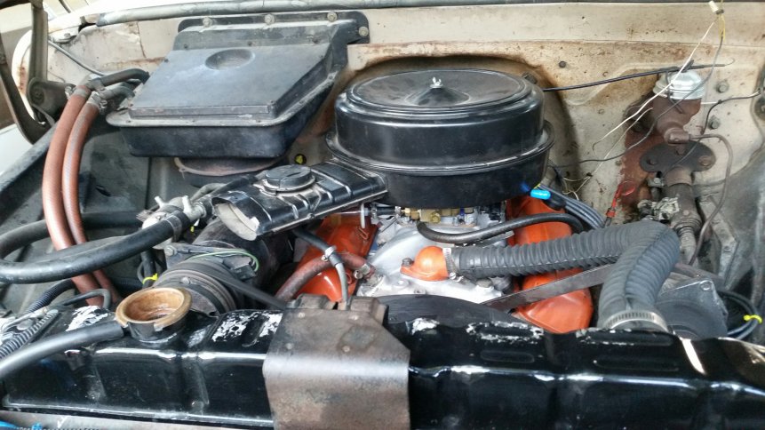

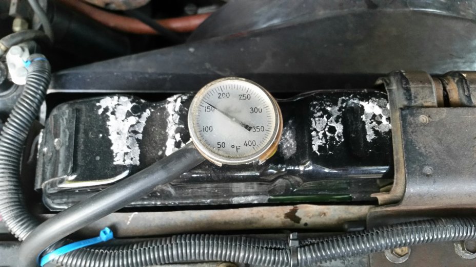

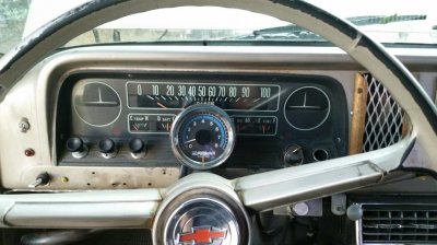

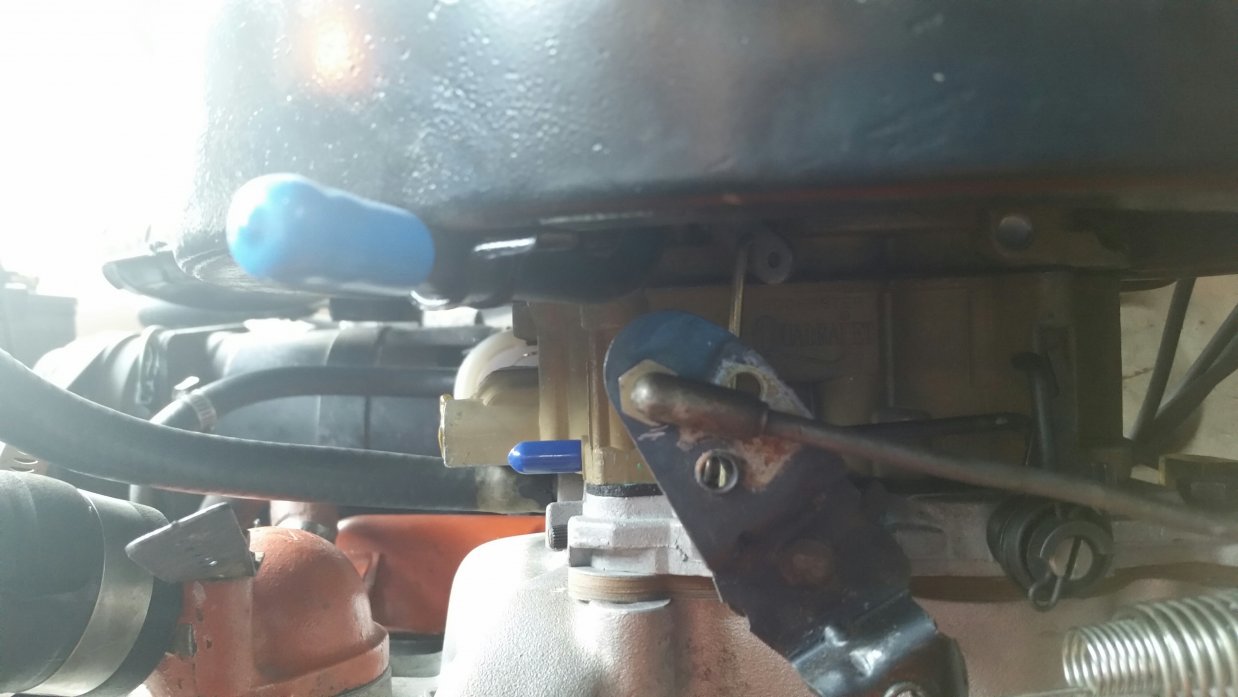

Last night I got the temperature sending unit relocated, but not wired up. The truck runs way cool with that new 3 core radiator and new shroud, but I cannot let this go unwired for too long. The huge vacuum leak I had was an error by little ol' me. When I fixed the leaky inlet I forgot that I pulled the pcv hose from the carb. Pulled it to better see where the leak was coming from and didn't slide it back on for the second start-up. DUH SHANE!!! With the sending unit relocated I fired it up and it idled fine. As a precautionary thing, I did spray some cleaner around the intake and carb and there was no change in rpm's, so that's a good sign. Found out what was hitting the throttle arm on the bottom side of the air cleaner housing. It's an air tube that I am guessing goes to a vacuum canister or pcv valve. I wanted to make sure the engine was running cool so I inserted a thermometer in the radiator and it was all good.
The descriptions for the pictures are:
Checking the gauges (Sans temperature) after installing the carb.
View of the engine idling.
Found what was hitting the throttle arm, and 1/2" spacer fixed that.
View of thermometer after the engine was idling in summer heat for a half hour.
