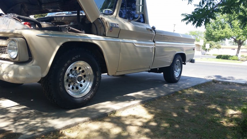

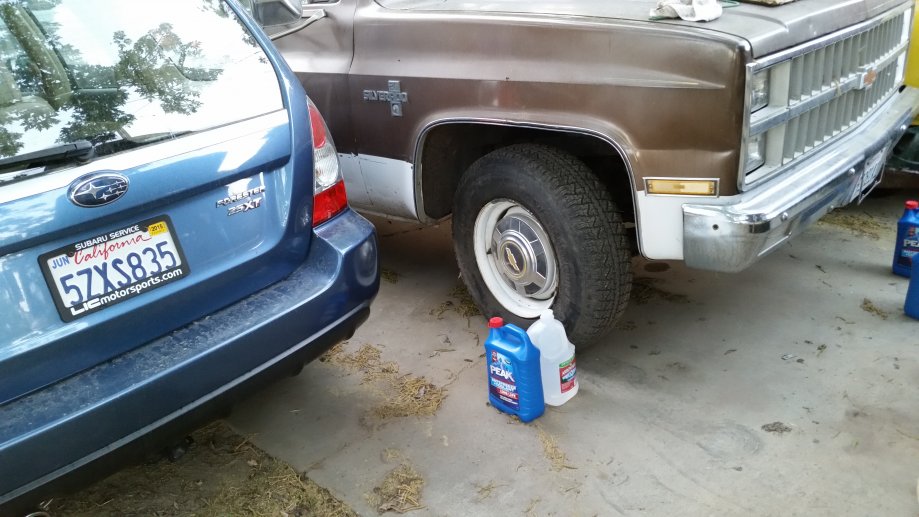

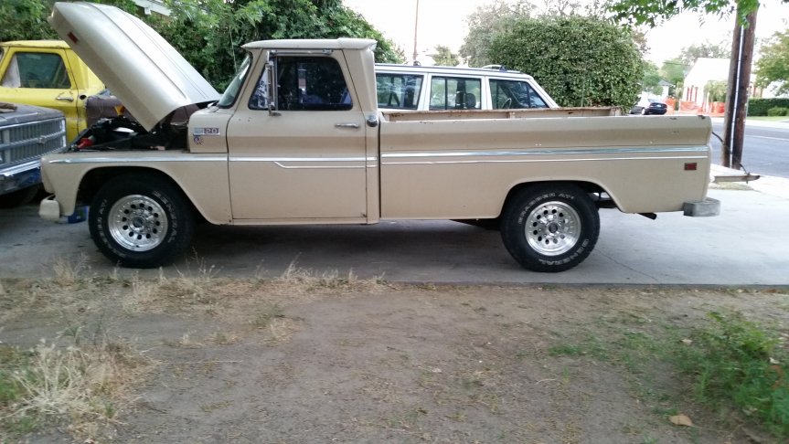

Saturday I finally got around to switching over the tires from the 81 to the 65, and to me it looks a lot better. They had some of the lug nuts way too tight, and luckily none of the studs broke because of that. I need a breaker bar to get them loose and a couple a cheater bar was needed but couldn't find it so I wrestled them loose.
This is after the tires were switched over...and the 81 got the stockers put back on. The 65 rides so much better now with the bigger tires on it, and for some reason it is easier to turn now too. And these tires are wider, taller, more aggressive tread than the tires they had on the truck. I think they were just passenger car tires because I couldn't find any load rating on the sidewall. At least the tires I put on it are Load Range E.

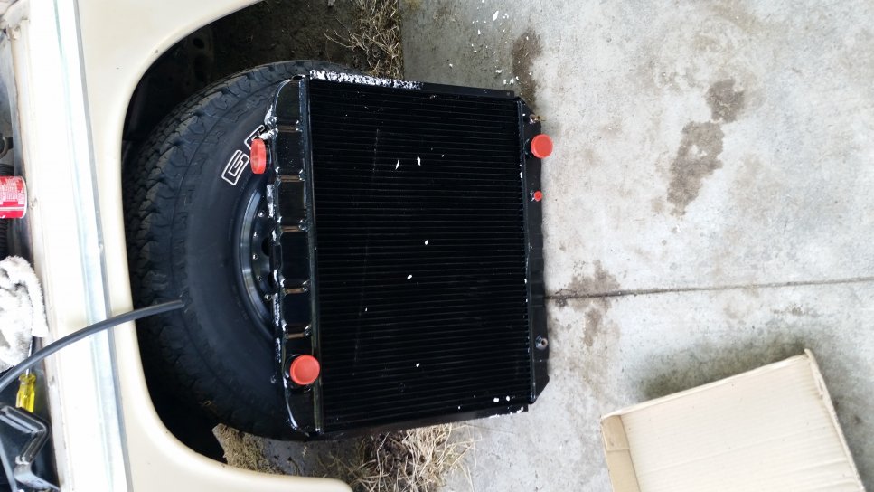

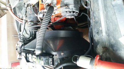

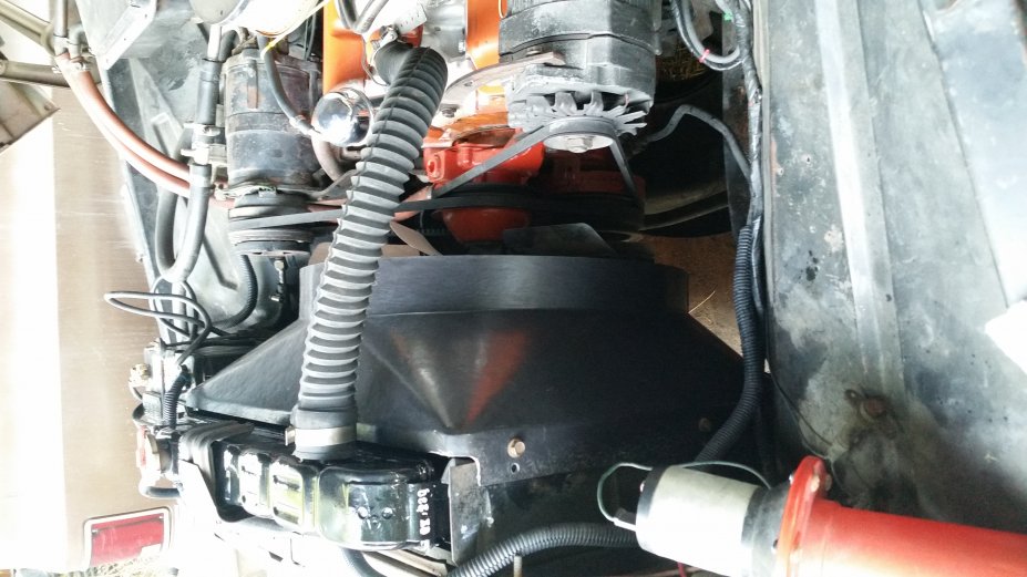

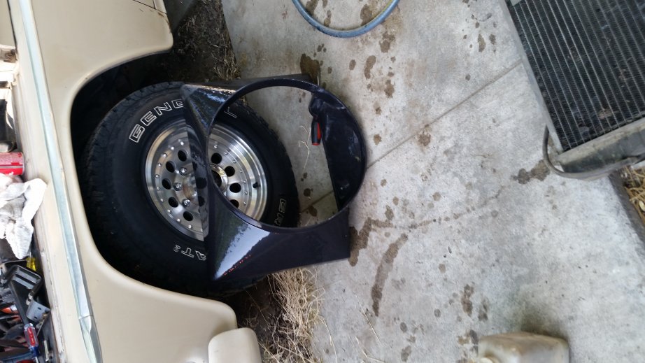

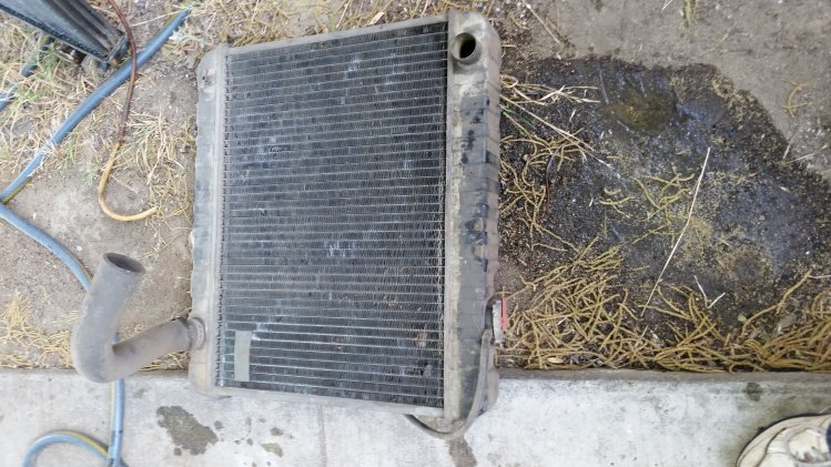

After I switched over the tires I decided I needed to address the cooling issue. It had a 2 core radiator in it that was plugged up. I was going to do the CLR cleaning treatment to get the crud out but decided to use the 4 core I had in the back shed. So during the week I pulled out the 4 core radiator that came out of my old 65. I went to install it and it wouldn't fit. The holding brackets weren't wide enough for the bigger radiator, but I wasn't thrown off track, all I did was go get the new-still-in-the-box 3 core I had in the back shed and install it. It barely fit, it's a hair too tall but doesn't interfere with the hood. Got it all back together and didn't have enough coolant to fill it. So I went to AZ for coolant and the grocery store for distilled water. I didn't tighten the lower radiator hose clamp and it was leaking, so I had to loosen the new shroud I put on to gain access to the lower clamp and tighten it. Topped off the radiator and burped the system. No more cooling issues. It stays down by the "C" now. I do need to get some small pvc tubing or maybe some clear tubing for overflow reservoir. The new hose that came with the radiator is too big for the opening in the reservoir cap so I need to drill it out.

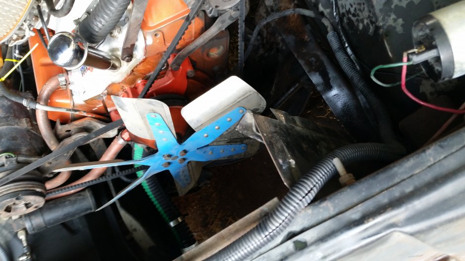

Last night after getting back from mom and pop's, I got the number off the front of the block because I wanted to check to see if the engine is really a 283. I doubted it was because it has more low end grunt than I recall a 283 having. And then when I opened the passenger door, an old for sale sign slid out from under the seat and onto the ground. It says it has a 350 v8 in it. This is the number from the front of the block: V1005CDD. There is no partial VIN there, just that number, and the top of block in the back is covered in gunk. And this is a pic of the old for sale sign that was under the seat....
I had a feeling it was not a 283 just by the valve covers not having the scripted Chevrolet on them, but figured someone could have easily put different valve covers on it. If it's a 350 I am going to spruce it up in the future and make it a vortec 350 by getting some fresh vortec heads from GM Performance and a new intake as well.

Well I did a little digging around to see what that stamped engine code "V1005" and the three-letter "CDD" suffix code might conjure up, and the engine was built in Flint, Michigan on October 5th, and it is either a:
1972 350 L48 with 200hp from a Camaro/Impala;
1972 350 4bbl with 175hp from a Chevelle;
1972 350 2bbl with 165hp from a Monte Carlo;
1982 267 2bbl E2ME with ???hp from B/G Omega
1982 305 4bbl E4ME with 150hp from B G F.
My guess is a 1972 350 because the valve covers look like the 1972 350 photos I did a search on, and until I can get the casting number I have to keep guessing. I don't know what B/G Omega means or B G F. Now that I know it's not a 283, I can just get some vortec heads and intake and the same cam that I put in the 81. That engine runs plenty strong with that setup. I will basically pull the engine and do a complete reseal of it, but while the heads are off I can check to see if there is a ridge on the top of the cylinders. If there is I can plastigauge the crank and rods, and if all checks out fine do a rering of it it too.:party36:

B body, g body, f body
47,814
10,942
Flyboy is correct is on the b g and f bodies on the engine designations, and the other is b and g bodies as well as Olds Omega.
I'd actually have preferred the 283 myself. Before I even got to the part of the thread, I seen the pics and already questioned the heads. Those for sure are NOT Power Pak 283/327 heads. Though you can't really expect anything that old to have the original engine. Since that part is already spoiled, keep your eyes open for a small journal 327 or 283 for it. I'd say LS is but, that will take away to much from the 60's truck feel. That truck looks real nice as it is. I really don't think I'd do to much to it. Just keep it clean. Leave it's rust spots and small dings for the charachter and history it provides. Just kill the rust somehow so it doesn't continue to spread.

Thanks Flyboy and Hotrod, I never would have guessed that.
Yeah I was actually quite disappointed to find out it was a 350, but it's installed so I will run it. When I went to look at it the first time I doubted it was a 283 because of the oil fill hole on the driver's side and the fact that the valve covers didn't have the scripted Chevrolet stamped in them. I don't like how the exhaust on this thing is mismatched from one side to the other. According to the PO the passenger side exhaust manifold is from a corvette so the output flange is larger than the driver's side exhaust manifold output flange. He showed me the exhaust manifold he replaced and it has a very small output flange and a huge hole where it blew out the side of it. Without pulling the exhaust and physically looking at the two, I have to take his word for it. I do know the exhaust pipes are very small for a 350 and you can tell it is not breathing properly. Some of that is due to someone jumping the truck. The exhaust pipes behind the axle are crushed from the panhard bar. Luckily I have two separate exhaust systems I can install on it. The one on the parts truck has glass packs and a crossover pipe to help with the scavenging, and it exits in front of the back tires. I am certain that one is pretty loud, but I bet it flows well. The other one is one I paid way too much to have installed on my old 65 and it has a dual in-dual out Borla muffler. I know this one is for a 350 because I had a 350 in my old 65, and I know it's loud too. I really don't want a loud truck, but may have to for a while. The one with the glass packs would be much easier to install so I will most likely go with that one.
