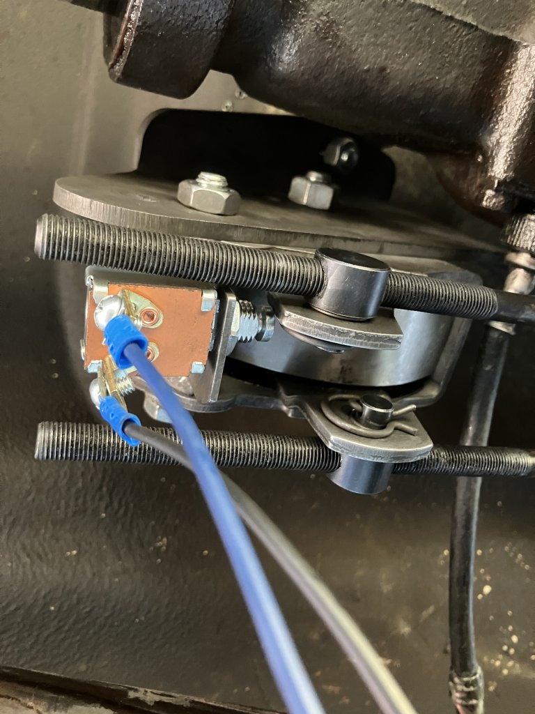

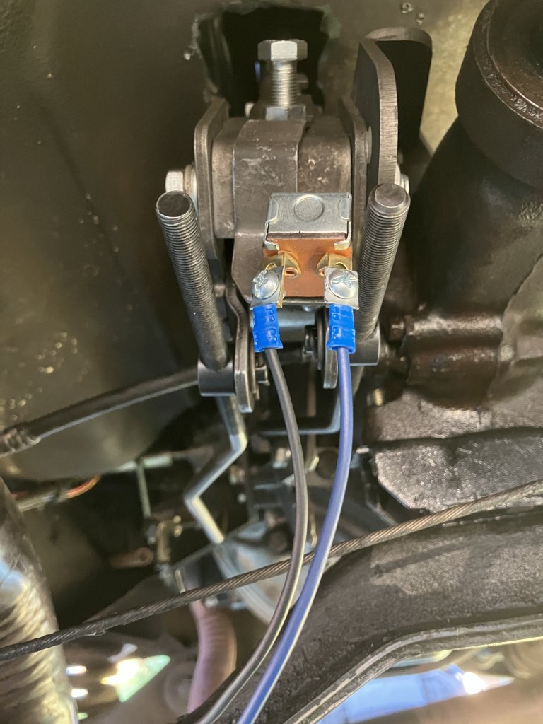

Back home from college. I installed the Hurst backup light switch earlier, and I gotta say, what a dogshit product. Out of the box, the bracket didn't put the switch remotely close to the 1/R shifter arm. After a lot of trial and error (read: bending and cursing), I got it to work. The plunger needs to be almost fully actuated for the switch to make contact, as shown in the second picture.

I would highly recommend adding heat shrink to each connection and securing the wires really well along the run they are routed.

Good call on the heat shrink. I ran the wires through the cable guides on the driver side frame rail so I should be good there. I did the same thing with my lift pump wire last summer and it hasn't given me any trouble.

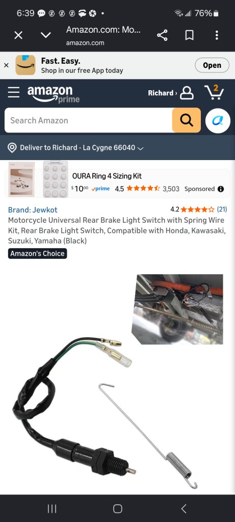

For the next guy doing this I think I'd try using a pull style motorcycle brake light switch and a pull cable. They are a pull on switch. Waterproof, IDK seems like a good idea.
