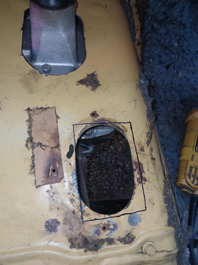

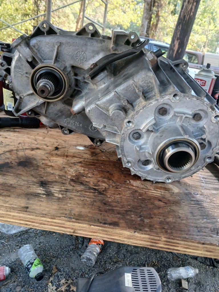

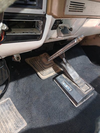

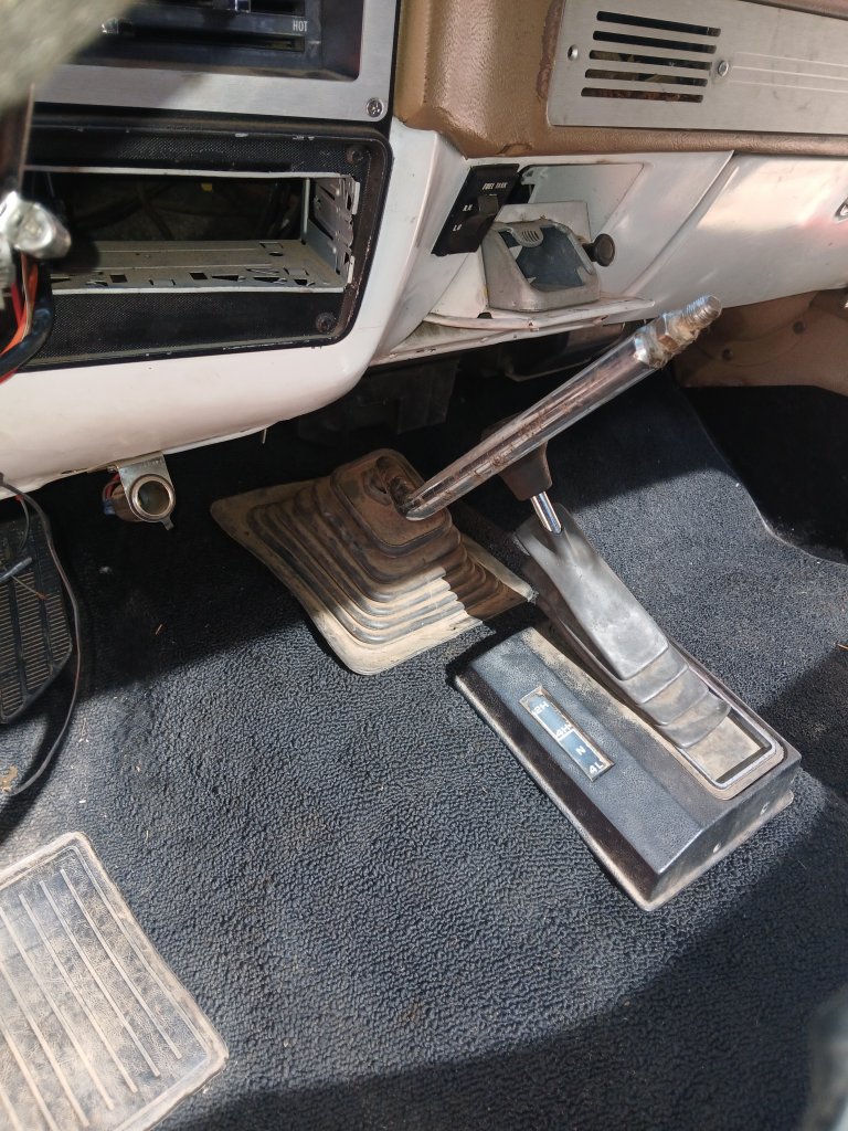

this afternoon I started putting the inside back together. Put in the empty transfer case so I could finish shift linkage and got it adjusted for all its gears and its looking Decent now. At least I'm moving forwards. Its been over 100° today too.

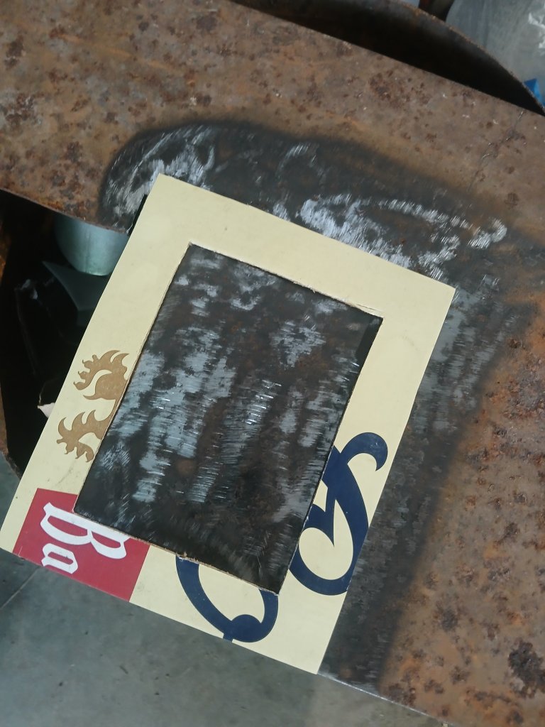

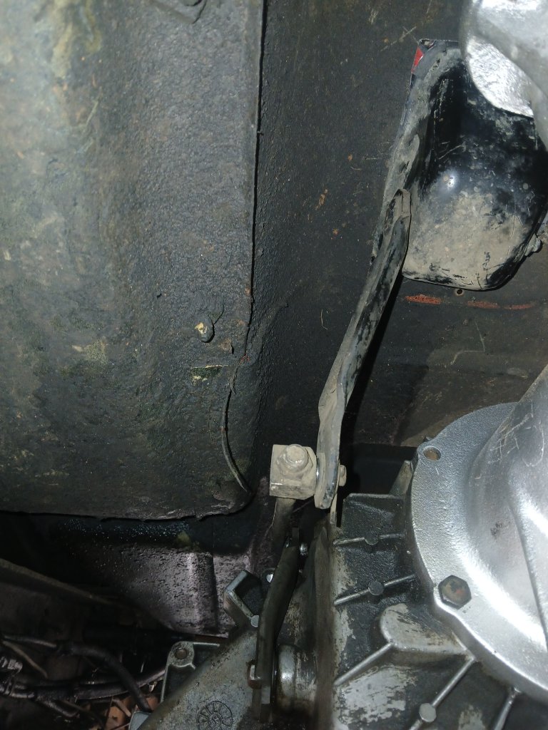

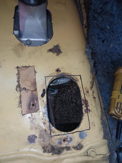

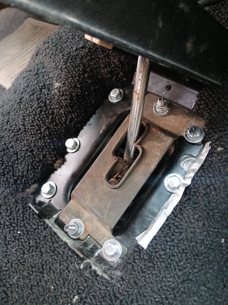

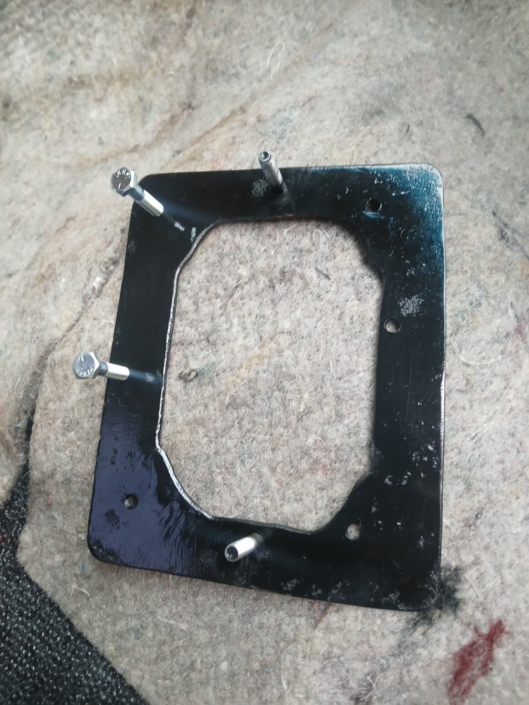

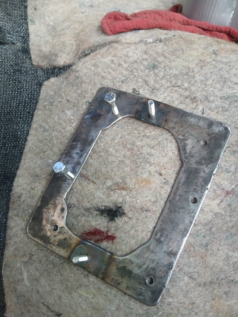

I woke up last night thinking about my shifter mounting. I wasn't satisfied with how the mounting for T-case shifter went so... today I redid it.
Cut out a plate of 1/8" and drilled and tapped the holes for 1/4-28 bolts and welded top and bottom middle bolts for studs to go through from underneath. I sealed it with permatex and I think it came out pretty good, Definitely strong and should last. Now I need to clean up the boot and stuff. I couldn't get the shifter off to do so before

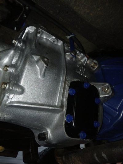

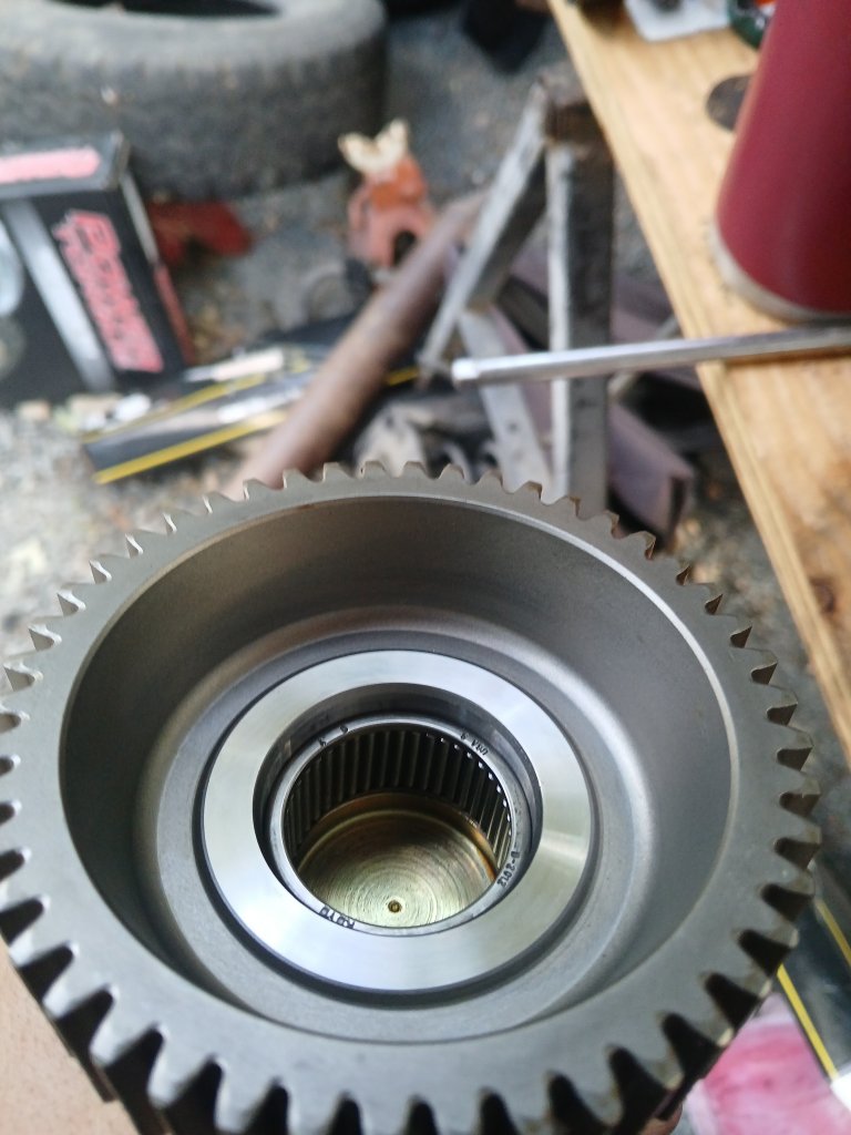

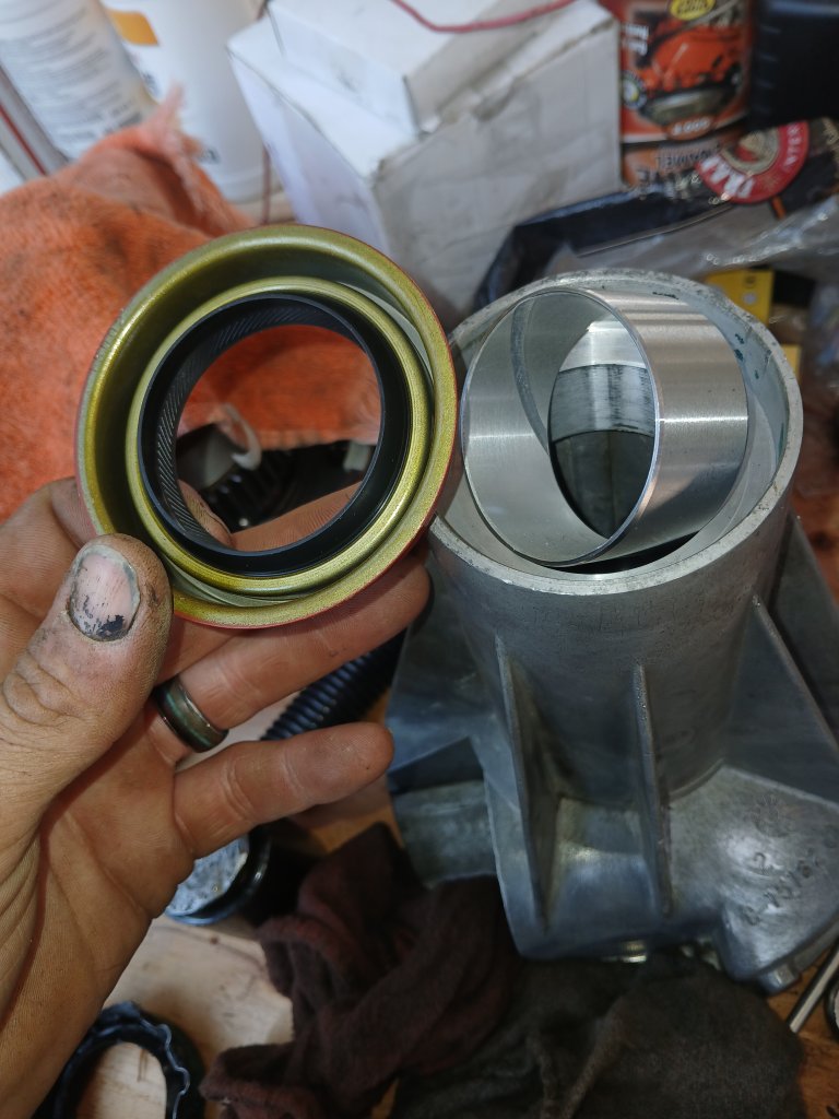

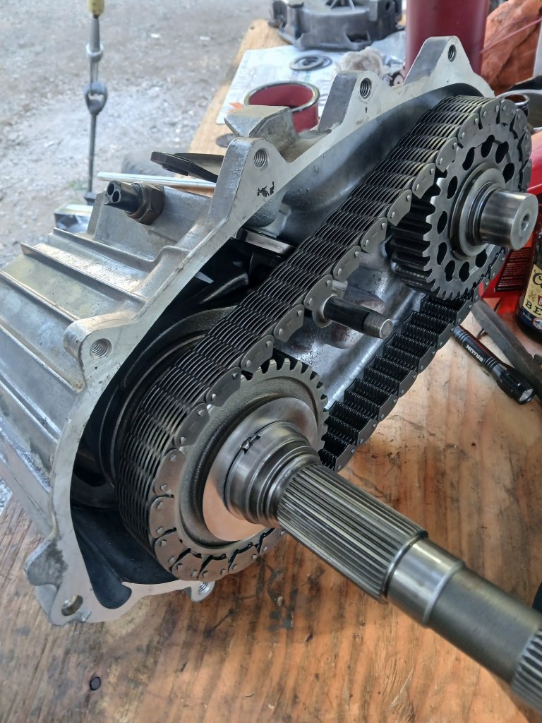

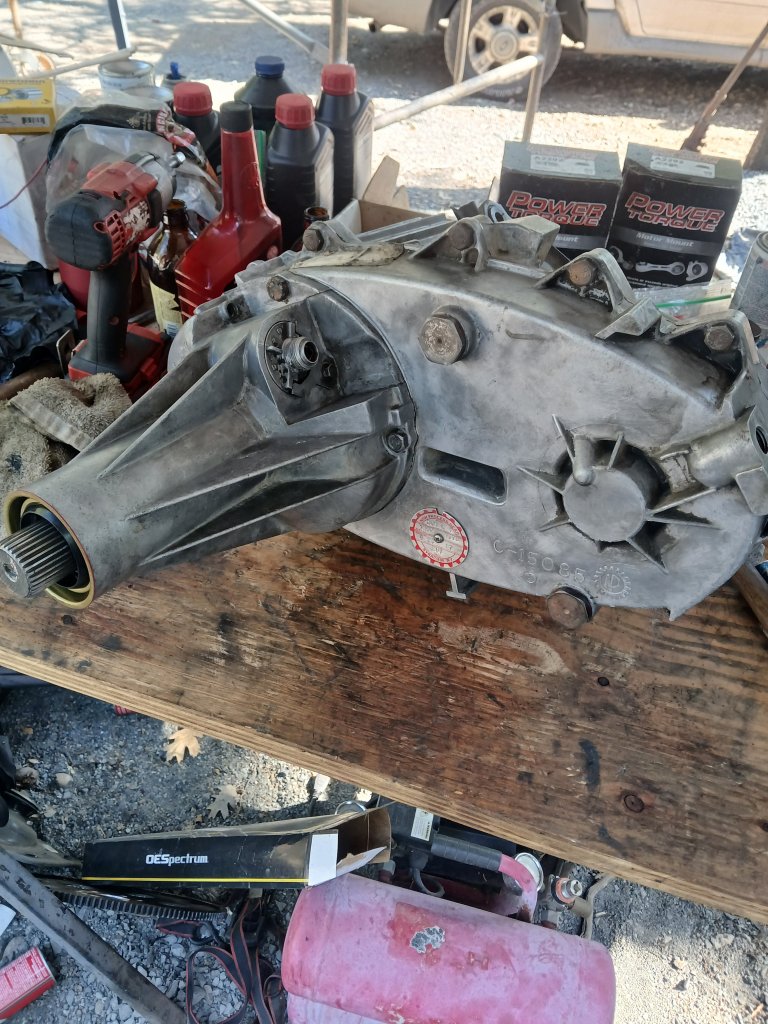

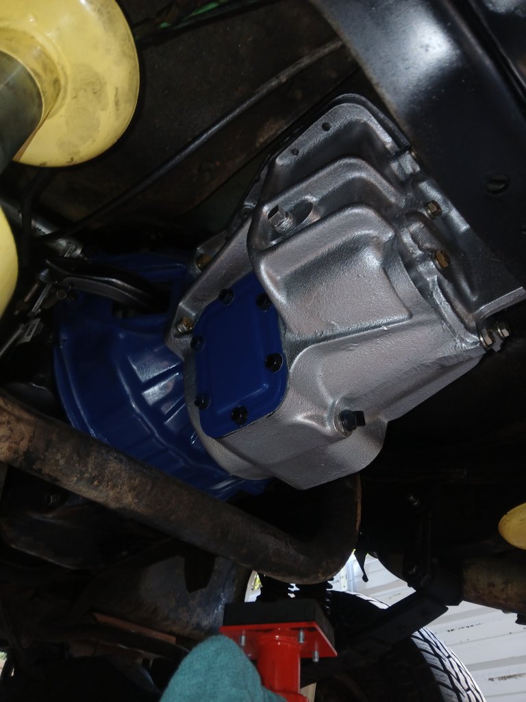

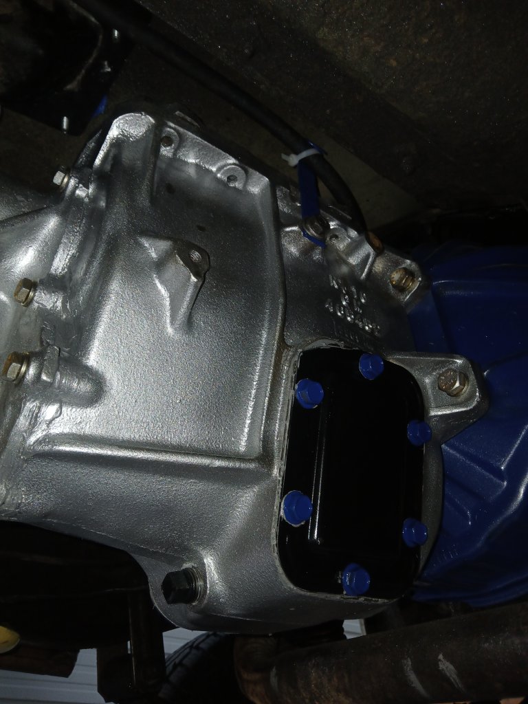

This morning i started on the Transfer case and now its done. All new seals and some new bearings/bushings and 32 shaft.
Ready to go in the truck now. Everything is smooth and all gears shift good. Getting super close now. Unfortunately I have other projects to do so I will have to continue on later.

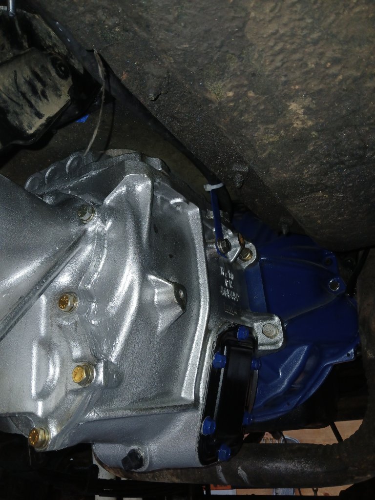

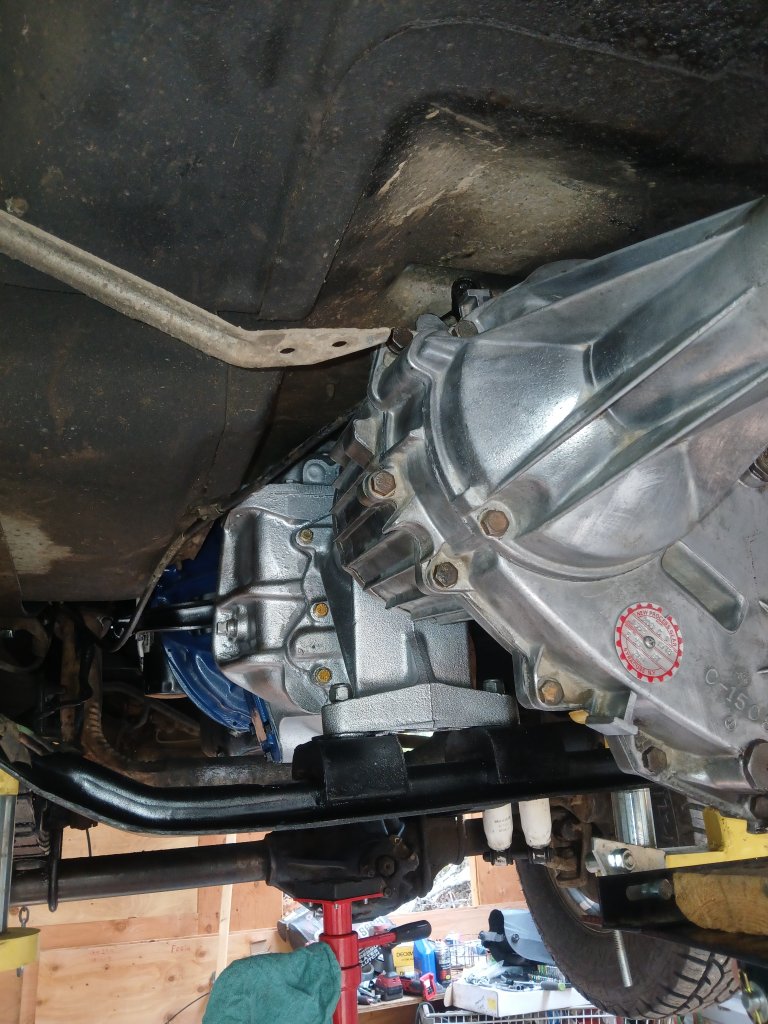

Getting very close now. Transfer case installed. Filled up transmission. Filled transfer case. Finished under dash wiring from removing the column. Started it for first time since i started project Found the oil leak. (Oil pressure gauge line) ill fix in the morning.
If it wasn't for the oil leak i probably woulda put a 5 gallon bucket in there! Not much left but to put the seat back in and check a few things and I'm on my first test drive.
Oh and somehow the driveline fits pretty good. I couldn't believe it lol.
Its out maybe 3/4- 1" from where it was previously.
Lift has another car on it so ill have to wait till then to get final pictures of it all done.

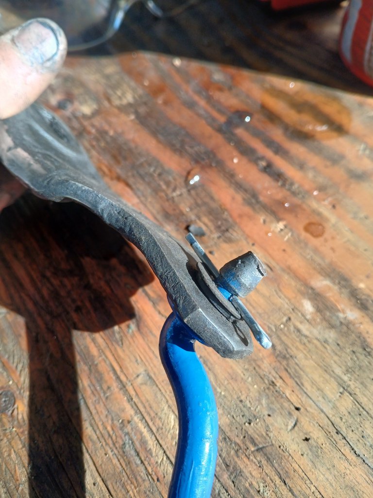

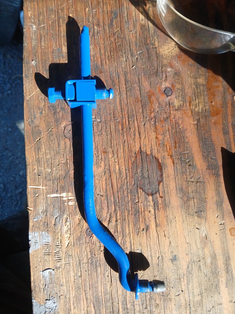

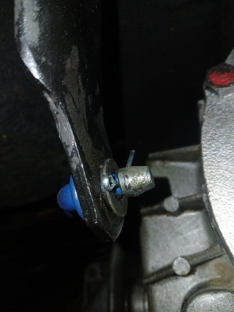

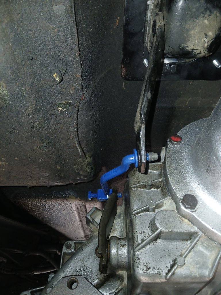

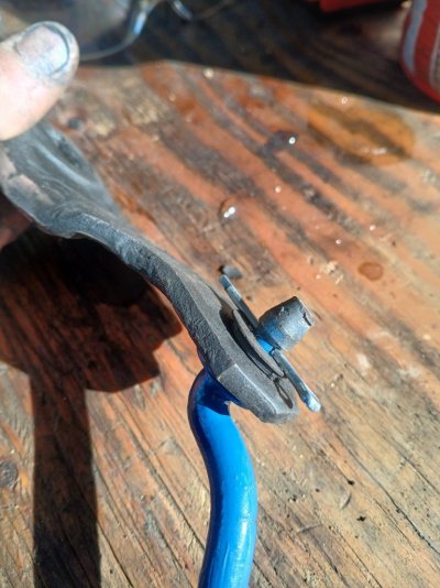

I think im done with manual conversion project.
Wasn't satisfied with the t-case shift linkage. It worked but It was pretty far off. I tried cheating with the original one by installing it incorrectly i got 1/2" closer but not acceptable. I found this one from a 97 dodge 2500 thats adjustable. I heated and bent then painted blue. It works perfectly and is very smooth. It shares the same size pin as stock so I drilled a hole in the groove to use a cutter pin in it.
