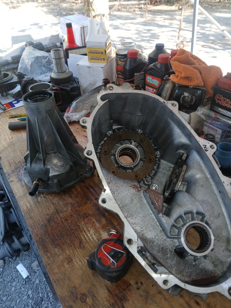

The mail came! Now I have work to do on this project. Should be back on it this weekend.

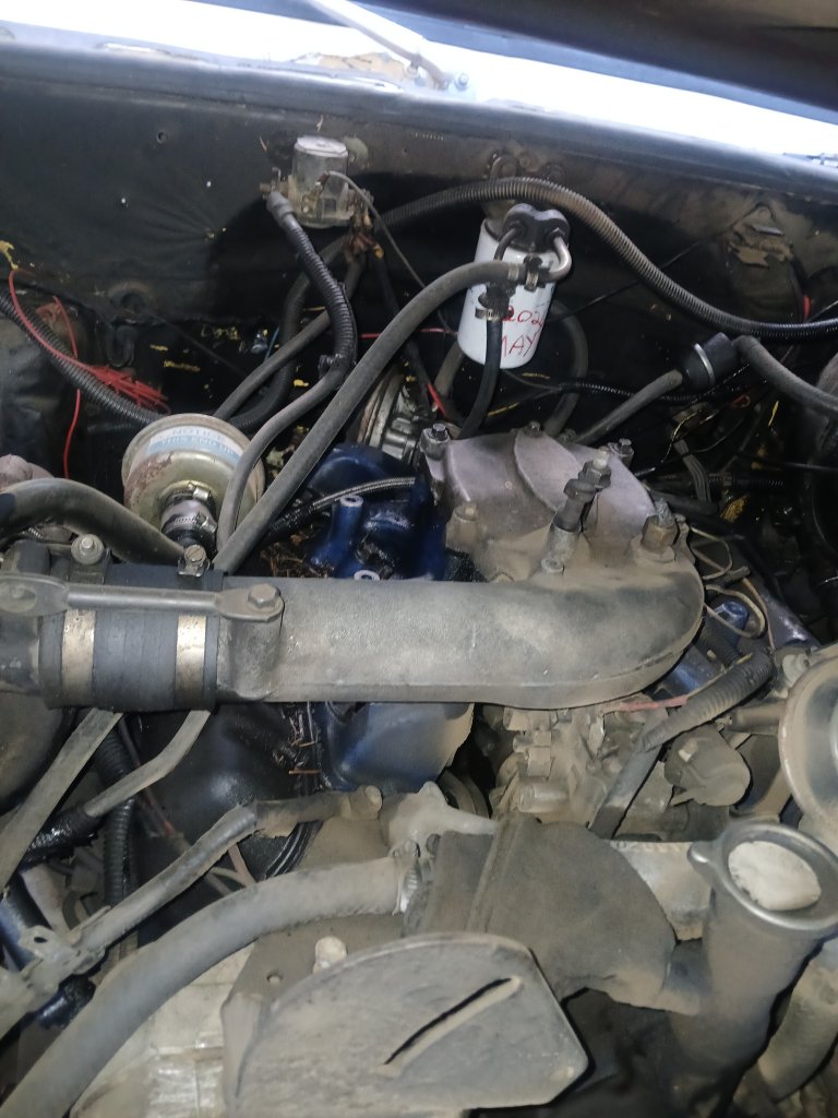

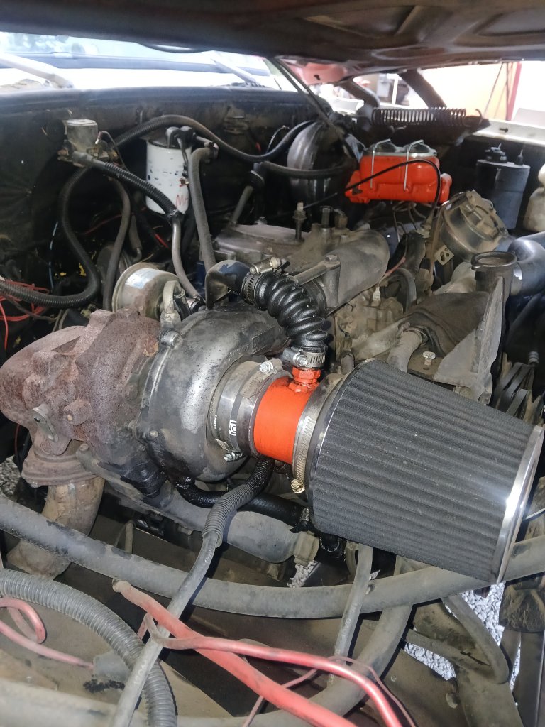

Wait? Turbo?
Gonna need some pictures of this!

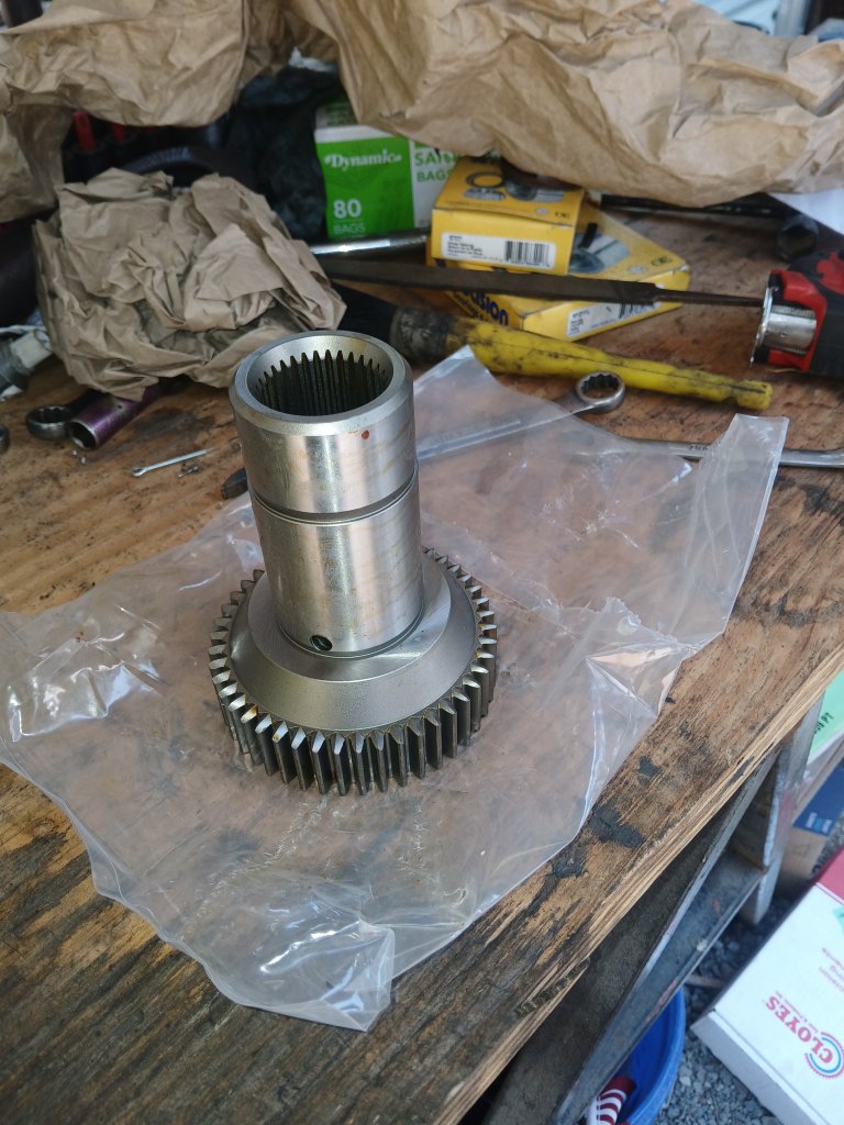

New 32 shaft doesn't have the inside bearing. Im on the hunt for the bearing now

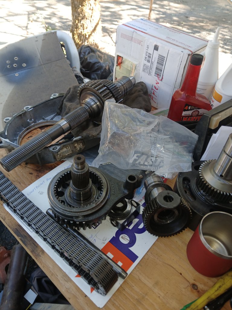

All apart. When I was looking up different 32 shafts allot of them came with the pocket bearing and I guess I assumed they all did. So now I am stuck waiting till Tuesday on this bearing unless I can get one 30+ miles away. I have plenty of other things to do while I wait at least.
