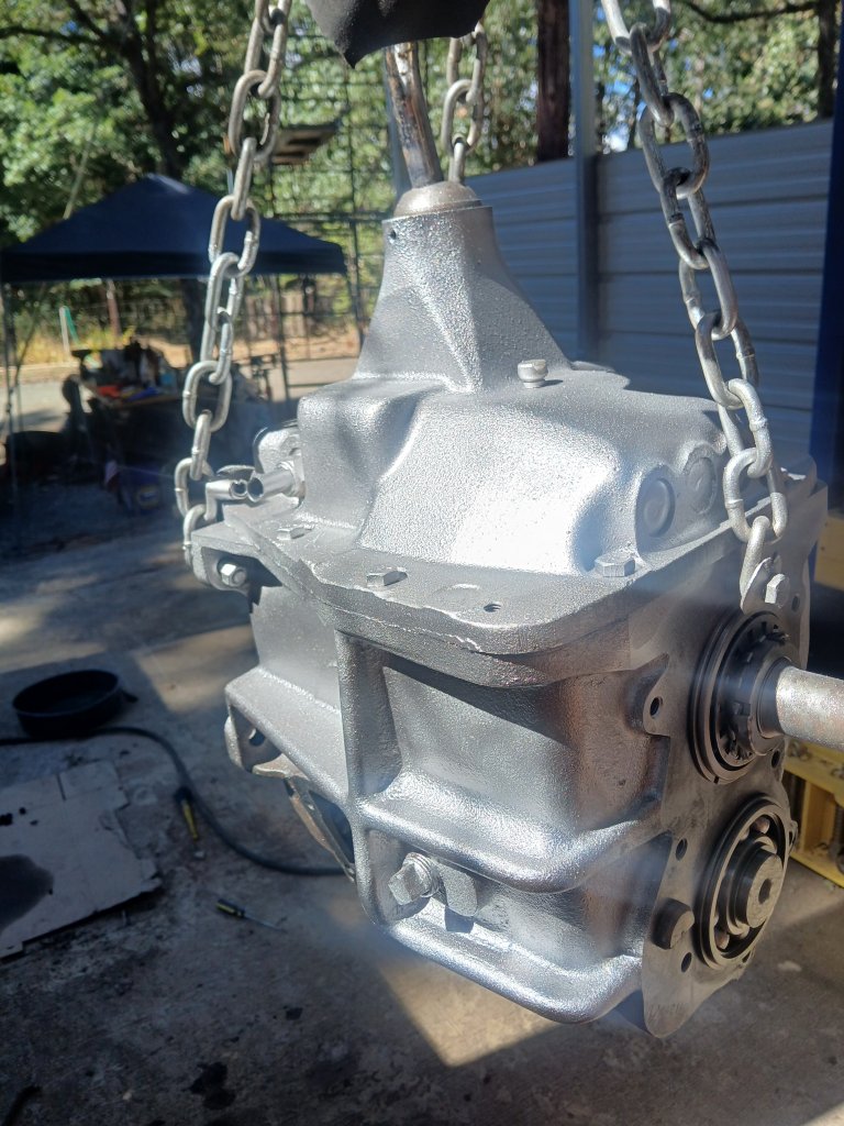

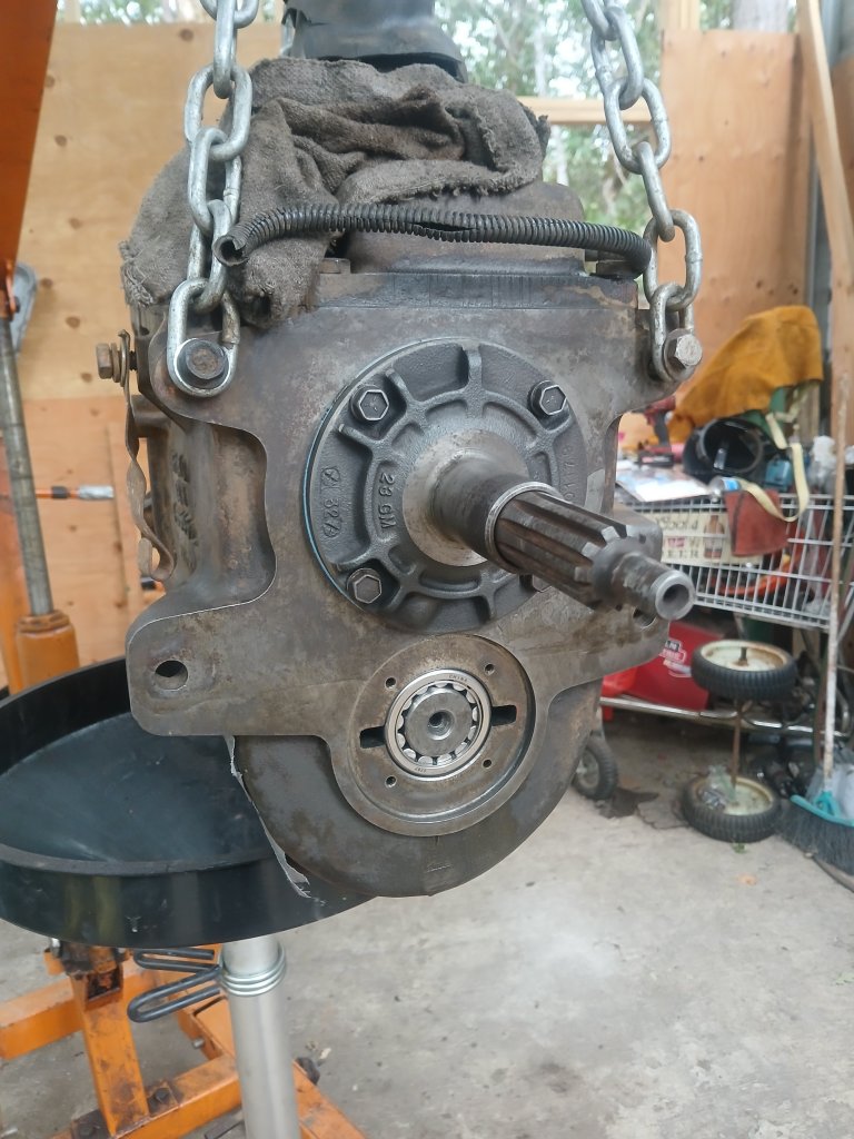

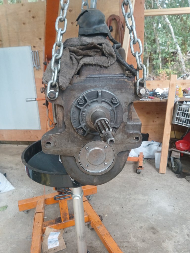

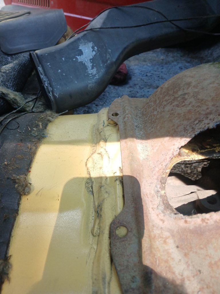

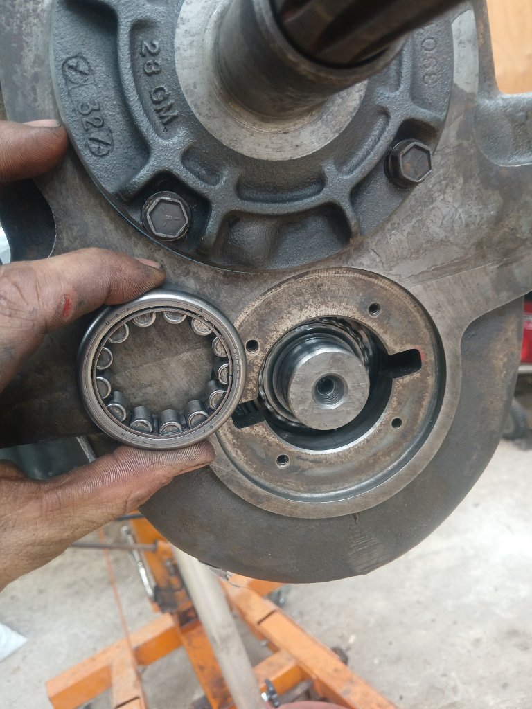

New plan. Im going to my folks place and I should have a tunnel cover over there i can use as my template for shifter.
And I got that bearing in. I feel pretty good about this thing now. When I turn it its smooth. Before it made a little noise.

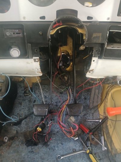

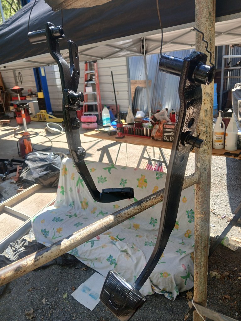

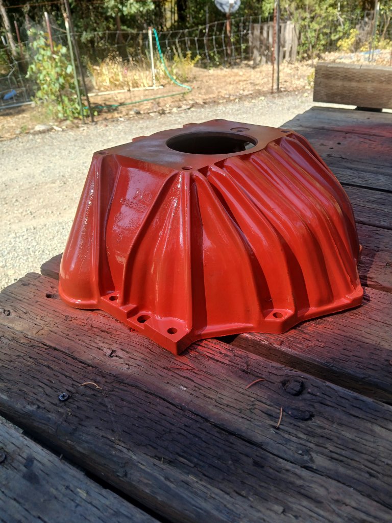

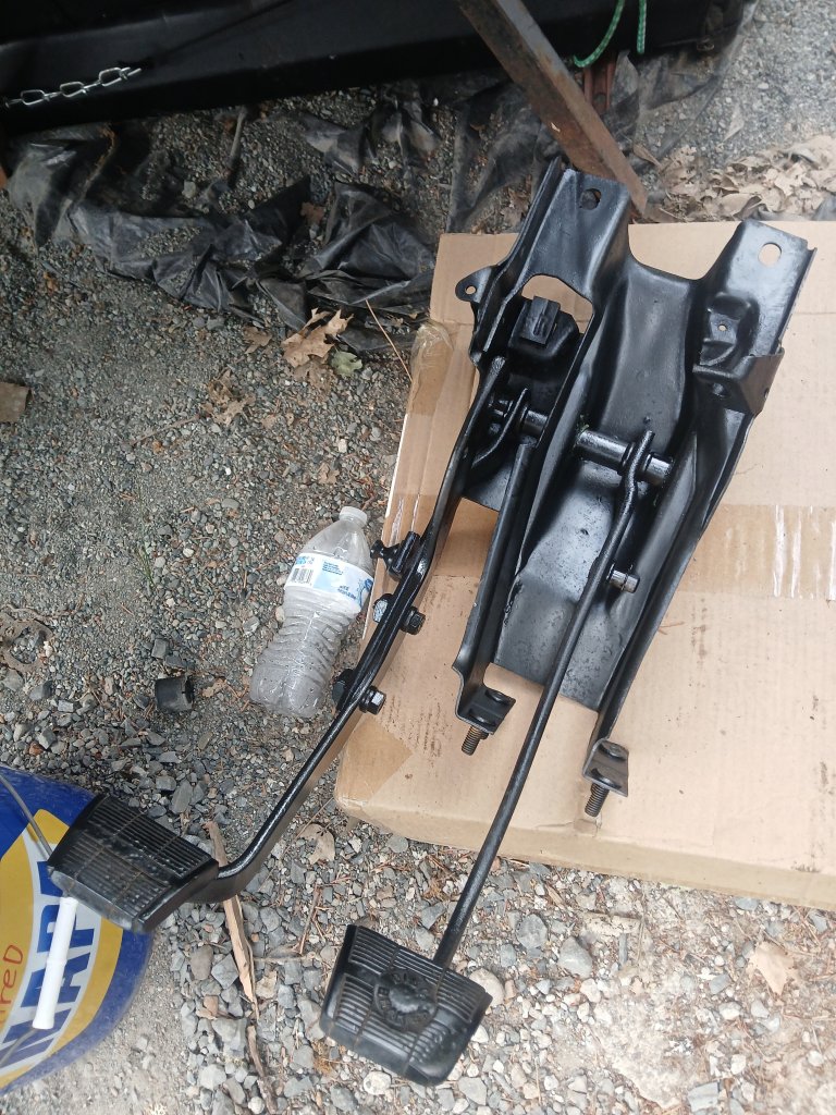

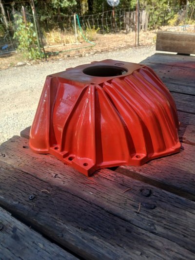

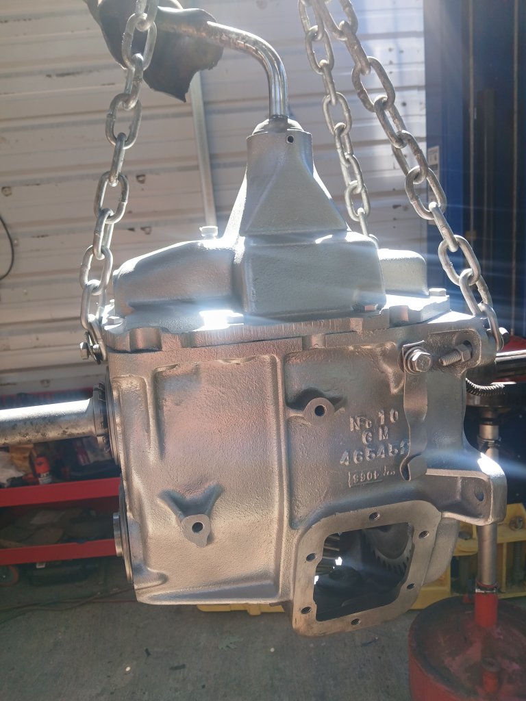

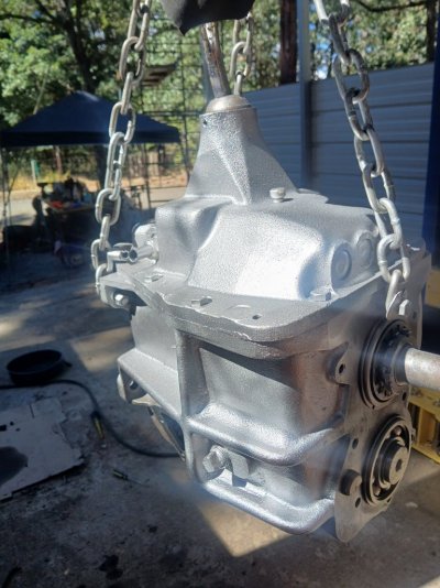

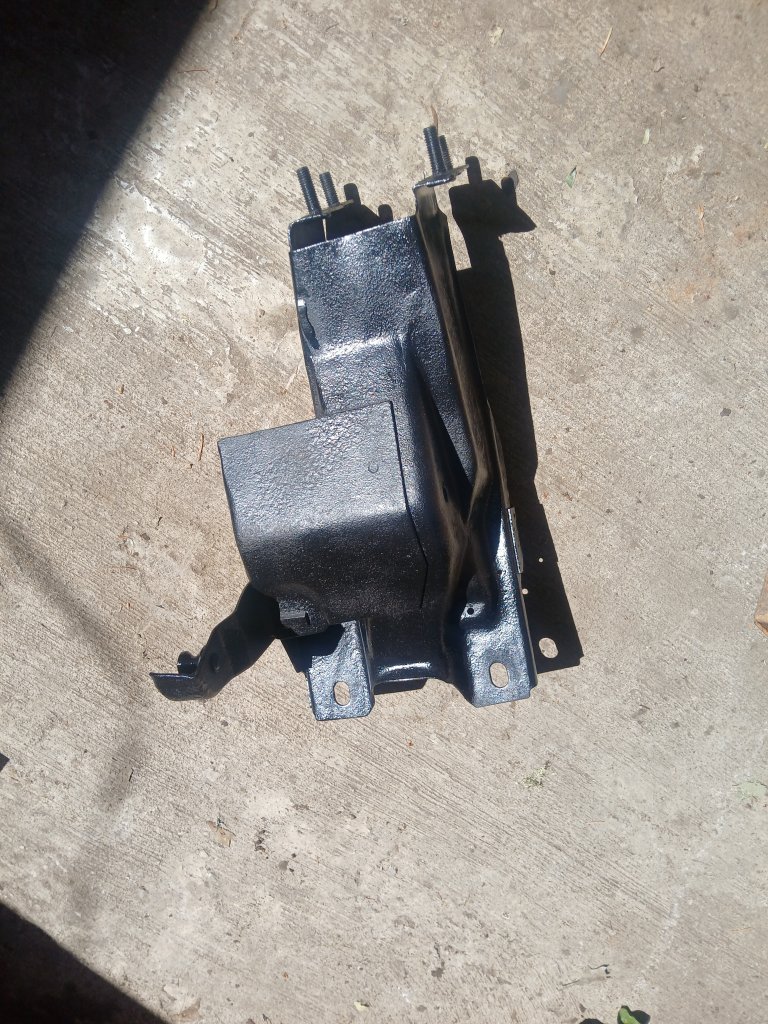

Been cleaning and painting today. Unbolted auto pedal assembly. Cleaned and painted new assembly. Cleaned and painted bell housing and transmission.

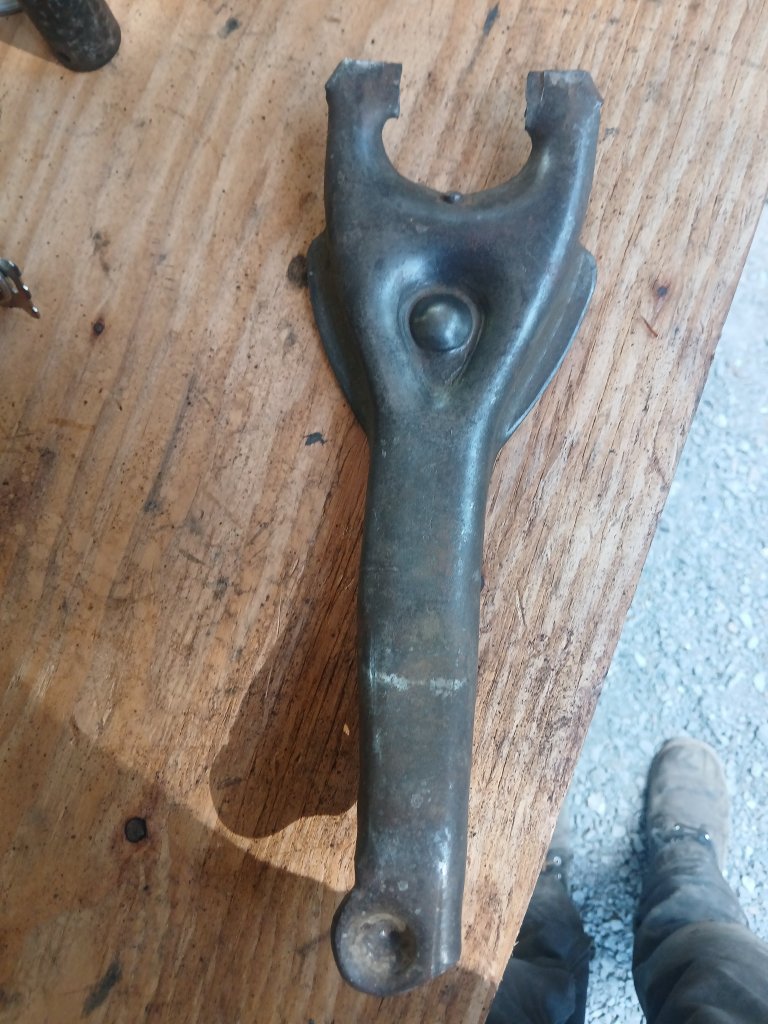

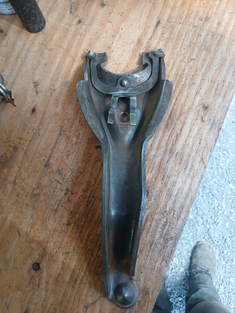

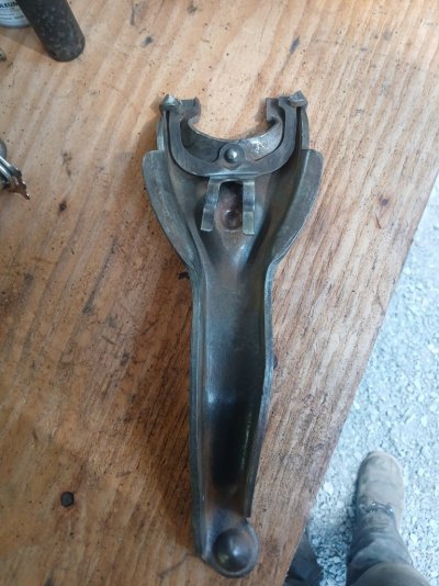

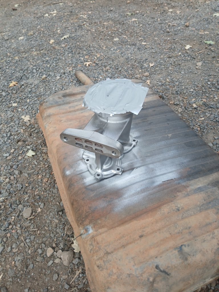

Does this fork look like the correct one?
Hopefully someone knows..

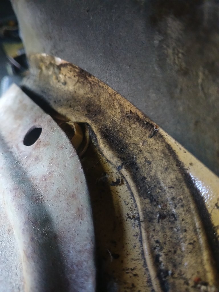

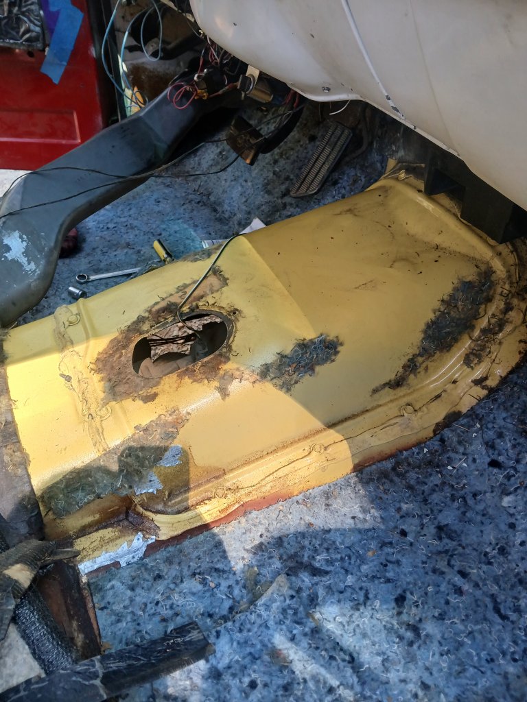

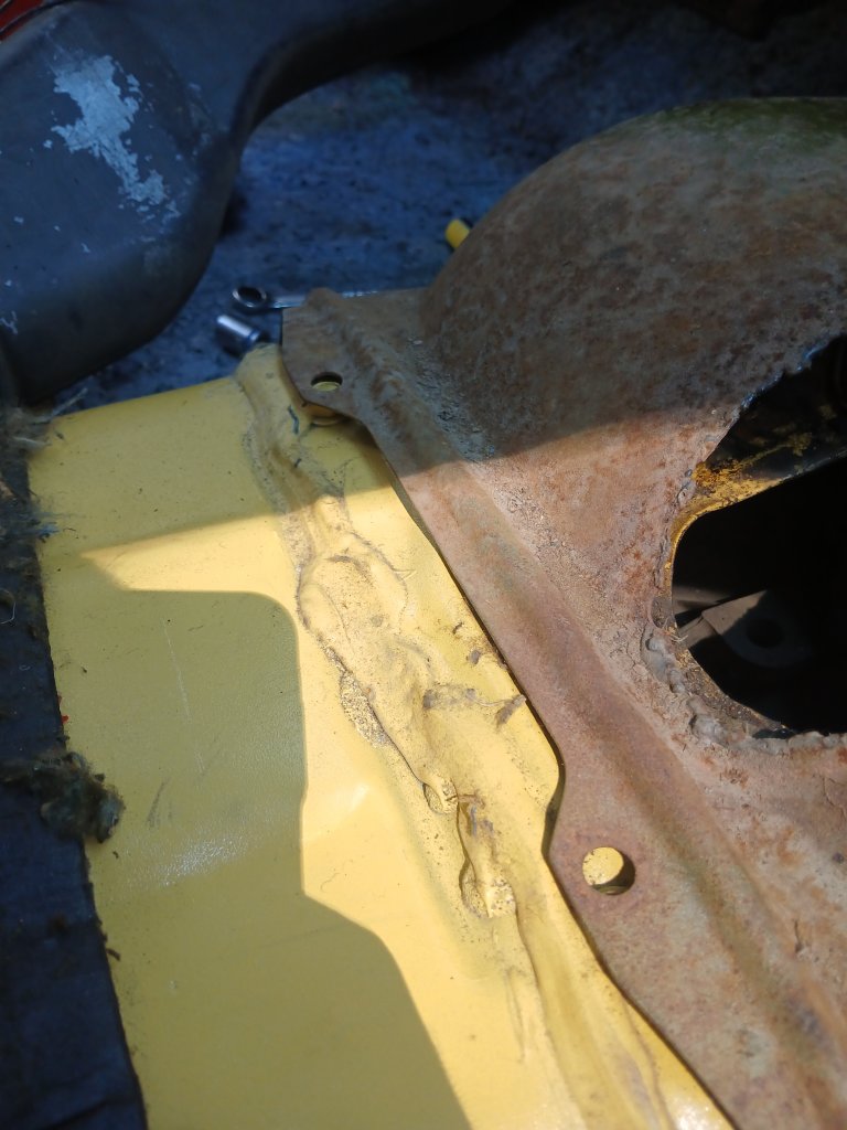

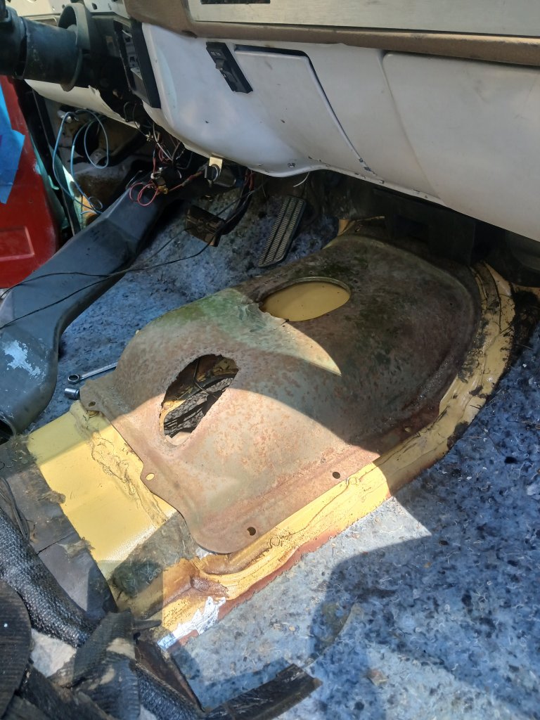

Got my template for hole mark. Its a little different and has history behind it, its a 1973 C20 low hump floor pan. My truck is a high hump but I think its perfect for marking the shifter hole. Im a little nervous because it doesn't totally align up but I think I got it close enough for a mark I'm hoping. Any thoughts?

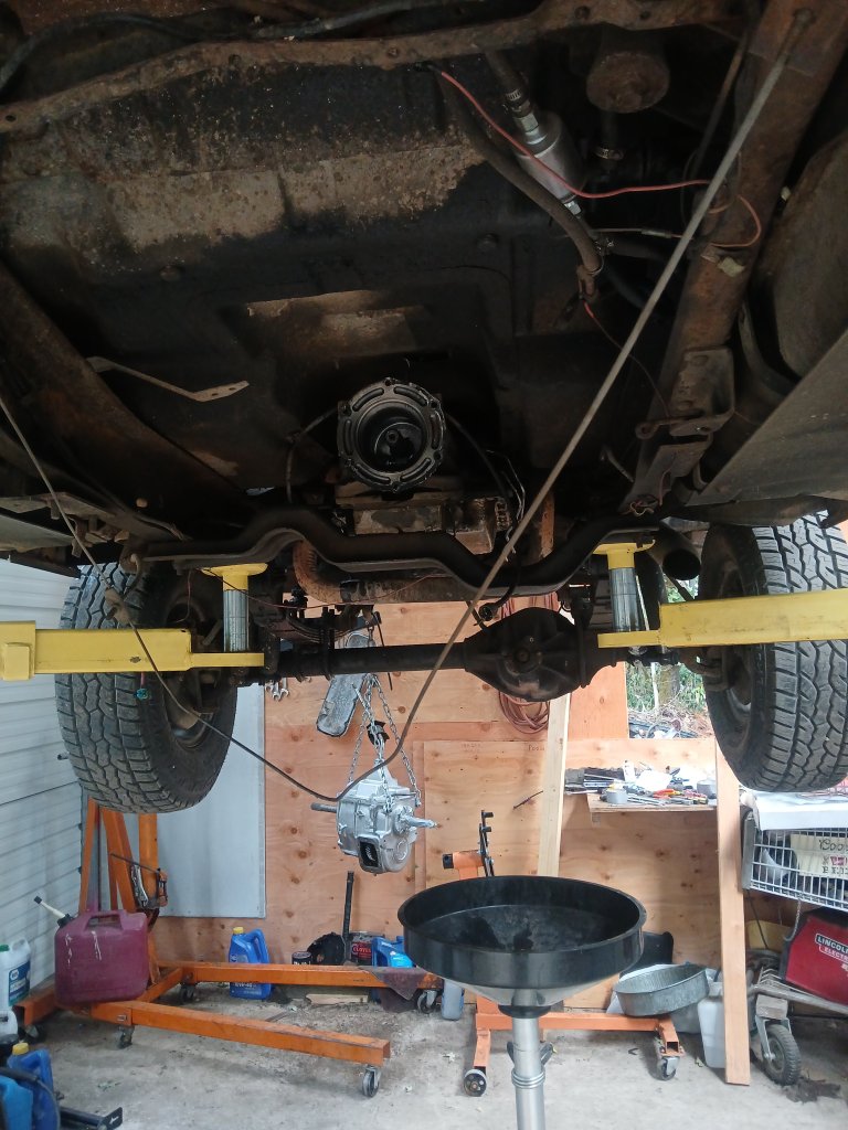

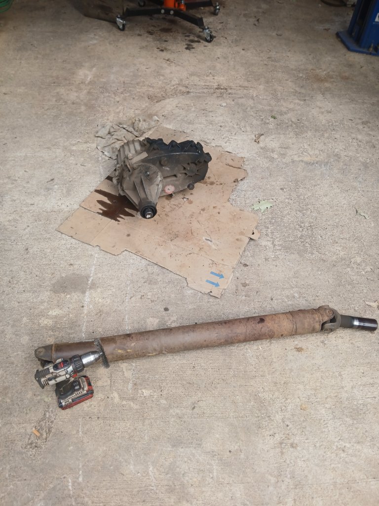

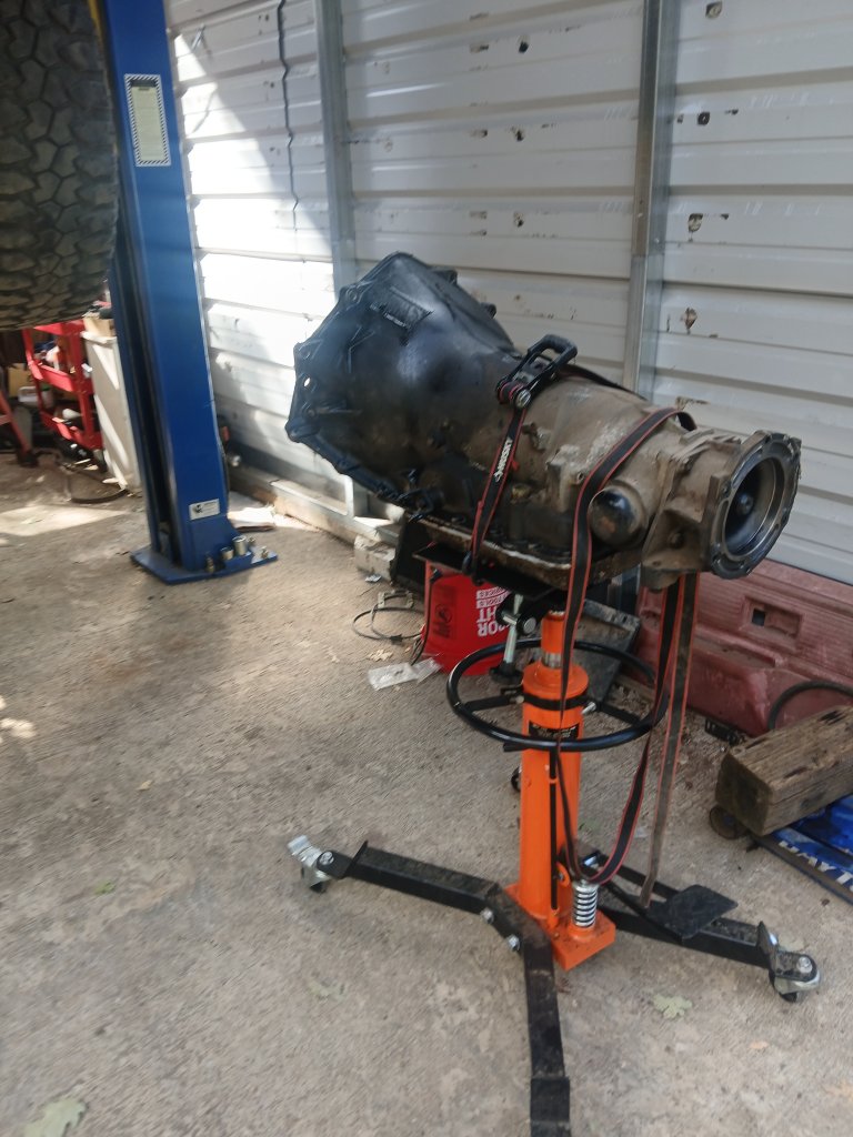

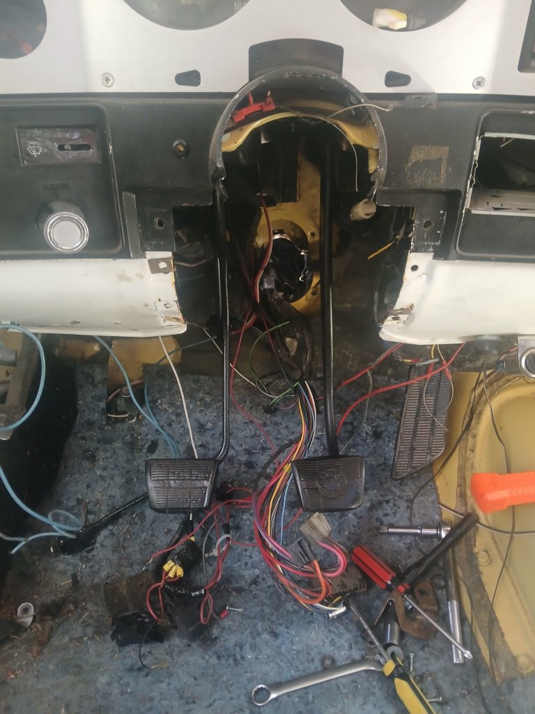

208 drained and on the ground. Torque converter bolts out. Finished most of the painting and got my pedals ready to go in. Onto R4 removal.

Let me know if you need a pedal assembly. Mine was swapped from manual to auto. I would trade you pedal assemblies.

Under that insulation is a cover which unbolts. Instead of cutting a hole, try to find the correct cover somewhere online.
squaredeal91
Mar 10, 2023
3,118
5,891
Cave junction Oregon
Greg bush
1991 SB
5.9 Cummins 12 valve
Somewhere i do have a somewhat correct cover in the way that its for a 4x4 manual but its for the 205/203 shifter hole. I need to modify existing either way and no room in budget or time to find one.
Besides its not a show truck, I'm okay with the modifications.

Brake pedal switch pushing bracket is different from auto to manual. Ill probably modify this one to work.
