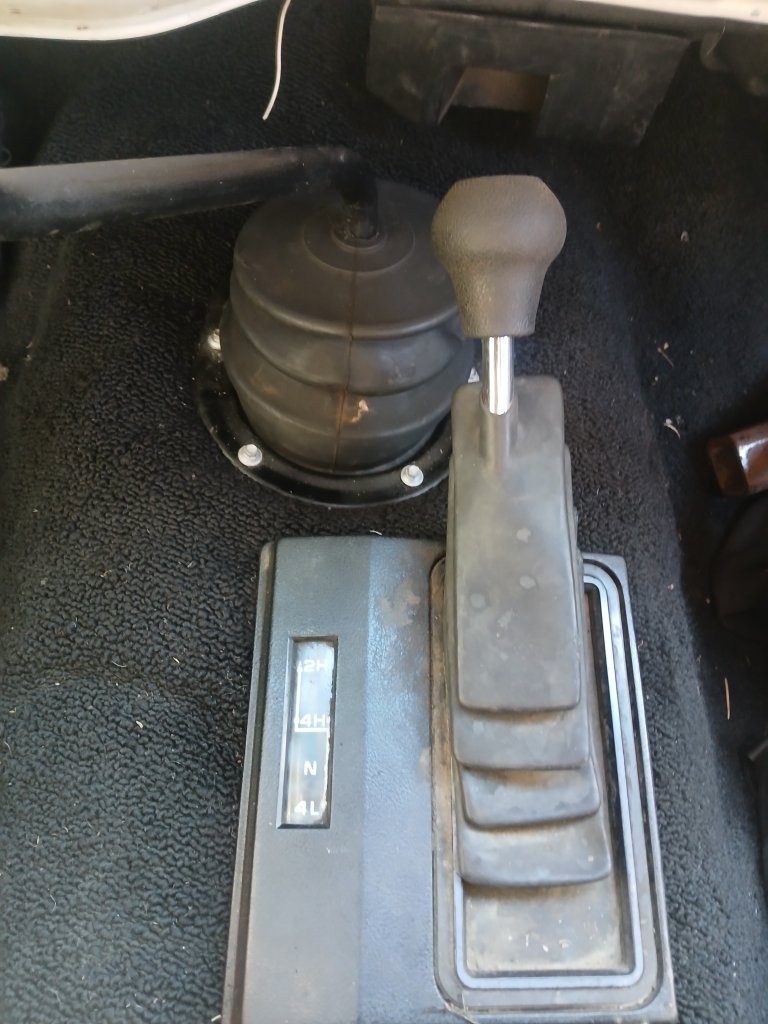

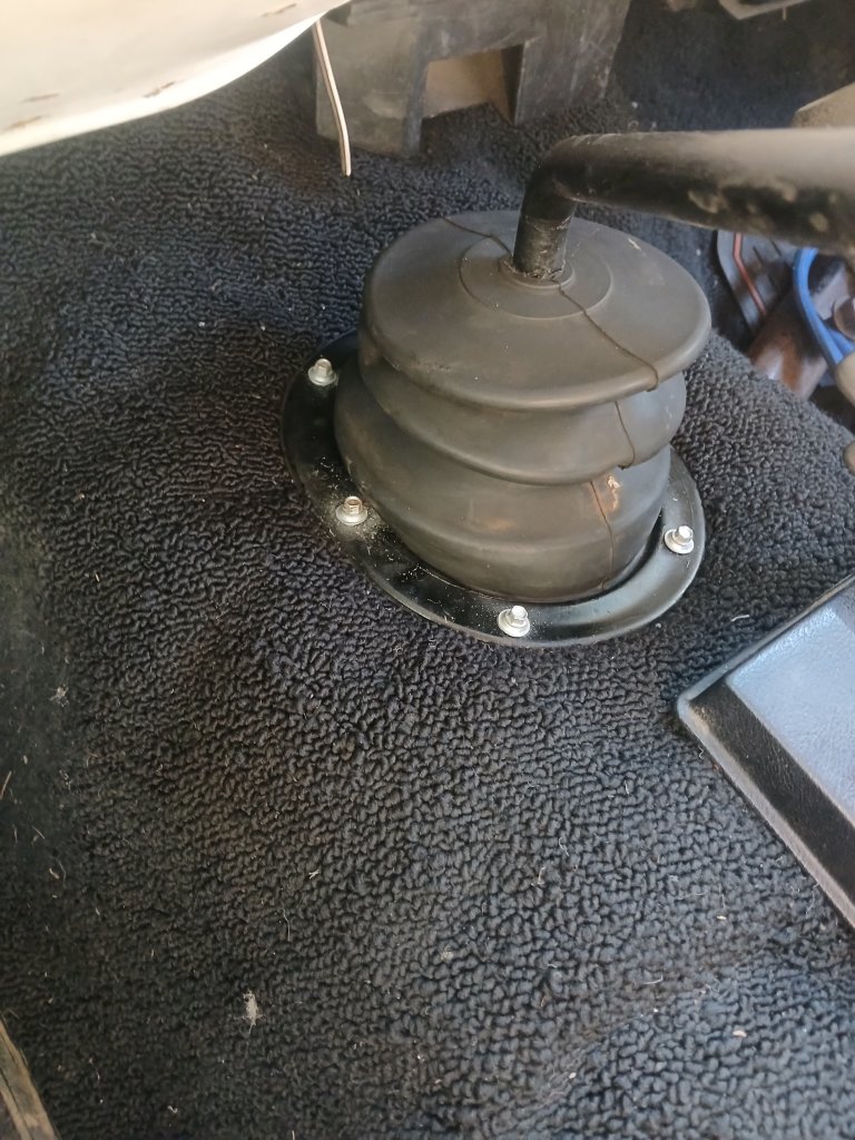

One more piece done. A friend brought over a good shift boot for me with a ring, he thought it was out of a 78 too lol. I cleaned it up and got it in. I packed it with some floor insulation I pulled from a 03 suburban and its so quiet down there now.
Oh yeah. How do I remove the shift knob on the transfer case shifter? I want to remove and clean that boot up too.
