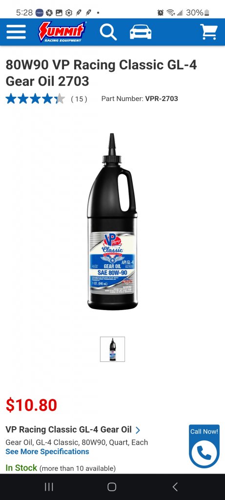

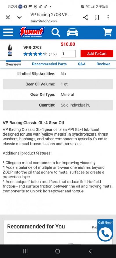

You are right some GL4 Gl5 will ruin your synchros. Summit sells 80/90 ,for brass syncros.

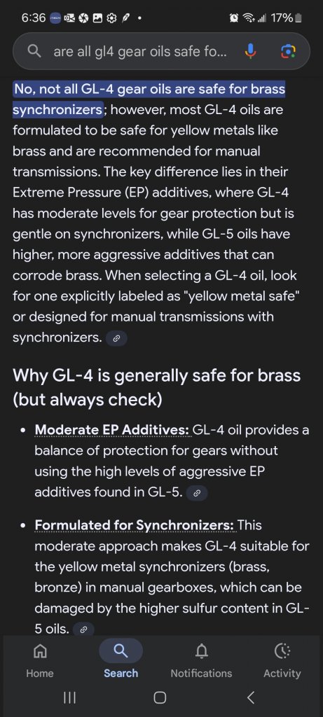

You want GL4 or GL1. Napa carries both. GL5 is no good.
10,167
19,654
