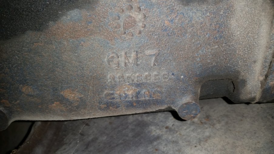

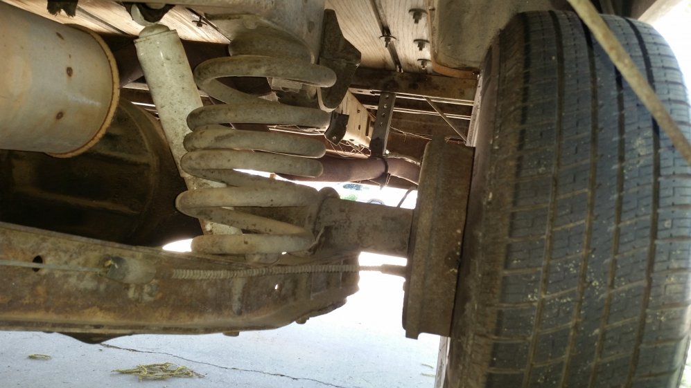

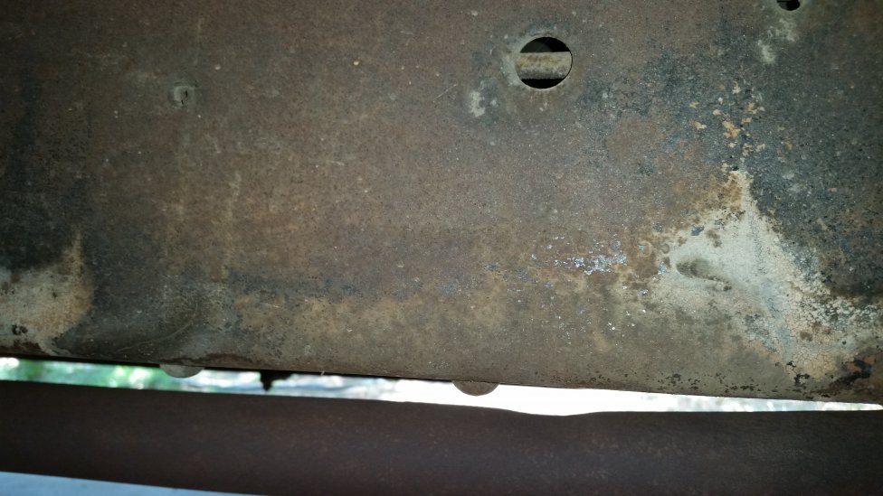

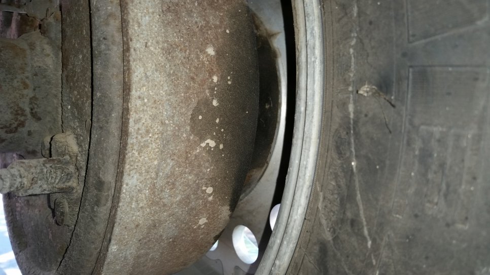

Here's some shots of the undercarriage...
It looks like they added wheel spacers. I need to take those off. That is probably why he claimed you could make it a dually with the wheels tucked under the bed. I knew it wasn't possible but let him tell the story. If the lug studs are the long ones I need to get some of those long lug nuts. I intend to swap over the wheels and tires from the '81 because those were bought for the '65 I was planning to build. That alone will drop the rpm's. That shot of the frame was supposed to capture the numbers stamped on the side. It looks like they didn't show up. But there is only minor rust under the truck.

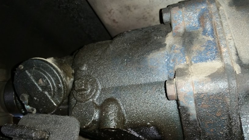

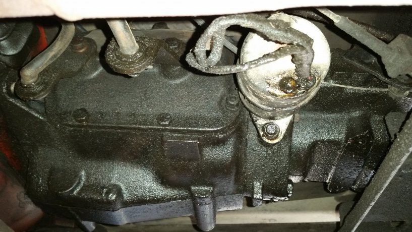

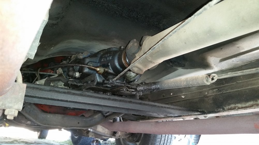

Here's some shots of the transmission and the attached overdrive unit...
As I was uploading photos I got a call from Gear Vendor's. I left a message with them Saturday afternoon in hopes they could help diagnose the problem that is causing the freewheeling with the OD unit disengaged. It sure is nice having overdrive, but that freewheeling crap has to go. Luckily with it engaged the truck acts normal, I just have to make sure I disengage it before coming to a stop and for sure before trying to back up because then you cannot get into reverse, and if you do you cannot move the truck period. Before I called GV on Saturday I turned off the truck with it in 1st gear and left the e-brake off, I was able to roll the truck forward no problem but it wouldn't go backwards.

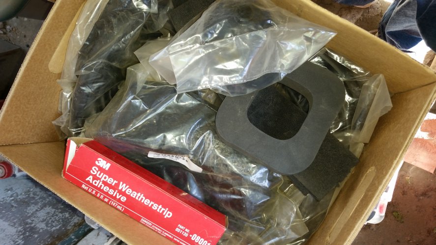

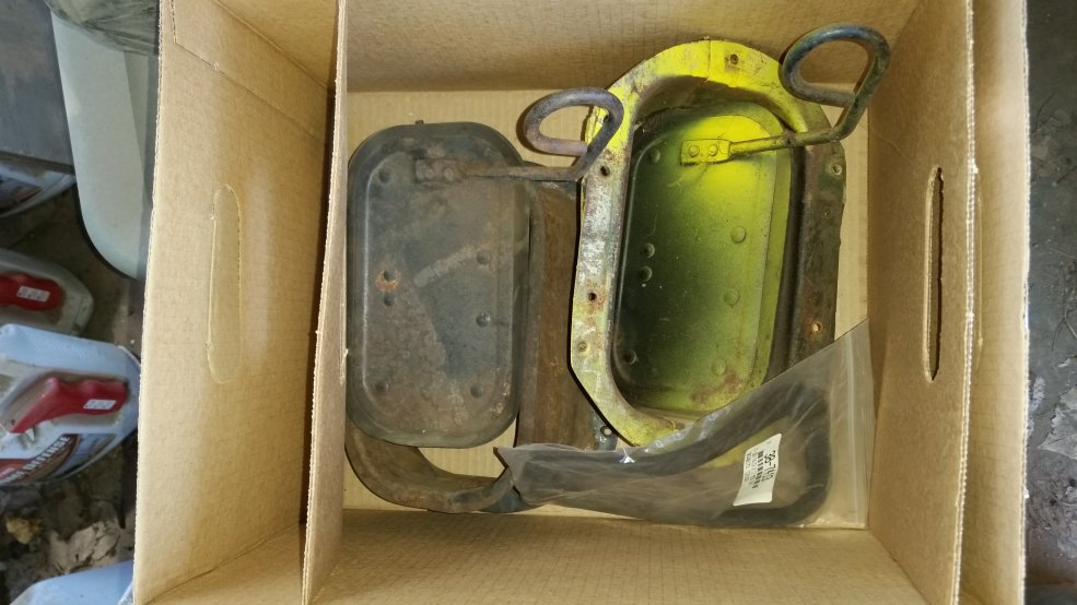

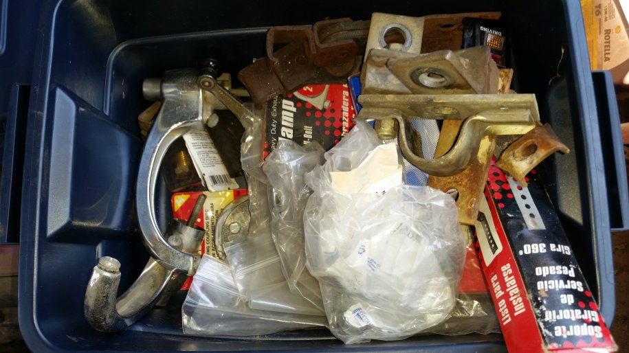

This next series of photos is the parts I have on hand for the truck....
I have seals, fender welting, weatherstripping; extra kickpanel vents and seals; and what is in that little blue bin....
I see extra door handles, front sway bar stuff, exhaust hangers and clamps, but let's dig deeper shall we...
