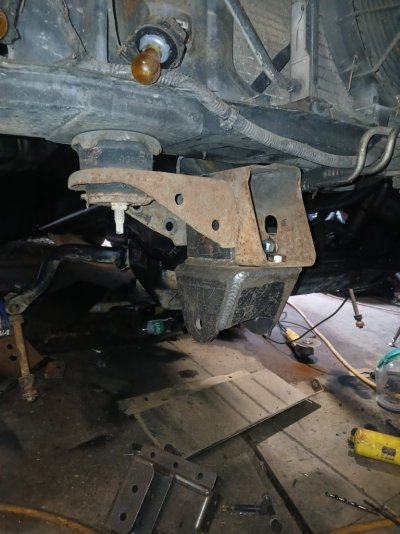

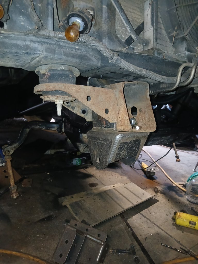

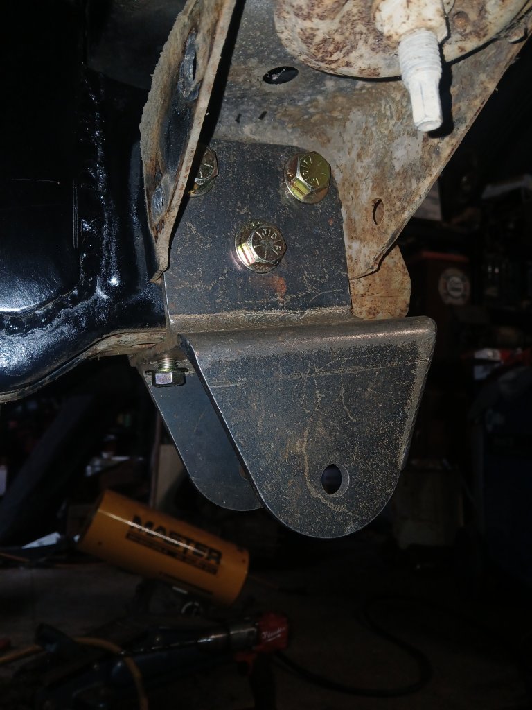

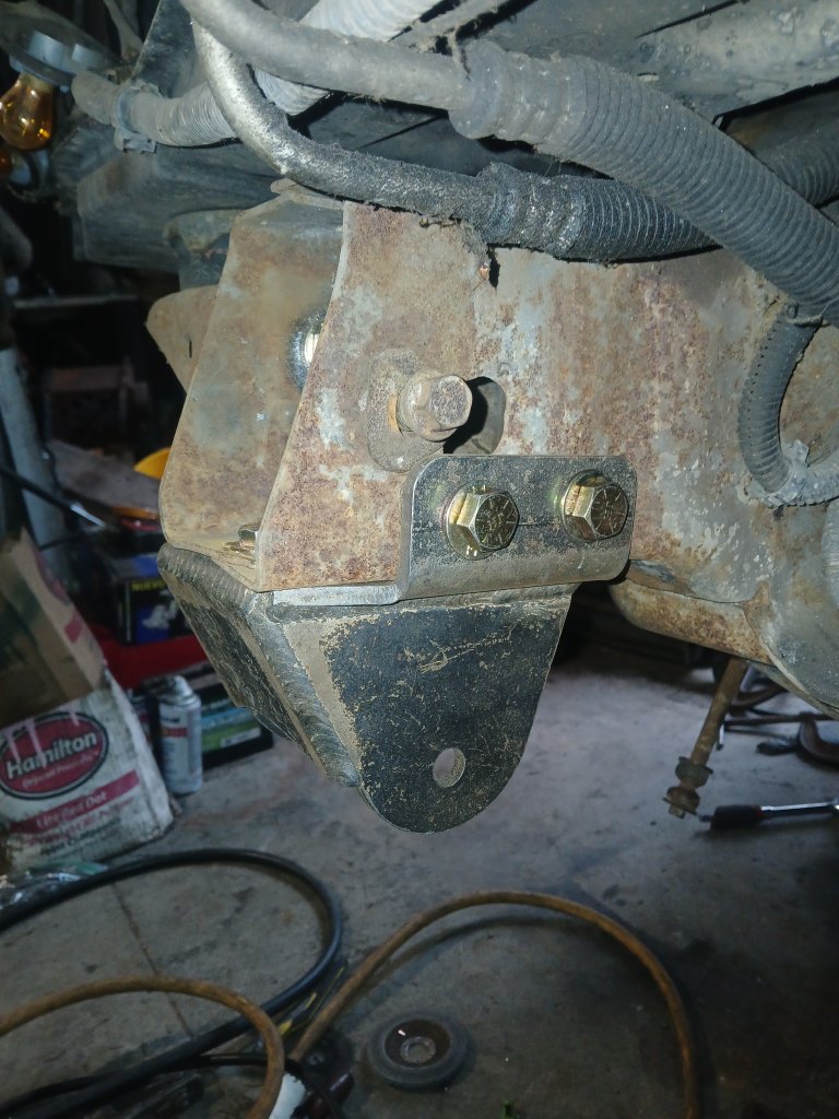

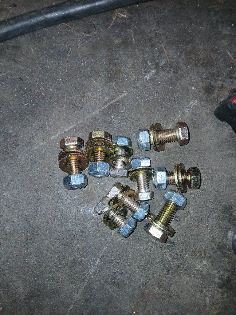

Got both front mounts on and drilled 3 holes for each side, pretty easy. Each bracket uses 9 bolts to mount it. (4) 7/16"bolts and (5) 1/2" bolts.
The rears have to be measured and then set and all of those holes have to be drilled out im pretty sure.
