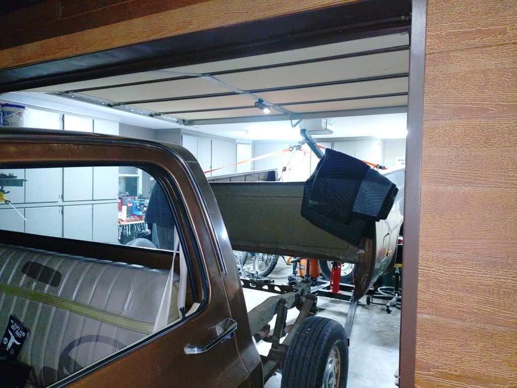

Here's a little progress. Not bad for a 1 man band and a wrench.
Funnily enough, that is exactly why I had Lisa order me an engine hoist… So much easier than buying a keg and 4 or 5 pizzas and lining up a few helpers…
Need to pull the bed on the 85 C10 so I can wrap up the flip-notch-reinforce at the back half. Plan is to box it in, friend is a dual certified FAA/USCG welder with a 3 phase rig.

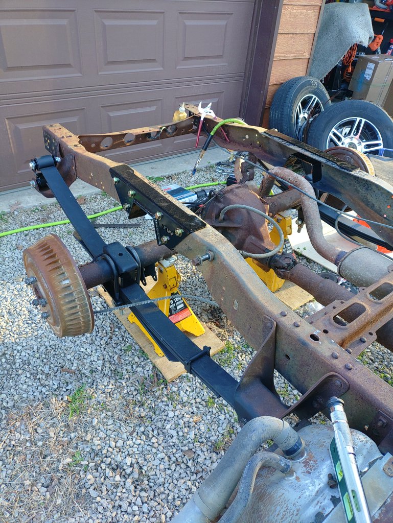

Notches complete. Still uncertain about welding them in.
The only reason i would weld in is to seal them from getting water behind and being a trap for rust, but seeing you have jusst bolted the over a surface rust frame i guess your location isnt that damp/rusty.
