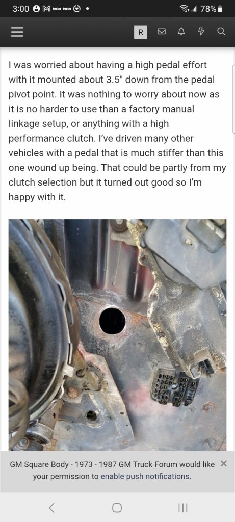

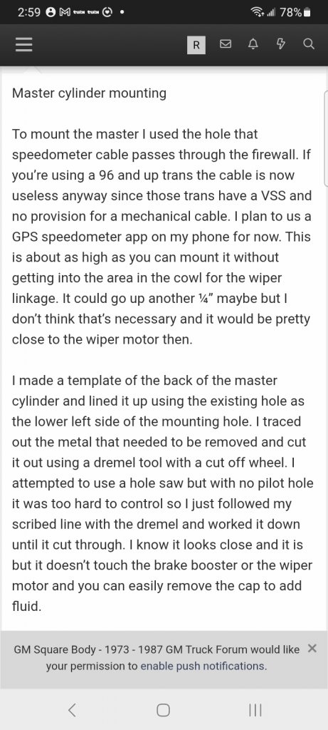

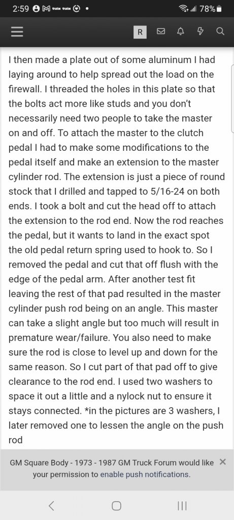

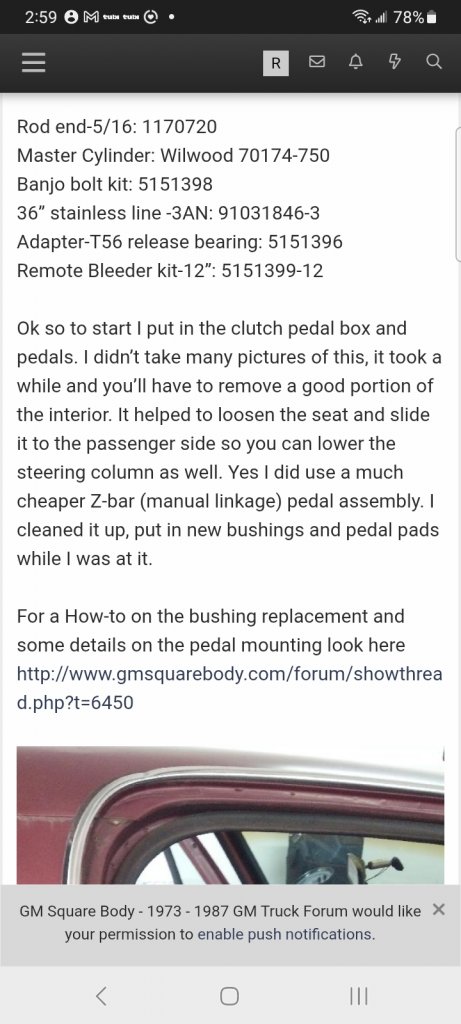

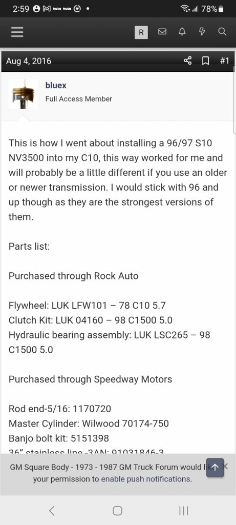

I believe it would help to simply have the hydraulic pedals installed and then try to find where to put the hole for master cylinder.
I have a truck with hydraulic clutch so if you need reference pictures id probably be able to help that way. Also You can probably modify the existing pedal to work more like the hydraulic pedal. I think I have an extra pedal setup that can be referenced too.
When you said you have a truck with a hydro clutch was it by chance a 87 or whatever ? I ordered a master cylinder for a 87 c10 and its got this weird angled flange on it , no sure how thats supposed to mount flush to a firewall... I was hoping maybe someone had some pics, because otherwise im chopping the flange off and going to weld on another flange that'll flat mount it.
