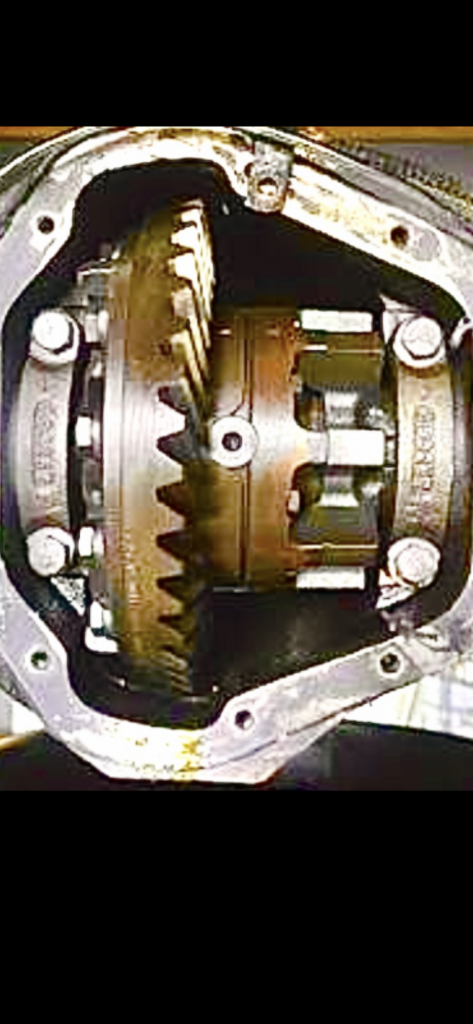

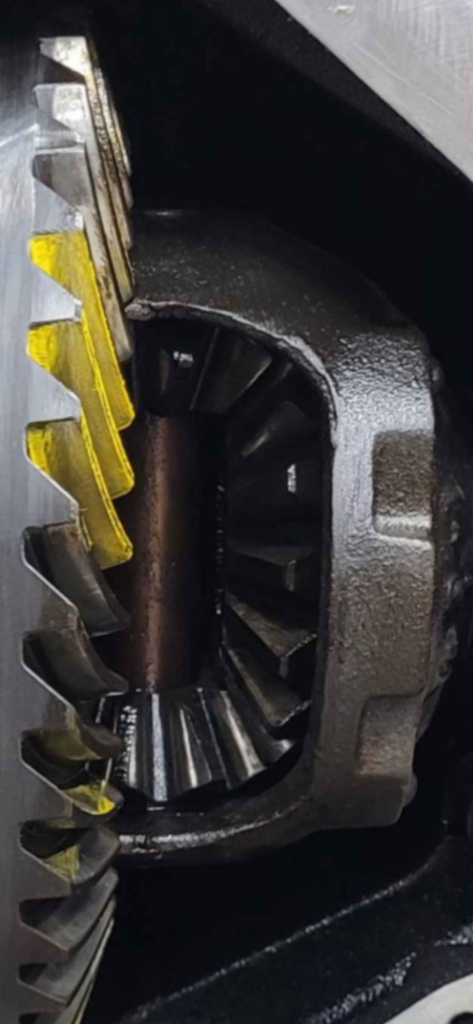

truck- Frankensteined 79 k3500 dually. no bom on rear axle housing...Ive cleaned to the white meat on both tubes 360 degrees. 3.73 ratio 35 spline. 70HD in fwd web casting, C37453 casting opposite side, B149..maybe 140 at bottom, have no idea if this is relevant for a data miner but there it is......the carrier is a 4 pinion 2 piece carrier standard. 4 spiders stacked on a cross shaft that is open in the middle. side gears and spiders only have thrust washers behind them(not a power lok stack). *****can i replace my side gears with the side gears available on the market for the 1 piece carrier assy?**** can not find any interchange info much less a PN.
only place i can find my 4 pinion 2-piece carrier is in an old dana pdf on billavista.com file x510-9. If standard 1 piece carrier 70hd side gears wont work, what are my options outside of axle swap due to lack of part support for this config?
Let me go ahead and thank ANY one that responds to this with insight. My hat is tipped to your knowledge and obvious years of experience in dana parts identification and interpretation.

It’s been my understanding that the older 2-piece 4-pinion open D70 case was replaced with the lesser 1-piece 2-pinion case in 1975 ( with the exception of anything that had a NoSpin equipped in it ) - has your ‘79 been replaced ?
I cannot confirm that the side gears will interchange between a 2-piece and 1-piece case but it seems logical that they would.
And if they do it might be worth looking at a set of D60 side gears as well for more options - in some diffs between D60/70/80 certain spider and side gears share the same dimensions ( for example: the internals of the P/L diffs will interchange between the three models - maybe the open diffs are similar in sharing components ).
I never researched the open diff stuff though so I can’t confirm that it will work but it’s worth looking into to possibly give more options of availability.
I know this doesn’t directly answer your question but maybe it will help in your search for finding parts that will work.

posting this in case someone else runs into a 4 pinion 2-piece standard open carrier. this will not work *706058X DANA 70 SPIDER GEAR KIT 706058X 35 SPL NON POSI REAR END. not even close. basing off the old spicer pdf i found, sticking to the 2-piece open carrier option and gear ratio i can get 2 possible bom's, both are dual wheel. 603354-5 and 603476-5. one is a mh one is a c20. places ive called so far just say we dont carry that for the hd....only kit listed that doesnt fit. anyone got a good diff place that can tell you..hey yeah get this....or hey yeah you need to go buy a 14 bolt

What is it that you’re saying won’t work? Is that a spider gear kit?
I realize it could be a little harsh for some people in a dually but if you want to keep the 2 piece carrier you could put a locker in it (for that type of carrier it’s a drop in like those for a 14ff)

yes the open 1 piece carrier spider kit will not fit the 2 piece carrier. what is this blck magic you speak of ***(for that type of carrier it’s a drop in like those for a 14ff)***
my carrier is different from a 2 piece carrier for the power lok. my holes arent ramped at the cross shaft. this is my first diff disection so go esy on me for my ignorance

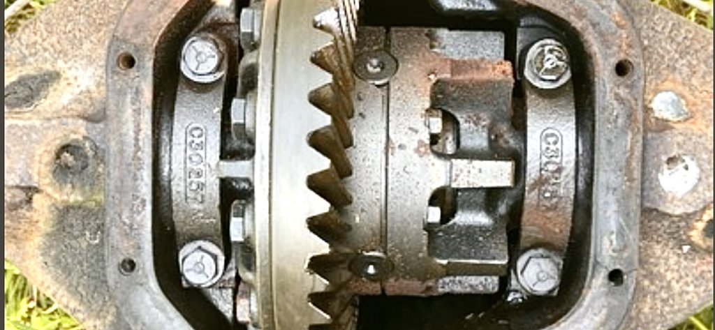

He’s talking about the Dana 2-piece open carrier ( not the P/L ) that accepts the internals of a D/L just like a 14Bolt FF diff does.
Look at the case in the picture below - it is solid round not ramped like a P/L differential.
There are different sizes of the cross pinions used in a Dana 70 2-piece carrier 1” and a later smaller 15/16” version.
I understand that a lot of places get the P/L and 2-piece carrier mixed up but that’s not the case here - listen to what he’s telling you and you’ll find a solution that gives you a traction differential instead of an open rear differential.

Question - are you just comparing the group numbers from the 1-piece case v/s the 2-piece cases?
If so there’s no doubt it shows differently.
You’ll have to compare each side gear physically and not as a group series numbers from a parts breakdown.
Anyway, if your motor is that strong it sounds like you need a better diff than an open carrier anyways - go for the locker.

here's the carrier from my 78 Dually crew cab long bed 2WD. 4:10 70HD, I just stuck a Yukon posi traction unit in mine so this is doing nothing, if you find a way that doesn't involve me spending money you can have it. I'm in Baton Rouge for shipping viability. if it's the correct one

so ive nearly exhausted this route as well. been told the open carrier sides from a front 60 diff would fit my 2-piece. seems unlikely. my sides are only 3.75w x 1.52 tall. 6 gears in a nest vs 4. thats kinda small. 70 1 piece opens are 1/3 again larger. open 60 i would imagine is bigger wider and deeper than the 2 piece but i dont have a 60 front side to measure. again....i think some of my sources are automatically thinking power lok when i say 2 piece and think im just ignorant when i say it is open. bout ready to take the Winfred deal and quit trying to re-invent the rotating group. dont have enough resources to figure out stacks that will fit in this antique carrier.

If his 1-piece is from an HD 70 ( that’s what yours should be ) with the wider carrier bearing journal dimensions it will drop right in - both designs fit in the same hole.
alright winfred. lets do the deal. ill be happy to compensate you outside of shipping the carrier. drop a message and we can work out the details. i greatly appreciate the offer. atleast with the 1 piece ill have options down the road.
