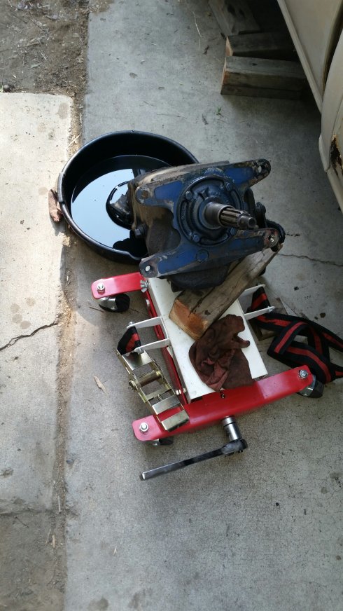

Yesterday I finally got the OD trans out. Now that the cross member is a bolt-in member, it will make pulling the transmission in the future much easier. I'll post up pics tomorrow, not at work today. Cracked myself in the nose when prying on the cross member to get the last rivet loose. Hitting the member with a hammer wasn't successful like the other three were, so I was using a pry bar and my face just happened to be in the way...lol...
14,032
24,154
I had tried and tried to get that dang fourth rivet to pop out but it just wouldn't budge. And a regular pry bar didn't get enough leverage to pop it, BUT a carpenter's pry bar with 90* bend in it sure did. Except the leverage was greater pulling then pushing, so when the rivet decided to give way...POP...my hands and pry bar came crashing into my nose. Went in to see if it was broke, not broke, so went back to it. It's always something when working on these trucks...:Insane:

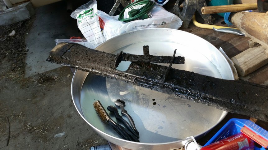

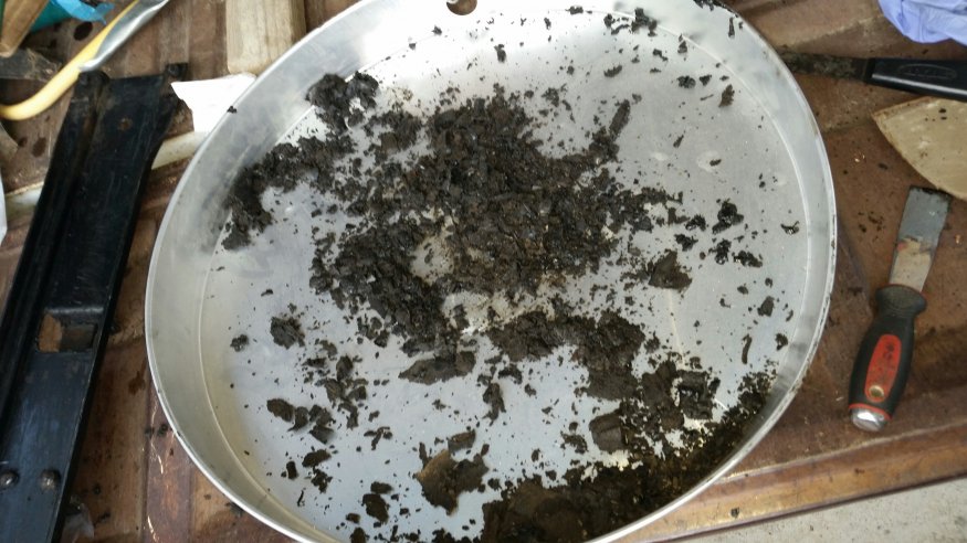

After getting the OD trans out I let piss in the oil pan before taking a picture of it on the tailgate. I am still amazed that it took Saturday and most of Sunday to finally get that damn thing out. Had I known it wouldn't go back far enough with the cross member there, I would have buzzed off the rivets first to remove it. With the transmission bolted to the bellhousing it slides on the frame nice and easy. But with the transmission detached it was a bitch. Oh well, live and learn, and I made my life much easier whenever I need to replace the clutch.
Look at the gunk piled on that cross member! And then the pile in the pan after scraping it down!! The picture doesn't really show how much there was, but you get the idea. The cross member is now cleaned and painted. Didn't get pics of that, but it is really clean under there with all the other greasy pieces. I need a good pressure washer to clean it down.

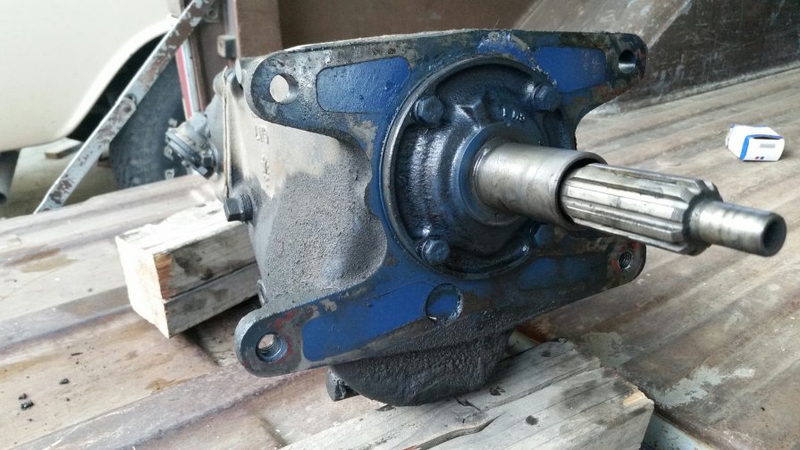

Got the non-OD-trans installed and brought the truck to work today. Test drove it after getting the rearend filled with gear oil. Too much happened last week for me to finish it, so it got done as the final item last night to get the truck back on the road. It's funny because there was a lady pacing outside the church for about an hour while I was finishing up the truck, and when I got the truck running I drove over there to do figure eights in the parking lot to get the new oil into the posi-unit, she watched me and then decided to go inside. Must have freaked her out...lol... Since I had the rear wheels in the air during the final stages of getting it going, I decided to rotate ring gear to clean it off some more, snapped a shot of the numbers stamped onto it 32/7=4.5714(4:57). So I confirmed my rear gear ratio. And the ring gear was made 1961!
This non-OD transmission definitely has different gears in it. It makes driving the truck much nicer, but it wouldn't be good for doing truck stuff because the 1st gear isn't as low. It is nice not hearing the trans bearings in the transmission screaming.
The OD-trans is definitely in dire need of a rebuild. Rotating the input shaft you can hear and feel the bearings are shot. Shifting into reverse it won't go into gear, so the only way it was staying in reverse while in the truck was because of the linkage. And the reverse/1st gear shift lever slides into the side cover. I may need to use the side cover from this non-OD-trans when we rebuild it. I'm hoping this OD-trans doesn't have gears shot. When I clean it up I am going to pull the side cover just to get a peek inside before we rebuild it.

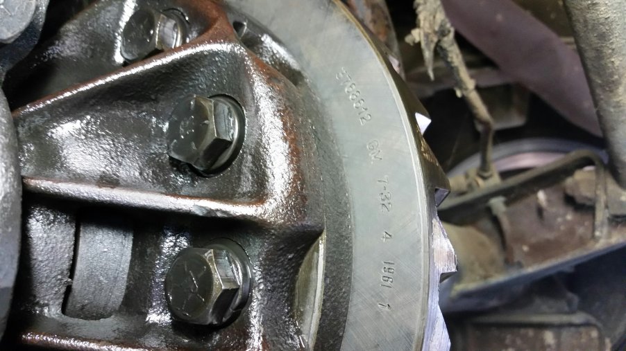

Yep, you got the ever so common drop out 3rd member GM Corp axle. Only 2 gear ratios for that rear end. 4.56's and 4.10's. Good Luck finding 4.10's though unless you buy them. Of all the 3/4 1 tons in those years I played with up through 68, all had 4.56's. I found a diamond in a goats ass 1 time out an old 69 ambulance that had 4.10's. I swapped it into my dad's 68 for the 4.56's. Every little bit helped.
14,032
24,154
Yeah Mean Green had the 4:57's until I found a '68 Dana 60 that had 3:54's, man what a difference that made. Cruising at 70 was no longer 3,800 rpm's, it was 2,600. The truck was much more fun to drive after that. Out of curiosity I am going to pop the cover on the parts truck rearend to see what ratio it has. If it has 4:10's I can swap that axle in when I change the rear control arms. I still have the Dana 60, but with the Borg Warner OD the rpm's would drop too much, it would make it a 2:47 engaged. Even 4:10's would drop to 2:87's with the Borg Warner OD engaged, the 4:57's drop to 3:19's with it engaged.
