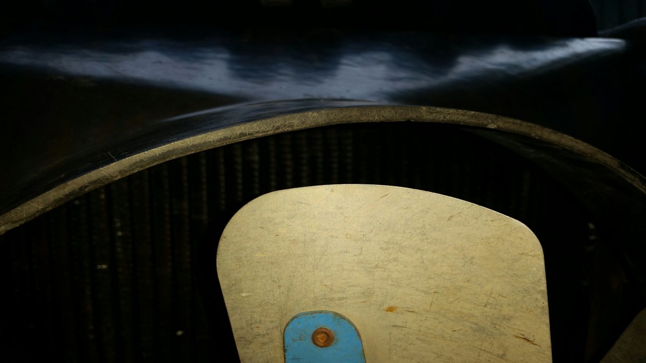

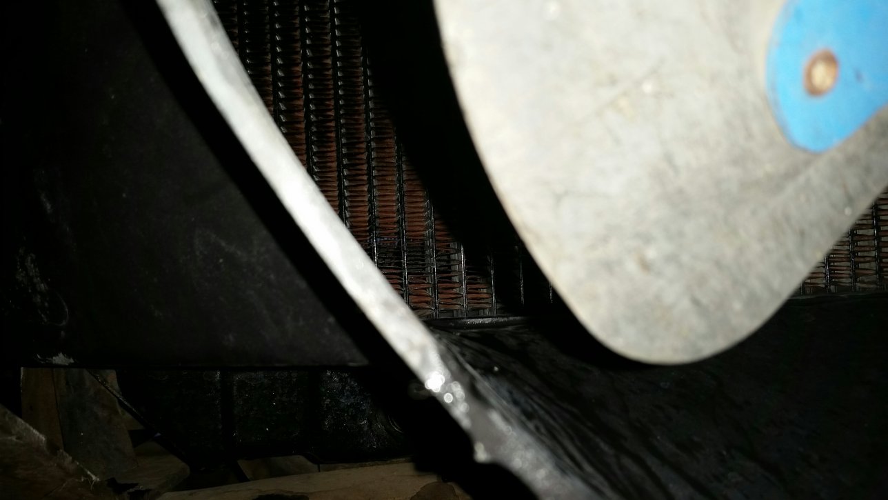

Got the fan to shroud clearance dialed in and now I don't have to worry about the fan hitting it and I can replace belts without having to remove the fan and shroud. As yo can see in the photo of the temp gauge the truck runs cool while idling, 45 minutes of idling when the pic was taken. Driving to work this morning the gauge began to climb but not as bad as it did the days before.

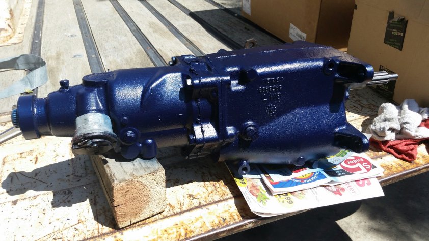

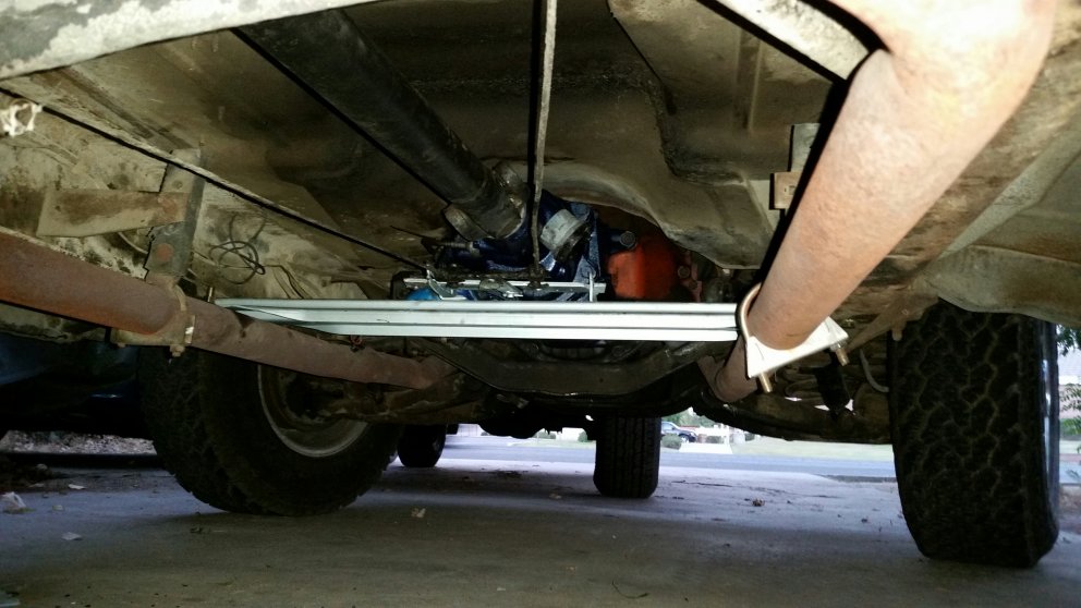

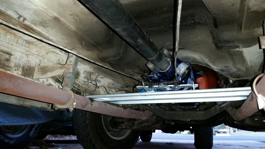

Sunday I got a late start but got the rebuilt tranny installed. Except the driveline won't slip past the tailshaft bushing. Will have to deal with that after work tonight.

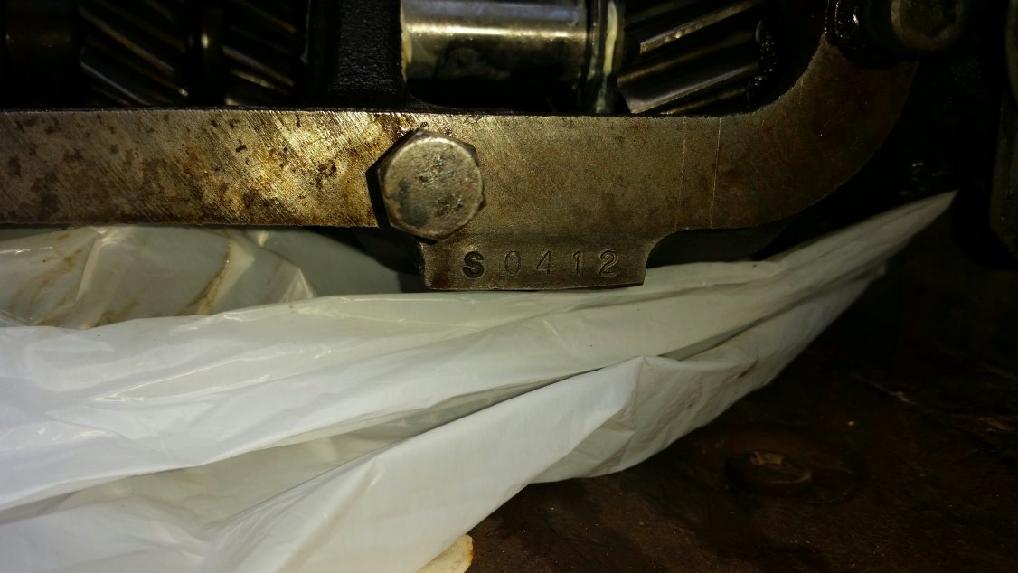

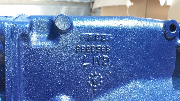

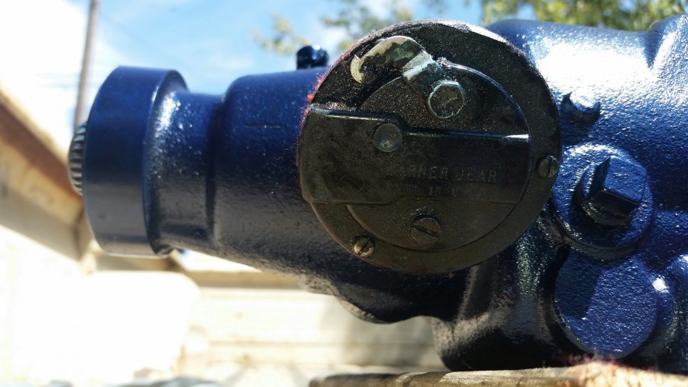

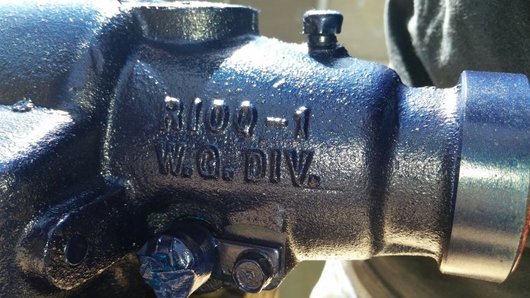

Here's some pics of the rebuilt tranny with some fresh paint applied and one of the date code before being painted. According to the date code it's a Saginaw built on April 12th. The OD unit is an R10Q-1, I've read the R11 unit is stronger, but I am not complaining about this one. The Governor wasn't hooked up when I got the truck, and I'm not sure if I will rewire the OD system to work like it's supposed to from the factory. I can see the benefit of having it like that, but now that I know how to drive with it, I don't mind it like it is.

Took off an hour early from work yesterday to tackle the driveline installation. First attempt to tap it in resulted in it getting stuck and I almost couldn't get it out. So I took some emery cloth and shaved a little material from the yoke. There was some light surface rust too, so I got that removed. I didn't get a photo of it, but the first 1/2 inch of the splines of the yoke were boogered up, so I took my saw sharpening file to them and got them smoothed out. Applied a good thin coat of lithium grease to the splines and the yoke, and proceeded to tap in the driveline, and then took a small prybar and twisted the driveline back and forth, tapped it in a little more, twisted, tapped, twisted, and after about another 45 minutes I finally got it installed. Replacing the tailshaft bushing with the transmission rebuild, the yoke didn't want to slide in. I either pressed the bushing into the tailshaft, or I got it freed up enough to accept the yoke. Hopefully I just freed it up, I really don't want to replace the bushing again, mainly because I don't want to fight the overdrive again. Tonight I will button up the rest of it and test drive it.

But last night I got the transmission working properly, saw the rear u-joint wasn't seated in the cup of the yoke, fixed that, double-checked the center bearing and it's shot because of the first run with it and not knowing the factory driveline would hit it without it being properly bolted in. I'll get a pic of that so you can see what I'm talking about.

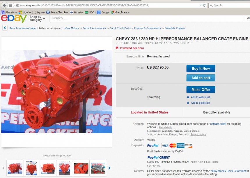

Was bored so I did a quick search on "283 engine for sale"...look at that beauty!!! :hump: I doubt I could rebuild the one from the parts truck for $2,200. Just don't have that kind of money right now. :shrug: It sure would be cool to have a 283 in the truck though. :popcorn:

Well @HotRodPC, I took a closer look at the 283 I have from the parts truck, and there are little pyramids cast into the heads. From what I've researched, those are Power Pack heads, and from what I gather those are like a very early vortec-type head designed for high velocity to get the small 283's revving up to move the big cars and trucks back in the day. I think I need to tear this engine apart and get it cleaned up for a rebuild. A nice running 283 pushing 220 ponies would be nice and gas mileage would be better too.
