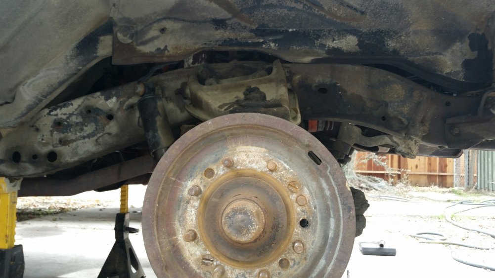

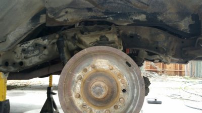

I have started the disc brake conversion. Unfortunately the ball joints are going to be a bear to pop loose. I spent 6 hours beating on the driver's side one on Sunday and it never popped. Used heat, penetrating oil, you name it, I used every trick I've learned through the years to no avail. Got some items to make a spreader tool that goes between them, that should help.
While under there I noticed the cab mounts are almost completely gone. They're to the point of no return and the cab is almost riding on the frame, so I am buying some c10 rear cab-to-frame mounts so I can switch out the c20 shear style mounts and add the donut style mounts instead. Just waiting for a place in Kansas to call me back so I can place the order. Those mounts are in the LMC catalog, but they're not selling them, and removing it from the catalog according to someone that works there. Funny thing is, the place I'm getting them from said LMC gets them from them. Oh well, I would rather go directly to the source.
Once I get further along on the disc brake conversion I'll post some photos, the ones i have thus far are not that great, just a rusty-dirty drum brake suspension setup.

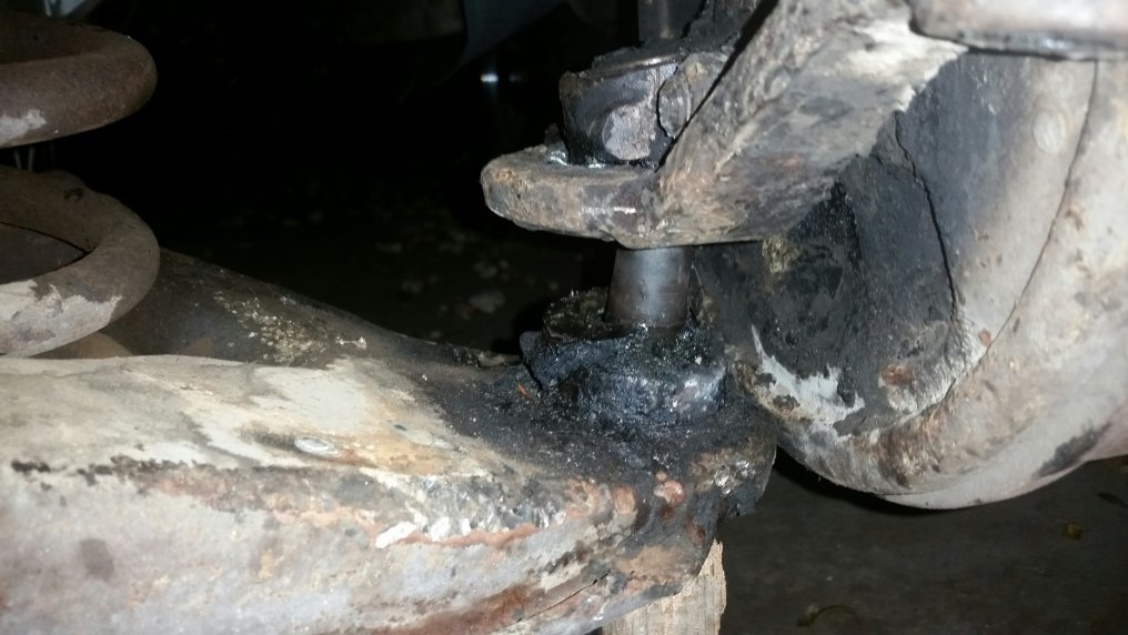

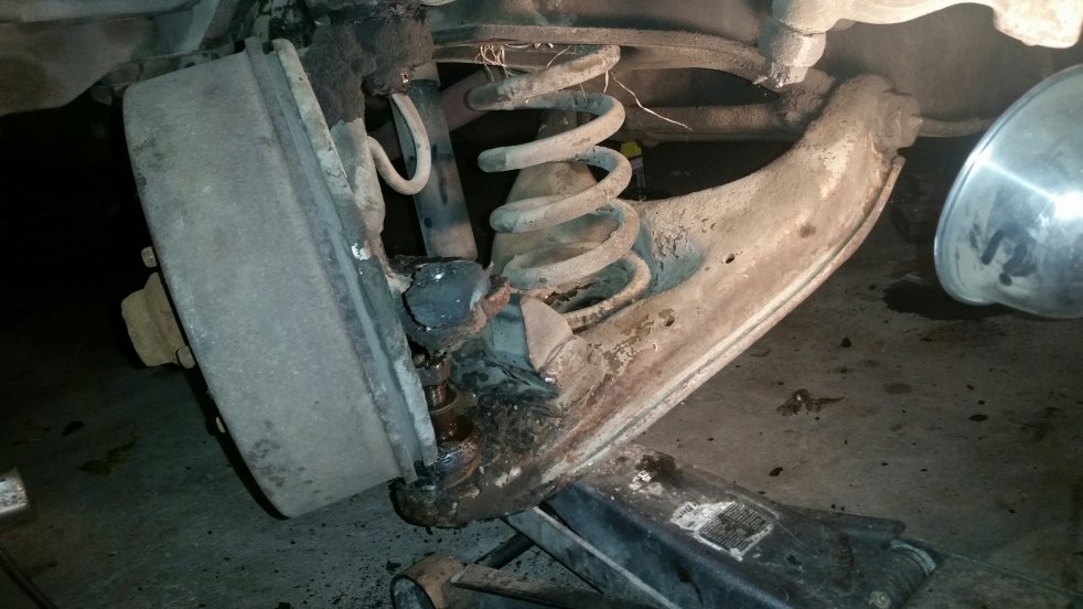

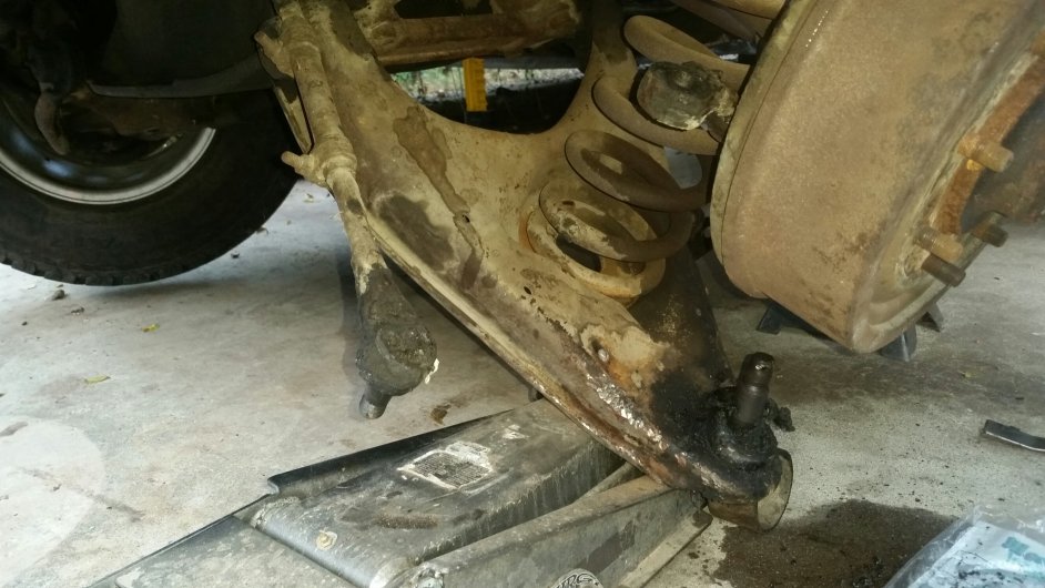

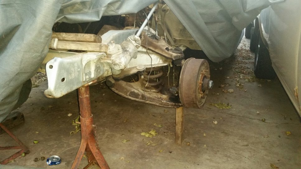

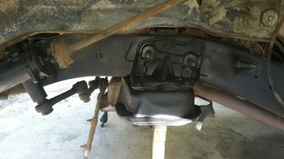

Last night after some prayer the both lower ball joints popped loose. The passenger side I didn't get done until around 8pm, so it's still on the frame. I will switch it over to the parts truck tonight. Then I can put the tires back on it and lower it back to the ground. Sprayed the frame of the '65 with some purple degreaser this morning and will do the same at lunch. Tonight I can commence to cleaning off the gunk. Luckily the PO cleaned it up pretty well when he had it, so there isn't mounds of dried old oil and grease on the cross member. There is under the upper control arms, but that area is difficult to clean when the suspension is on the frame.
For some reason the left side won't compress enough on the parts truck for me to get the castle nut on the ball joint. Need more weight. Thought the engine would be heavy enough but I was wrong.

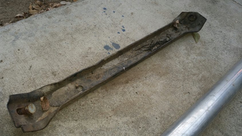

On Sunday while getting going, I looked over and saw a bumper brace laying on the ground and saw it is the one I altered on Mean Green when I put power steering on that truck. Since I have the front bumper off, I will swap out that brace and be one step closer to power steering. Notice one of the ears is cut off. That is all that is needed for the power steering gear to clear the bumper brace. If my bracketry for the pump will work with my current setup, I will be golden. If not I will need to find a different configuration for the pump, or find a different pump altogether.

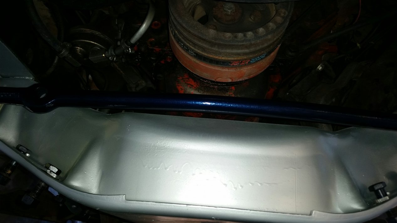

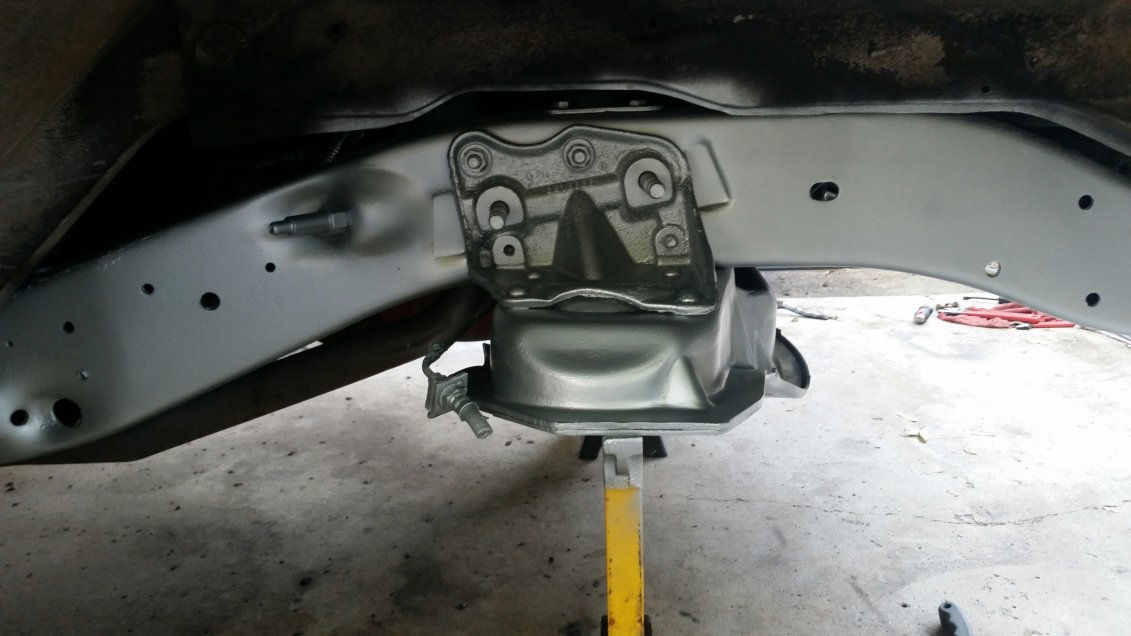

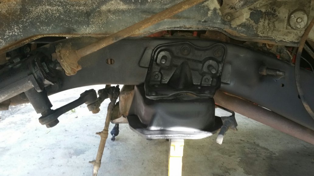

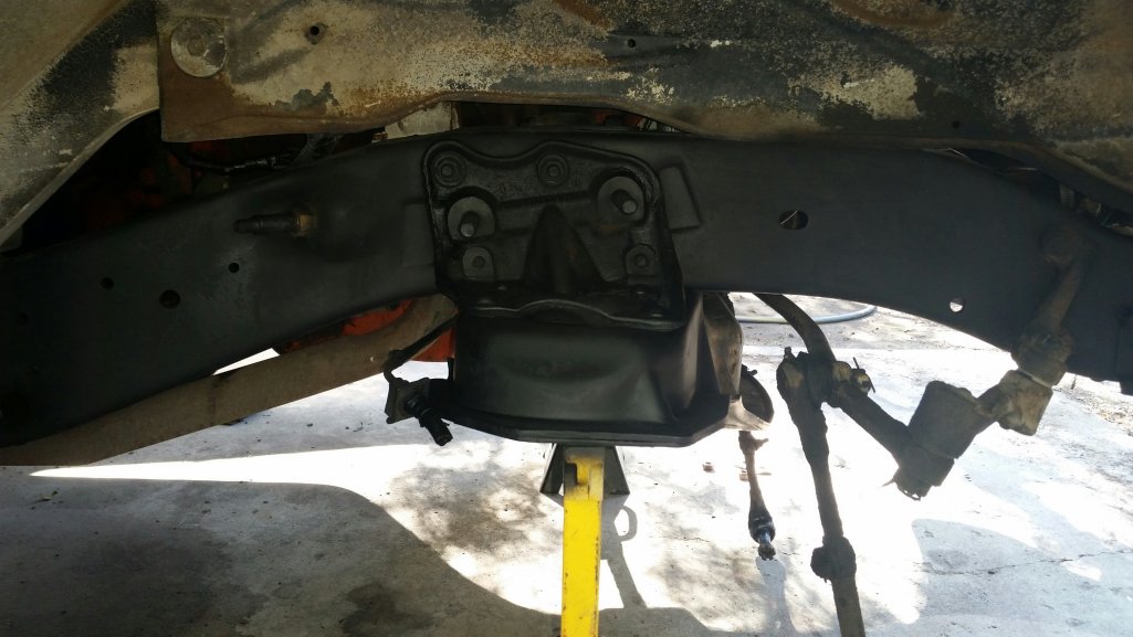

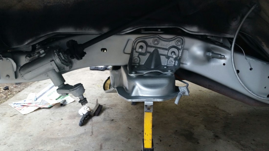

Got the front of the frame cleaned and painted over the weekend. Now the suspension can go on. The photos show the first pass with reust reformer, and then the silver. My phone was almost dead when I took pics of the silver, so it wouldn't allow the flash. It looks a lot better. Before coming to work I snapped a shot of the center link against the cross member to see what the new color scheme looks like. I like it! Don't mind the runs on the front of the cross member. That was a mistake and is the only spot that ran. I don't care though, it's covered with paint and the rust has been removed and converted. On my phone the new color scheme photo is much brighter, don't know what happened to make it go darker, but you can still see it.

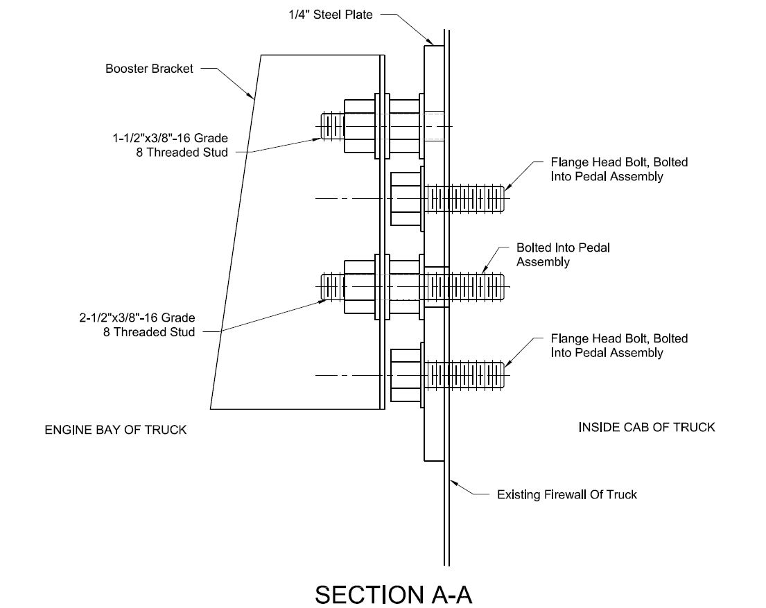

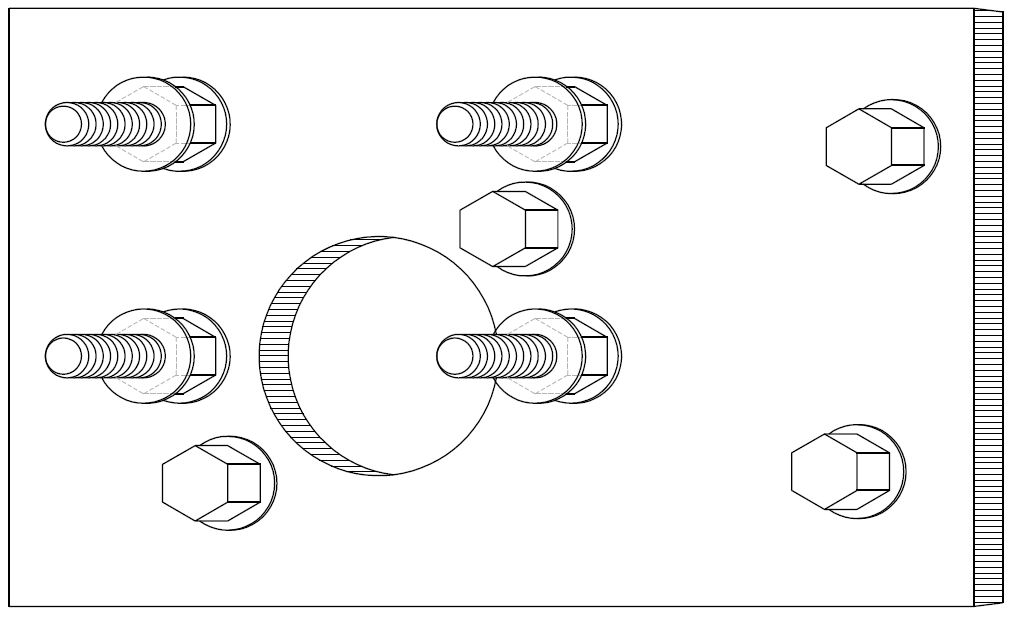

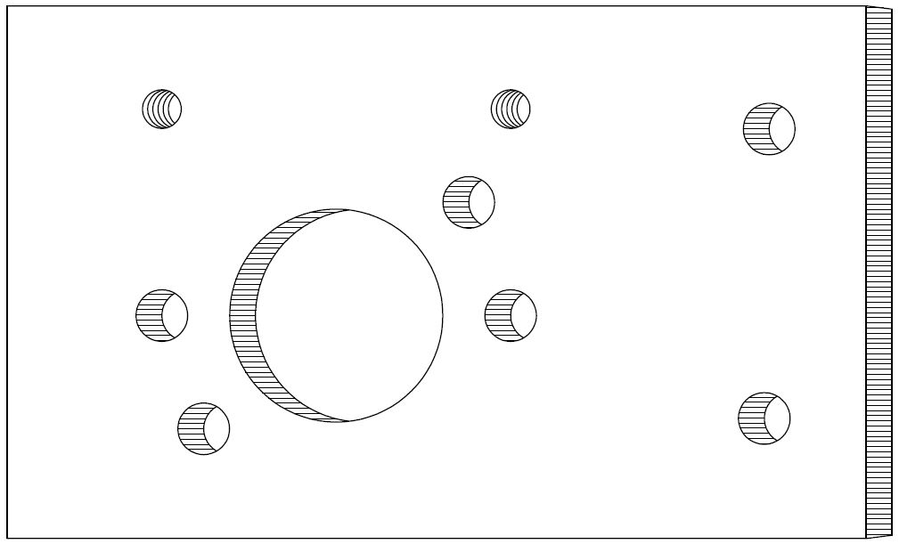

I've had the front end done for two weeks now. The booster/master cylinder kit I bought years ago won't bolt up. Called Master Power Brake and they said they don't have anything that fits a 3/4 ton truck, only 1/2 tons. I asked about having them make a bracket, and they said they don't sell brackets, just full kits. I don't need another kit you a**holes, I need to be able to bolt the kit I have to the firewall. When I bought the kit from REZ engineering they said it was a direct bolt up. With that snag, and going on a cold camping trip, the project got put on hold. Before I went on vacation I got an idea that seemed to be a viable option. I had a 1/4" steel plate fabricated so I can finish the conversion. No pictures of that yet, but it will allow the bracket to clear two of the bolts that are in the way. This is where the truck is right now. Was going to post up the pics of the truck but my email won't come through, so all I have is Snipping Tool Images of the drawings of the plate I had fabricated.

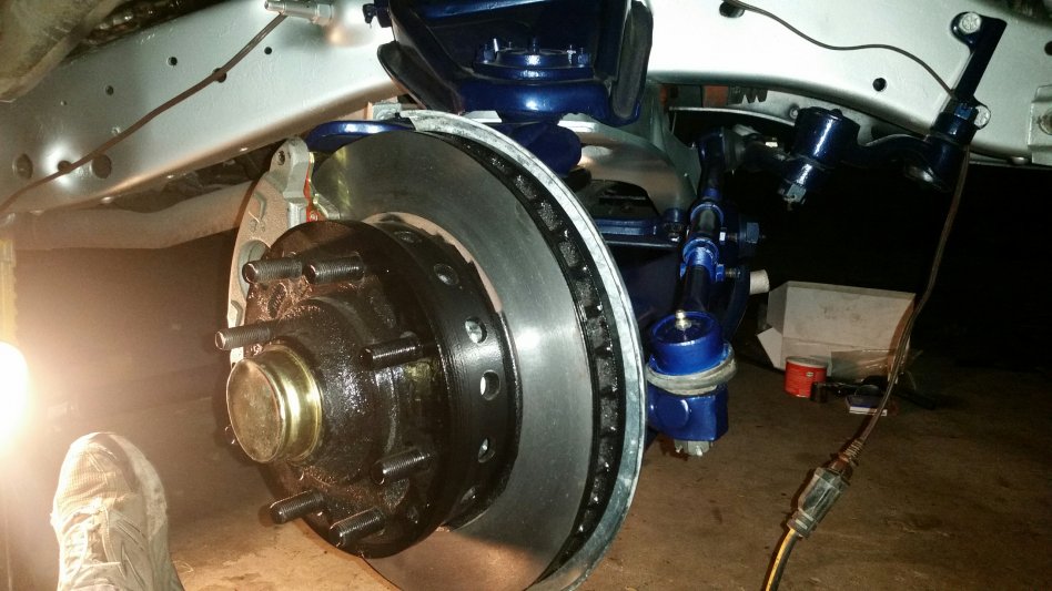

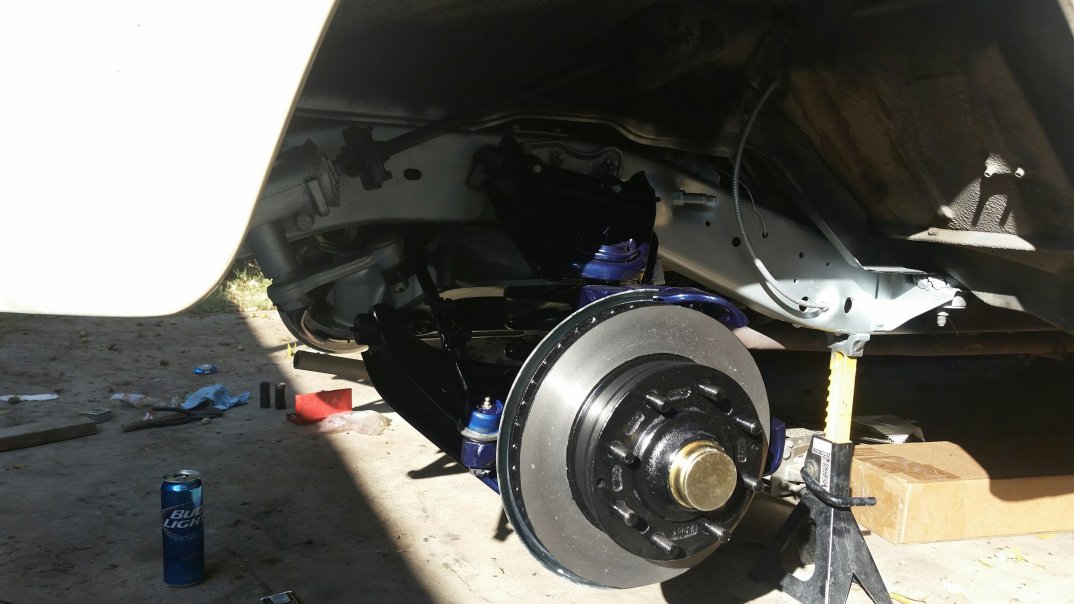

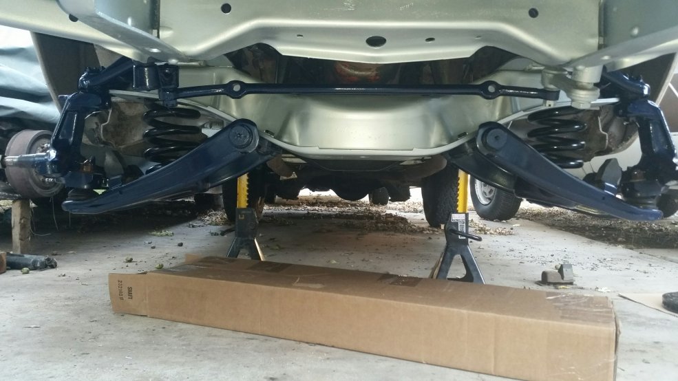

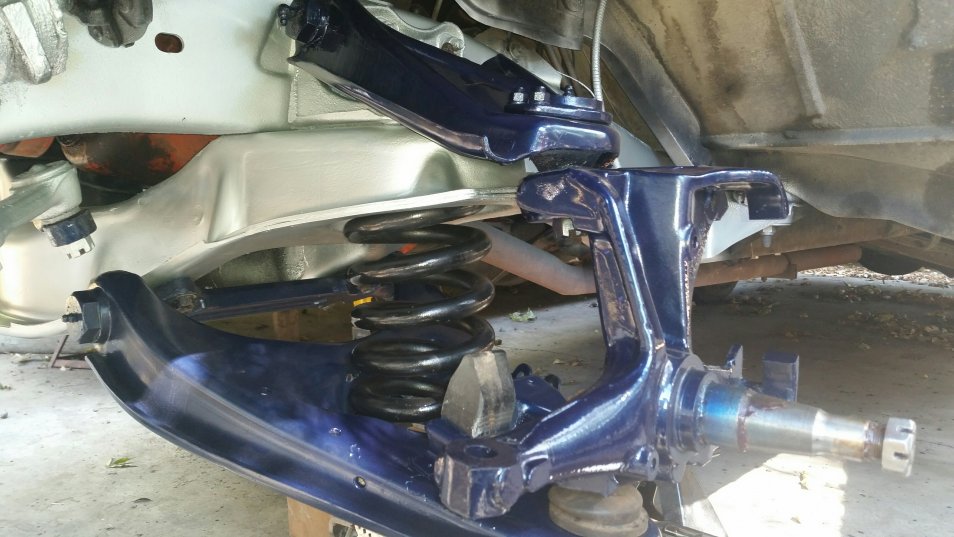

Email with the photos finally came through, so here goes. At least the truck is sitting on fours now and not with the front end cantilevered over jack stands. I hate working on vehicles like that but it has to be done sometimes. Spent 10 hours getting the front end done on November 4th. That was a crazy week, worked 12.5 hours on the 3rd, and then came in on the 4th thru 6th at 4am to 8am and then went home to work on the truck. Was wanting to take it camping, but with the booster bracket snag, the truck got to stay home to think about what it's done. Can't wait to drive it again. I hope I don't go through the windshield the first time I hit the brakes :rofl:

Damn, that's nice and clean looking. Front disk brake conversion and booster issue resolved, it'll stop just like a new model truck does but without the complicated Anti Lock brake system. I like it !!!

Thanks, it is a huge improvement over what it was. I'm off to get a rear brake hose from Napa, and then it's time to finish this project so I can get it to the shop for a front end alignment.
